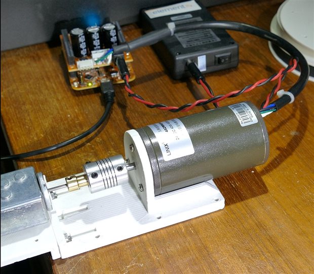

The drive train from motor to sprocket is finally approaching a viable solution. This installment adds a flex coupler to allow some eccenctricity between shafts and minimize any resulting vibration.
It is getting closer to a full drive train for this motor. The next phases will involve building the pulley, mounting it to the steering column, mounting the motor/greabox to the Clear Walk frame and connecting  the two with a drive belt.

    If your flexible coupling had had 5 mm bore (before modification), you could have used 5 mm to 2 mm bore adaptor, like 251.11 from Huco ( http://www.farnell.com/datasheets/106406.pdf ) to grab the gearbox…

    Nice update Douglas. Have you considered heat shrink tubing to couple the different drive sizes? It might be simpler than the flex coupler, but I am not sure that it would last in a cold environment. …

    Looks pretty good. Definately needs the flexible coupler looking at the wobble on the sahaft att he worm gear end.

    If your flexible coupling had had 5 mm bore (before modification), you could have used 5 mm to 2 mm bore adaptor, like 251.11 from Huco (http://www.farnell.com/datasheets/106406.pdf) to grab the gearbox shaft. This way the rigid brass coupler and drilling in flexible coupling would be eliminated. Farnell used to carry them, but current offer is rather limited: Bore Adaptors | Farnell element14
