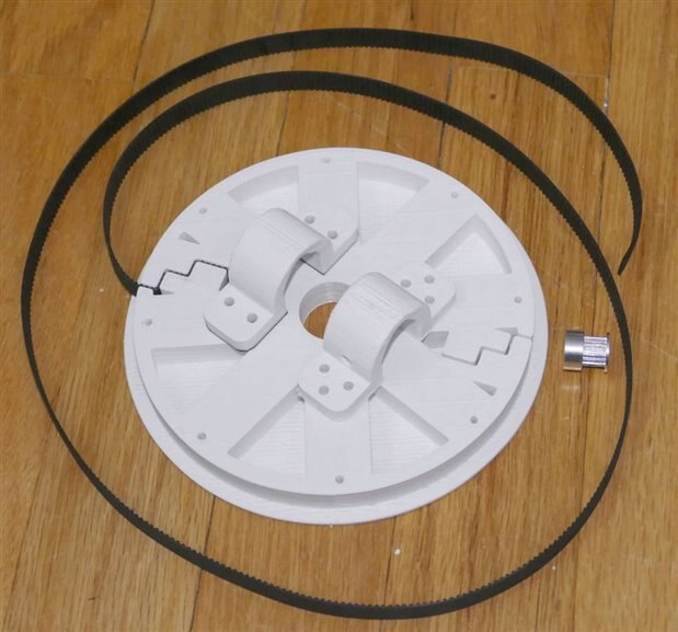

This image shows part of the pulley - I expect to use a separate take-up reel. The 2 clamps will be used to mount the reels to what is left of the handlebars described in earlier blogs. You can see the convoluted threading path for the belt internal to the reel. This is a very tight fit and does a good job preventing the belt from slipping. The aluminum drive sprocket is also shown in the picture just to get an idea of the gear ratio.image
The project is proceeding too slowly despite putting a lot of hours into it, however I am learning a lot about what not to do. Some things like the pulley look like they will work on the first try while others such as the shaft coupler look like they will take many iterations. The drivetrain chassis is definitely going to be difficult.
