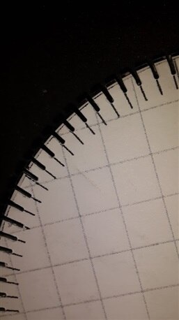

This all started when I from this gear I have no idea where It comes from and I have no other gears that mate with it so I am stumped.
but any way it fits perfectly on the shaft of the motor, so I wanted to use it for that reason alone so I decided to try make a mating gear for it. Though it turned out more like a mildly lethal weapon for a junk yard transformer.
CD with templatecut some guidesgear before cleaning
CD's have extremely accurately geometry, are fairly ridged and are able to turn at impressive speeds. this one was really just a proof of concept had it worked I would have glued a coupe together for more rigidity. but it was not a wild success, there go my dreams of a nobel recycling prize.
I made the tooth template from https://www.woodgears.ca/gear_cutting/template.html for any one who is interested.
Really what failed this particular CD where the lack of accuracy of the gear teeth, and the stability of the axial it was on. At 4000 rpm one of the CD's teeth came off and dreams where shattered. The gear only offered 1:5 ratio anyway so It was not a silver bullet.
