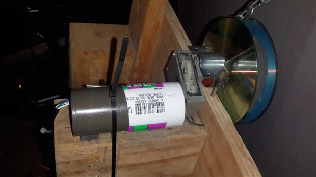

I have made some progress and the end is in sight though I am not sure if I will finish in time, but we shall see.
I have hacked and chopped and glued an old gearbox together, I found that the output shaft ran at nice speed with the first gear set I used but I was running the motor at 500 RPM, but it just didn't have the power at this speed so I re configured the gears and now I can run the motor at full tilt.
here is my first attempt at turning it on.
Next I added the rails to keep the buckets orderly, though they do get a bit shaken up as they go over the top roller cutting down the flanges of the roller should minimize this, also adding a swivel to hold the bucket to the chain was necessary. As I expected I had to reinforce the rollers as the CD's came off the bearing when I put a heavier load on the chain.

    grahamwebberjhb over 10 years ago in reply to DAB
    Thanks DAB I was originally planning to spring load one of the rollers  to add some tension but it seemed to get tricky, I will try put some foam around the driving roller the compression of the foam may help smooth things.
    I have also changed the gear ratio so I can drive it slower, I will try ramp up the speed, at the beginning and drive it slower during operation.
    If it still wobbles I will have to add a tensioner, maybe a RC car shock absorber or something like that to reduce vibration.
    DAB over 10 years ago
    You might want to add a tensioning device to take the slack out of the chain.
    You are getting a lot of movement and oscillation during start up and run time.
    Adding some tension will smooth out the chain movement.
