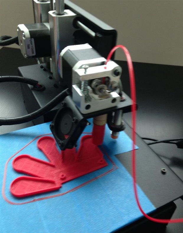

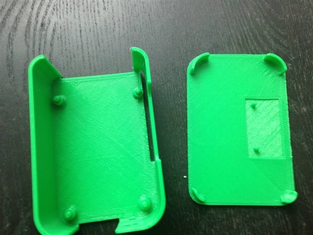

#1  3D print the STL's attached
The parts for 3D printing were designed in 123D design, and you should see 3 STL files in the zip attached below(Fingers.stl,BeagleboneBottom.stl and Beaglebone Top.stl)
Here are some suggested setting to 3D print the parts
  • Layer height - 0.2mm
  • Infill - rectilinear
  • Infill density - 25 %
  • Nozzle temperature if you are using the same Filament - 205 C
Note: for the BeagleboneBottom.stl, you will have to add supports as part of your slicer settings

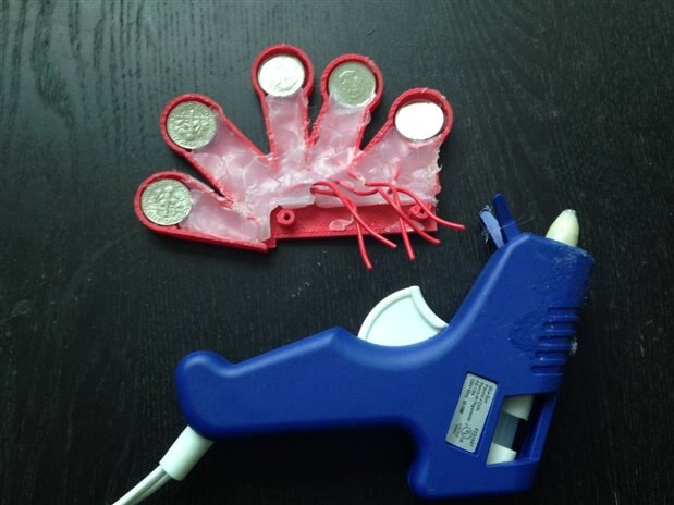

#2 Using Hot glue to add the coins and Breadboarding wire
Here is where you will need a friend to help you out, collect a couple of 10 cents if you like in Canada or based on where you live you will need a coins with a diameter of 18mm.
Add the wires below the coins and using a multimeter run a quick continuity test for all the 5 coins to the tip of the wires.

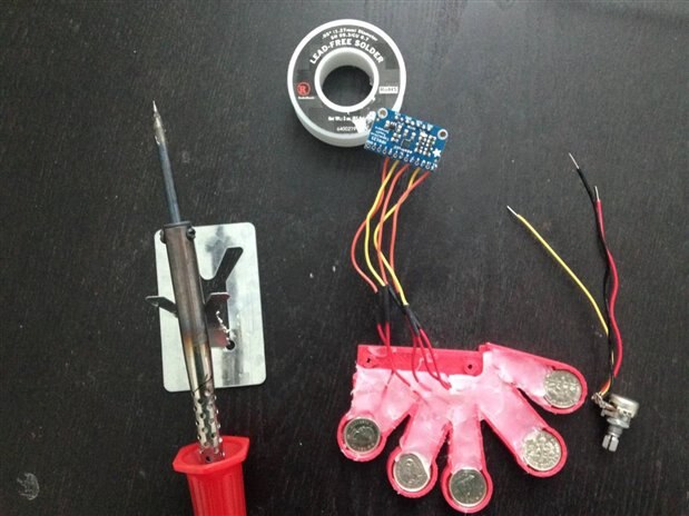

#3 Soldering components -  Capacitive touch breakout  and the POT
Now solder some breadboarding wire to the POT
And also solder the ends of the wires from the hand to the MPR121, in my case i have solder another set of wire from the MPR121 to the hand, as I plan on using the breakout board on another version of this project.

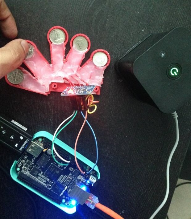

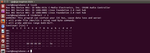

#4 Checking if the Capacitive touch Breakout  and Sound card are detected by the BeagleBone
Connect the USB sound card to the beaglebone
And connect the MPR121 breakout to the expansion headers on the beaglebone, that is
  • Connect the VCC of the key pad to 3.3V , pin#3 on the P9 header
  • GND to GND to pin#3 on P9
  • SCL on the key pad to pin#19 on P9 header
  • and SDA to pin#20
Now connect the Beaglebone to your computer and use the cloud 9 IDE to run the commands below, or use a LAN cable to ssh into the beaglebone to run the following commands
root@beaglebone:~# lsusb
you should see your audio card  detected as C-Media Electronics,Inc. CM108 Audio Controller
root@beaglebone:~# i2cdetect -r 1
here you should see the MPR121 detected as 5a , as shown in the screen shot below.

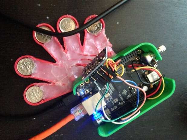

#5 Connecting the Pot to the Beaglebone
Connect the potentiometer to the beaglebone at
  • Connect +ve to 1.8V , that is pin #32 VDD_ADC on P9 header
  • Connect GND to GNDA_ADC , that is pin #34 on P9 header
  • Connect the middle pin of the POT to analog pin #33 on P9 header

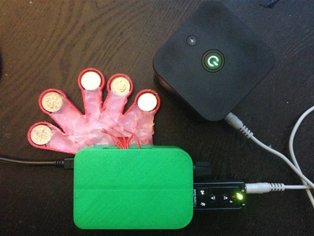

#7 Connect 3D printed Lid to the Top
One you have tested the code add  MPR121 breakout the top 3D printed as shown in the picture, the top should snap fit with the base, but add some hot glue if required.
