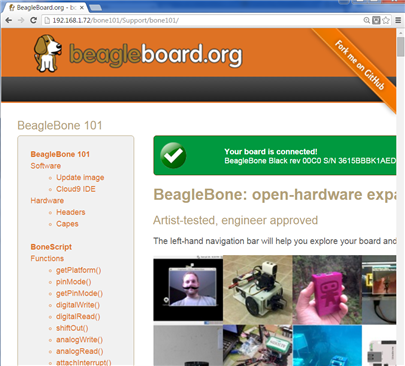

I plug the BBB via USB into a host machine and run the browser to the default USB Ethernet IP address for the BBB:  http://192.168.7.2/.  It works and brings up this page:

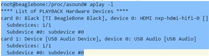

Adding an USB audio device -- During installation by plugging in the USB audio device into the running BBB system, there is a problem.  Using the command 'dmesg' does not show a connect / disconnect of USB peripherals from the USB Host port.  I read a blog post, and it suggests that by default BBB does not support USB hot plug, but it will recognize a USB peripheral on initial startup. So I use the command: shutdown -h now
After a reboot I now find my USB audio device:

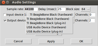

I select "preferences > audio settings" in order to make sure the correct audio device is selected as shown here:
I uncheck input device as my instrument will not be needing this and to simplify the test.  I then select the 'USB Audio Device (hardware)' in the output device pulldown as shown above and click Apply.

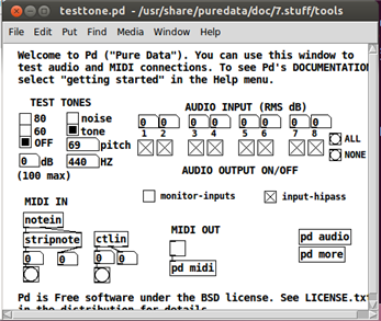

Time to test audio in Pd by with the 'Media > Test Audio and MIDI…'
Which opens up:
Under the TEST TONES sections and the first column ( 80 or 60 or OFF) buttons, I select 60 to make sure the sound is not too loud.  If you here a 440 Hz tone, your sound is working.
Day one complete with Pure Data with Alsa and USB audio device functional.
