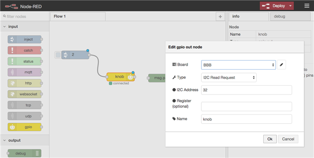

Then I can set up the board in node-red and add a node to read from i2c within a flow:
The payload from the node coming in to the i2c node needs to be the number of bytes to read (i.e. 2 for this example), and the address in the config needs to be the hex address for the module, converted to decimal (in this case 0x20 converts to 32 in decimal).
