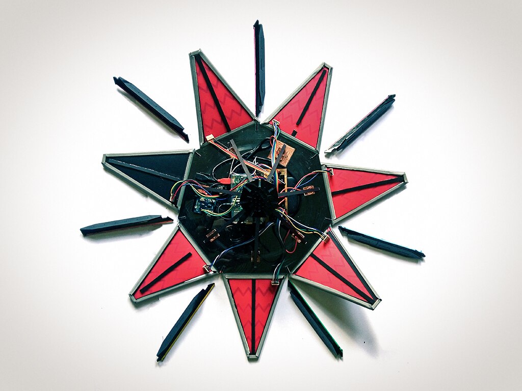

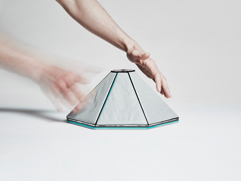

Kazumi
Kazumi is an accessible instrument for aspiring musicians and makers. It is self-contained and is designed as an open-source DIY kit so that users can adapt it easily. Each of the seven surfaces is a touch-pad that either triggers or modulates sounds, which are tuned differently depending on how the structure is rotated on its base. Playing music on Kazumi is a tactile, sensual experience, hands exploring and caressing to draw different notes from the integrated speaker. Experimental and immediately accessible, Kazumi is something to play, and therein lies its wonderful attraction, drawing those into music-making those who might feel alienated by more traditional instruments.
Hardware
Kazumi v1 is made up of the following:
Off-the-shelf:
1x Raspberry Pi 2 Model B
4x MPR121 Capacitive Sensing Breakout Boards
1x Raspberry Pi Soft-Shutdown Breakout Board
1x 6000mAh Power Bank
1x 2.5W Portable Speaker
10x 10mmx3mm Neodymium Magnets
Custom-made:
1x Structure:
- Foam base (laser cut)
- ABS base (laser cut)
- 7 Acrylic legs (laser cut)
- 7 Pad rests (laser cut acrylic + magnetic tape)
- ABS top (laser cut)
7x Touch Pads:
- Polypropylene tray (laser cut) + magnetic tape
- 5 Copper Adhesive Electrodes (cut on a vinyl cutter)
- Foam insert (laser cut)
- Reflective PVC cover (cut on vinyl cutter) + magnetic tape

    DAB over 10 years ago
    Very cool device.
    I can see a lot of ways to combine the sense data to make music and sounds.
