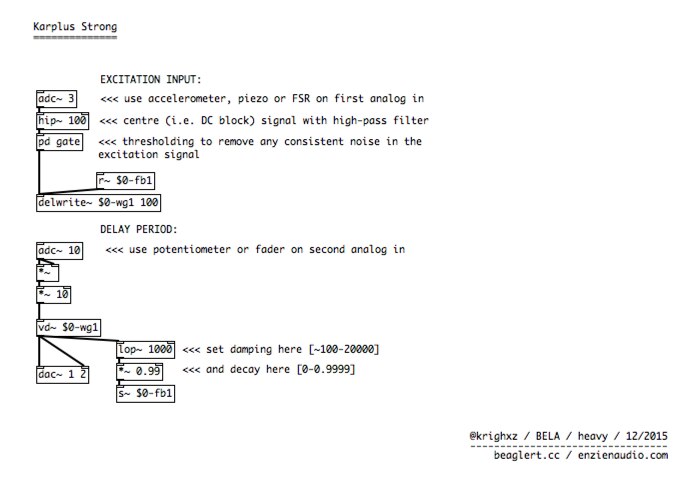

One of the PD on Bela examples is a Karplus Strong patch (by Christian Heinrichs) which allows you to use either an accelerometer, a piezo transducer or a force sensitive resistor as the input to generate a string sound. You can see the main patch window below:

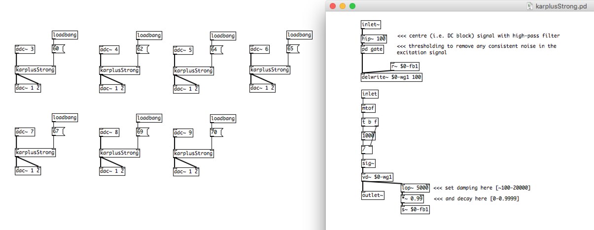

I particularly liked this for its simplicity and responsiveness and so decided to replicate it with 7 piezo transducers, each with a fixed tuning. This is how it looked on software and hardware:
Once this was tested, I went on to mount the piezos on the 7 pads of Kazumi. I removed the Raspberry Pi and the MPR121s and replaced them with the BeagleBone Black, the Bela platform and the breadboard with the piezo circuits (the positive lead from each piezo out to the analog input in between a 220k resistor going to ground and a 330k resistor going to 3.3V).
As you can see in the video below, this was straightaway very responsive and engaging as a musical instrument. The panel agreed and awarded me with one of the prizes (a BeagleBone Black with a Bela platform), yay! image
