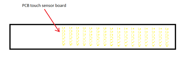

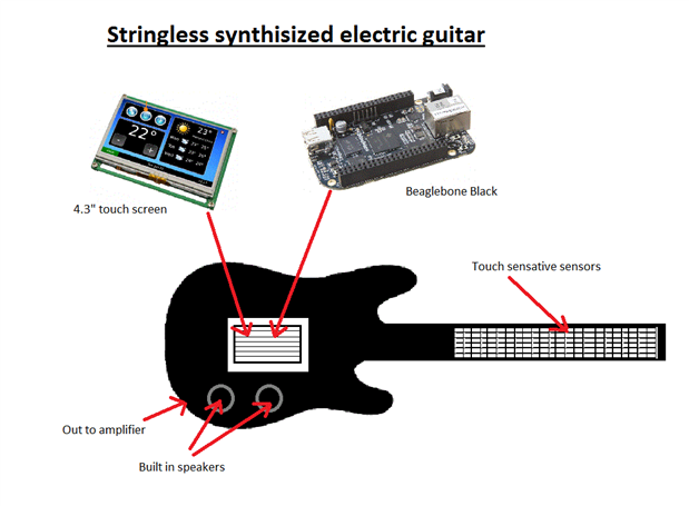

The Beaglebone Black from Texas Instruments will be the life of the guitar. I will have a 4.3" touch screen that will be used as the user setup and the virtual strings. Touch sensors will be used on the neck of the guitar to let the BBB know where your fingers are located. When you touch the sensors, like you would on an actual stringed guitar, it will change the tone when the virtual strings are strummed. Speakers will be used to produce the sound (or music if your good) as well the BBB will be user controlled to change the sound produced.
The guitar will be built by myself (I custom make guitars) and have all the electronics hand fitted into the body and neck. Attached is a layout plan of how this will come together.
Below are pictures of our idea as well as pictures of work in progress:

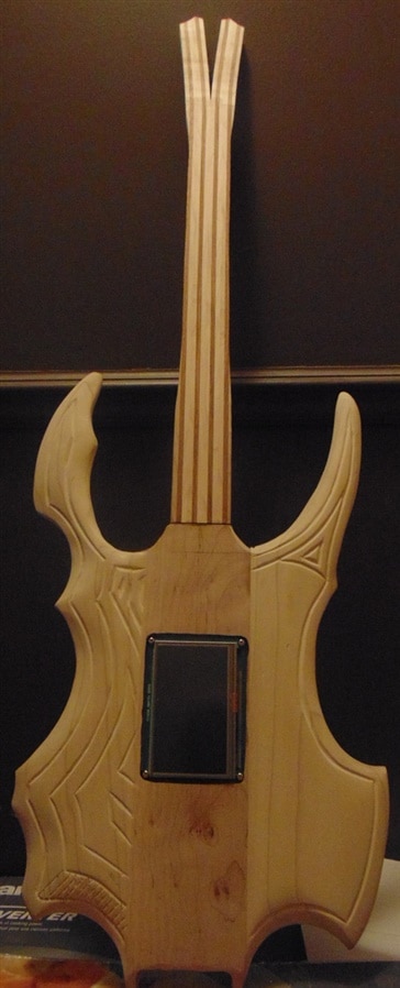

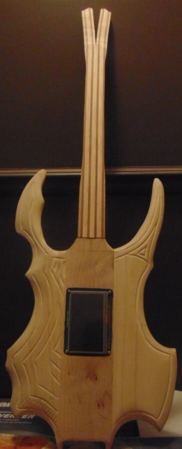

Here is a picture of the guitar I made with the LED screen inlaid into the body. I hand made and carved the guitar myself. The neck is made up of layers of solid Maple and Jatoba, the V at the top is made by bending the layers.

    shabaz over 10 years ago +2
    Wow, looking forward to following this project.. Also, nice styling - wood and electronics can go very well together, but this looks exceptional : )
    mcb1 over 10 years ago +2
    Looks like a work of art without the electronics ...
    balearicdynamics over 10 years ago +2
    Hi, I liked very much the wooden case as I saw it the first time you published an image Just a question the touch screen, that is in the position where usually guitarists will play with the right hand…

    DAB over 10 years ago in reply to dwinhold
    You could use LED/Detectors if you set up the strings to break the light path.
    You might want to consider light detectors.  You could set up a light source to project on the detectors and then pick up your finger positions using the drop in light amplitude.  It might take a lot of fiddling though.
    Have you considered capacitive touch?
    balearicdynamics over 10 years ago in reply to dwinhold
    Hi Dale!
    Thank you for the detail. My worry as guitarist is about the risk of the use of the touch intensively when playing ...
