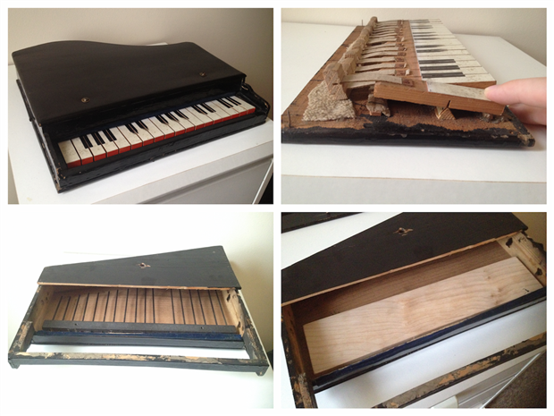

For the MIDI toy piano hack I used piezo sensors to detect when and how hard keys were being pressed, however this implementation proved to be fairly unreliable (piezos didn’t always get struck, multiple piezos would trigger on single key presses, key velocity didn’t always create a matching velocity value). However a new implementation I want to start working on involves turning each key into a simple pair of on/off switches. It would work as follows:
  1. When a key is initially pressed it opens a circuit, triggering a timer to start.
  2. When the key is fully pressed it closes a second circuit, triggering the timer to stop. The value of the timer is used to work out a velocity value, with the specific key number creating a note number. These values are sent to the synthesis engine.
  3. When the key is fully released it closes the first circuit again, triggering a note off message to the synthesis engine.
The key mechanism will require 2 digital inputs on a microcontroller for each key for translating the key presses and releases into digital messages. The keys will either be connected directly to the BBB, or to a second microcontroller (such as an Arduino) used just for scanning the state of keys with the messages being sent to the BBB over serial or SPI, depending on the whether the BBB can handle processing a synthesis engine and key scanning at the same time.

Here is a set of images of the toy piano I will be working with, showing its design, its keyboard mechanism, as well as the original sounds rods that have since been removed:
