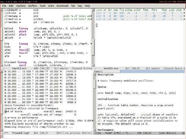

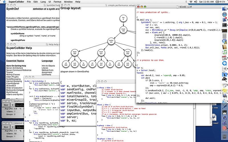

The sound engine will run on a Linux based OS and likely be programmed using one of the following applications:
Csound: https://en.wikipedia.org/wiki/Csound
PureData: https://en.wikipedia.org/wiki/Pure_Data
SuperCollider: https://en.wikipedia.org/wiki/SuperCollider
We will need to first create a fully realized synthesizer, then determine which parameters will allow for external control. Our synthesizer will use a subtractive signal flow and include modules such as:
