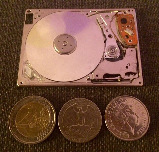

In addition to the BBB, for the first iteration I will probably just use one of the many USB audio interfaces I have around here - I had considered building some DAC circuitry but to get the best image quality from the laser projector, I need to use the highest sample-rate I can manage. The USB audio interface will be replaced by the BeagleRT cape for the final version if all goes to plan. Once I've got as far as producing line-level stereo audio out (a stereo signal is required to create lissajous music, as the left & right channels map to the X & Y axes of the scope/scanner), I will need to build an amp, probably just a basic LM387 circuit like I would normally make to drive a small pair of speakers - but this time, rather than connecting the output of the amp to the coils of speakers, it'll be connected to the coils of the read/write heads of two tiny HDDs out of some old iPods. The picture below gives you an idea of the scale - the coins below the drive are a 2€, a US quarter, and a British 10 pence piece.
The drive platter itself will be removed, and the enclosure cut down to as small as possible, and then a tiny piece of mirror will be mounted axially above the pivot point of the HDD arm, as such that the signal coming out of the amplifier will control the movement of the mirror in much the same way as it would control a speaker - although producing a rotary rather than linear motion. By producing two copies of this assembly and mounting them at 90-degree angles from eachother, so that the laser beam bounces off the first mirror and onto the second, it should produce an effect remarkably similar to that of a commercial laser projector - the insides of which would contain a pair of galvanometers (sometimes referred to as a "galvo" by Laser nerds) such as the pair you can see below.

    I built one in 2007 for the Austin TX makerfare that projected specific patterns from MIDI note values, used a PIC and a DAC with a couple of galvos and a green laser (60mw).  It was a fun project, but I found that the galvos were a bit slow and the size of the mirrors is a critical component due to inertia.  There are some inexpensive galvos available now that go into the khz. $80 for the whole system on ebay:

    Unlike a speaker, which is biased to the centre position and where your ac to the coil drives the cone forward and backwards in a balanced way, won't the disk drive voice coil be biased to the rest position, with the head away from the platter, for safety?
    If so, you'll need to bias it [electrically bias, I mean, I assume you won't want to do too much re-engineering of the mechanism] to the centre postion in order to use your audio amplifier. I'm sure that could be made to work ok, but an alternative you might want to consider would be to keep it unidirectional and have your audio signal control a current source driving the coil.
