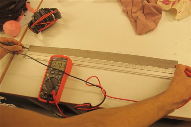

Since I last wrote I have been thinking a bit about the implementation, and I've come to the conclusion that the easiest way to go about this is to use a USB-MIDI interface. To achieve this, I decided to go with a Teensy rather than a microprocessor dedicated to wearables. I came to this conclusion because I need at least 8 analog inputs according to my first sketch on where to place the stretch sensors. The Flora, which I was planning to use, only has six analog inputs, and thus I chose to go with a Teensy. Teensy has built in MIDI-HID support so it's very very simple and intuitive to create a USB MIDI device with it!
I also found out that conductive thread might not be ideal to get consistent data (thanks, Charles!), so I've been conceptualizing about how to intergrate cables into the design of the suit. I think it will turn out really cool, and it feels very connected to the theme of the artwork, so I'm excited about this!
So, for this stretch sensor I have used a piezoresistive fabric (Thank you SO much, Emma, for making this possible!!!), which changes resistance depending on how stretched out it is. It is basically a stretch sensor in itself, so all we had to do was cut a piece up and hook it to the Teensy, and after some programming and tweaking the program, we got it working pretty decently! We hooked it up to my DAW and tested it out and it worked! It was great fun playing around with, and I can't wait to put it on a suit and try it out for real!
