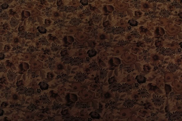

     Flowery fabric!
This fabric has no stretch whatsoever, but I found that the flowers would represent the natural aspect of the constellation quite well! I was thinking some kind of patch on the suit might be nice, or something of the sort. I am not sure whether it will stop the movement flow, but it would be nice to have something which represents Nature on the suit!
