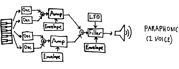

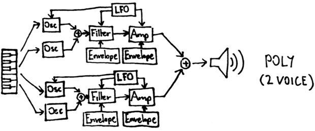

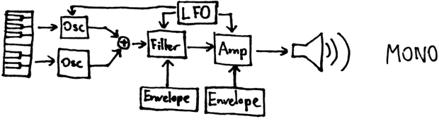

Number of Voices
Other than synthesis type and essentially components, another main thing to consider in audio synthesis design is how many notes the synthesis engine can play simultaneously. There are most commonly two possible ‘modes’ here - polyphonic (multiple notes) or monophonic (a single note).
In a polyphonic system you then need to consider the number of voices, also called the polyphony value. A greater polyphony value allows bigger chords and textures to be played, however it increases the needed processing power. There are also different levels of polyphony - in a true polyphonic synthesis each voice/note will have it’s own oscillators, filter, envelopes, and LFOs; however some polyphonic systems are simplified so that, while multiple notes can be played simultaneously, every voice shares a single element such as a filter and/or LFO, which is more commonly known as a paraphonic synth. Polyphonic synthesisers usually have an option to put them into monophonic mode if desired.
Example flow charts of of monophonic, polyphonic, and paraphonic audio synthesis engines.
In these examples each voices has two oscillators.

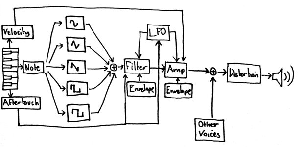

My Current Synthesis Engine Design
I have decided to base my synthesis engine on subtractive synthesis for a couple of reasons:
  1.   It can create a relatively varied set of sounds without being too complex to implement or use

I want it to be true polyphonic synthesiser, so that I can use the poly aftertouch I have implemented into the keyboard as well as implement filter envelopes, both which need to be per note/voice, with a polyphony value of at least 4 voices. Therefore there would be one instance of the oscillators, filter, envelopes, and LFO for each voice; the rest of the components/parameters would be global to the overall/mixed sound.
A flow chart of my synthesis engine design
