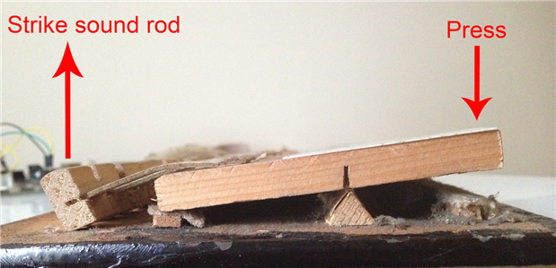

The first part of this project I have decided to undertake is the development of the key mechanism - allowing the existing toy piano keys to generate note messages in the digital domain. I have decided to start with this particular task as, from a technical point of view, it could arguably be the most challenging part of the project, with next to nothing in regard to existing examples of it being done. I've done a lot of trial and error in past projects to find a reliable solution for doing this, however I'm now fairly confident that I'm on a path towards a working implementation.
A cross-section of the existing toy piano key mechanism, annotating the way it was designed to work.

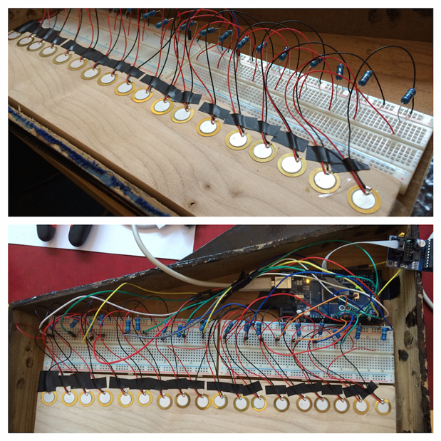

This isn't the first project I've undertaken where I've needed to digitalise a toy piano key mech. Back in May 2015 at the MIDI HACK hackathon in Berlin I turned a vintage toy piano into a simple MIDI controller; the original idea for this synth project. For that particular project I decided to use piezo sensors that would be struck by the keys in order to create MIDI note on and off messages. I decided to use piezos as they're cheap sensors that have been a tried and tested solution among musical instrument projects, allowing great sensitivity as well as a mechanism for generating velocity values.  My intention was to have a row of piezos stuck to the underside of the top of the piano, which would be struck by the keys hammers to generate note-on messages along with a velocity value created by the hardness of the piezo strike, coupled with a second row of piezos underneath the back of the keys for generating note-off messages when the keys were released. However the piezos ended up being pretty unreliable for me due to the handmade construction of the piano - they wouldn't always get struck by the hammers, sometimes hammers would strike or trigger multiple sensors, and the velocity values wouldn't always create consistent results.
The piezo implementation for my existing MIDI toy piano project.
This circuit was stuck to the underside of the top of the piano to allow the keys hammers to strike the piezos.

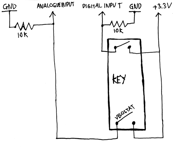

When approaching this synth project I realised a much simpler solution that could be implement - turning each key into a pair of simple switches, making them work in essentially the same way that most velocity-sensitive synth/MIDI keyboards work. This implementation is as follows:
  1. When a key is initially pressed it opens a switch/circuit that starts a timer
  2. When the key is fully pressed it closes a second switch/circuit that stops the timer. The time value is used to generate a velocity value, and a note-on message is sent.
  3. When the key is released it closes the first switch/circuit, generating a note-off message.
This is potentially a better solution than using existing sensors as it is a tried and tested method for electronic musical keyboards. As I need the touch sensitivity to be very sensitive I found I can't use any mechanical push switches/buttons here; even some membrane buttons I tried weren't sensitive enough. The best solution seems to be to just make the keys open and close circuits, acting in the same way that buttons/switches do.
Here's a basic sketch of the circuit for each key:

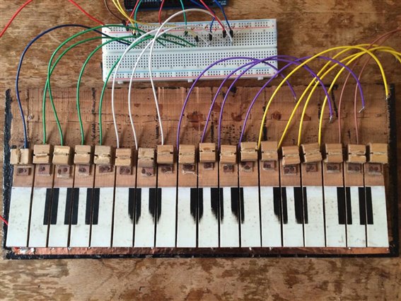

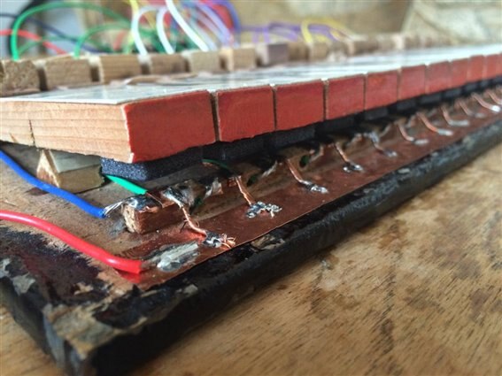

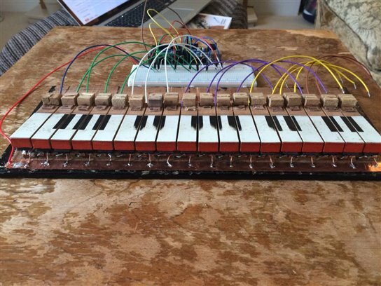

So far I have created the switch/circuit on each key that will generate the note on messages (the switch at the front of the key). To do this I have done the following:
  • drilled some holes below the keys to lay a wire for each key
  • stuck two pieces of copper tape underneath the front of each key to act as the contact points for the switch
  • connected a wire from one side of the contact point to an input on a microcontroller, one for each key
  • attached the second side of the contact point of each key to a single strip of copper tape, acting as the power line

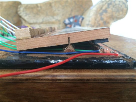

  • attached some foam and Velostat to the underneath of the front of each key that closes the circuit when the key is pressed
Originally I was using copper tape on the underside of each key to close the circuit when a key is pressed, however I found that some keys needed to be heavily pressed for them to work, which was not desirable. To improve on this I went about trying to replicate the way that silicone keypads work, however after attempting get hold of some conductive pills (or the materials needed to make them) I discovered Velostat - a conductive and pressure sensitive flexible material that was recommended as an alternative to conductive silicone or rubber. I'm not 100% sure why (though I'm sure somebody reading this with more electronics knowledge and experience could tell me!), but using Velostat instead of copper tape works so much better, offering greater sensitivity to the keys. An added bonus to using Velostat is its pressure sensitivity, theoretically allowing me to implement polyphonic aftertouch into the piano. A small layer of foam has been inserted between the keys and the Velostat to give the keys a more tactile feel, especially when applying pressure. The foam has also decreased to the distance that the key needs to move in order to trigger a note message, making the keys less clunky and easier to play.
Here is a video of eight of the keys in action, wired up to an Arduino Mega board which is sending MIDI messages to Ableton Live software. There is no velocity or pressure sensitivity implemented yet, however notes of different lengths can be played, and it is fully polyphonic.

  • Improve the key sensitivity - some keys still aren't as sensitive as I'd like, probably because I've soldered the switch contact points directly below the key, meaning the contact area is uneven (a bit of a rookie mistake!). Ideally the contact area needs to be flat, so these solder points need to be moved.
  • Add the circuitry for the back set of switches so that I can implement velocity sensitivity.
  • Connect the front set of Velostat switches to a set of analogue inputs on an Arduino Pro Mini through some multiplexers.
  • Connect the back set of switches to a set of digital inputs on the Arduino through some shift registers.
  • Develop Arduino code for generating velocity-sensitive note messages and pressure messages
  • Sending MIDI messages from the Arduino to the BBB via one if its serial interfaces
