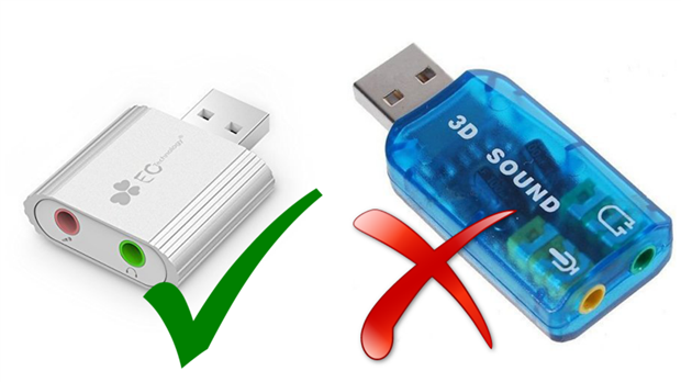

Initially I was planning on building my own DAC for the audio output on my BBB, however after looking into the audio IO options on the board I decided that taking advantage of the USB audio support would be the best option.
I tried out a couple of USB audio adapters to use with my BBB, and finally settled on an EC Technology adapter. At first I bought this budget adapter, however the sound quality was really terrible, whereas the EC Technology one sounds just as good (if not a little better) than the built-in soundcard in my MacBook.
A quick visual review of USB audio adapters I tried out
To set up USB audio as the default sound device on my BBB I used this guide.  ALSA was already installed on my BBB, and contrary to the guide all I had to do was disable HDMI to make USB audio the system default. This was done by adding the following line to my /boot/uEnv.txt file:
optargs=capemgr.disable_partno=BB-BONELT-HDMI,BB-BONELT-HDMIN
After doing that and rebooting my BBB, any audio I played on my BBB was coming out of the USB audio adapter. However if you're attempting to do that same I recommend reading the whole guide incase you need to do the extra steps.

  • clem57
    clem57 over 10 years ago in reply to sarunaszx
    Šarūnas Straigis
    Please add cheap USB cords and cheap wall warts as well!image Robert Peter Oakes knows these can be buggers.
    Clem
  • sarunaszx
    sarunaszx over 10 years ago
    Thanks for the informative post. I will be avoiding these cheap USB audio adapters on my BBB once I receive it. Looking forward to your next post!
