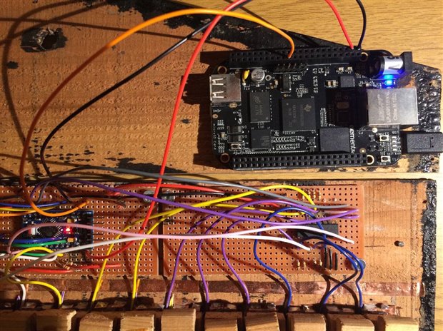

Connecting the Key Mech Arduino via Serial
Apart from the obvious Hello World program, the first application I have developed for the BBB is a simple program that reads serial data coming from the pianos key mech Arduino, displaying read bytes to the console.
The BBB has six on-board serial ports - one that is coupled to the boards serial console, and five UART ports that can be found on the boards expansion headers. By default only the serial console port is enabled, so to use any of the other UARTs you must allow them to be enabled at boot. I did this by following the "Section 1" steps on this tutorial. Note that on my BBB the uEnv.txt file was in the /boot/ directory, not /boot/uboot/ as the tutorial suggests.
Once this had been done, I connected the Arduino Pro Mini to the BBB using the following connections:
  1. Arduino TX pin to BBB P9_26 pin (UART1 RX), for sending serial data from Arduino to BBB
  2. Arduino GND pin to BBB P9_01 pin (a DGND pin), for allowing the Arduino to be powered by the BBB
  3. Arduino RAW pin to BBB P9_03 pin (a VDD_3V3 pin), for powering the Arduino using the BBB
The key mechanisms Arduino Pro Mini connected to the BeagleBone Black via the UART1 port
Lastly I developed a small piece of code that opens the UART1 device file (/dev/ttyO0) and displays any byte it reads from it. You can see this code on my projects GitHub repo here, as well as below:
