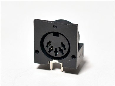

The original and most common hardware transport option for MIDI I/O is using a pair of five-pin DIN connectors, and I have planned on using this hardware transport option from the outset of this project because of the following reasons:
  1. They are the most common MIDI connectors found in commercial synthesisers
  2. They can quite simply be connected to one of the UARTs on the BeagleBone Black
  3. I've used MIDI-DIN connectors in past projects
A standard MIDI-DIN connector (left) and a pair of standard MIDI-DIN cables (right)

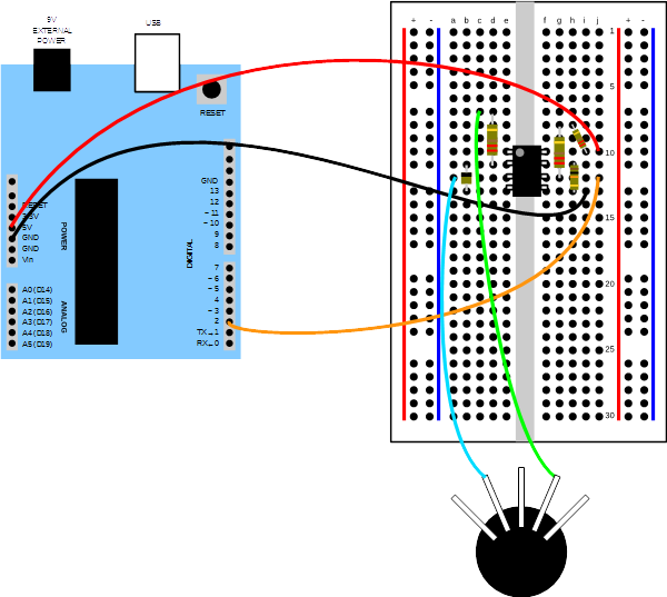

MIDI-In
The guide I used for building the MIDI-in circuit was the Libre Music Production Arduino and MIDI in guide, which is fully transferable for the BBB.
The main components needed for the circuit are:
  • 1 x female MIDI DIN connector
  • 3 x 220 Ohm resistor
  • 1 x 1N4148 diode
  • 1 x 10kOhm resistor
  • 1 x 6N138 optocoupler
As explained in the guide, an optocoupler is very important here as it allows the two electronic circuits (the BBB and the connected MIDI gear) to be electronically isolated from each other, which prevents the occurrence of ground loops and protects equipment from voltage spikes. Here is a breadboard diagram of the circuit from the guide that I used:
A couple of corrections and things to mention about this diagram:
  1. The anode of the diode should actually be connected to pin 3 of the optocoupler, not pin 4
  2. The viewport of the MIDI connector is from the back
  3. Obviously in my project this circuit is being attached to a BBB instead of an Arduino. I mention how this circuit is specifically connected to the BBB below.

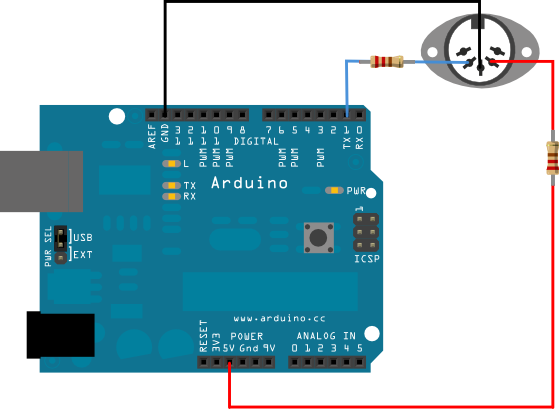

MIDI-Out
The guide I used for building the MIDI-out circuit was the official Arduino MIDI guide, which again is fully transferable for the BBB.
The MIDI-out circuit is a lot simpler than the MIDI-in circuit, and it only requires the following components:
  • 2 x 220 ohm resistors
Here is a diagram of the circuit from the guide that I used:
A couple of things to mention about this diagram:
  1. The viewport of the MIDI connector is from the front
  2. Again, in my project this circuit is being attached to a BBB instead of an Arduino.

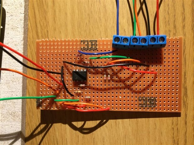

The Combined Circuit
Here is a photo of the above two circuits combined onto a single piece of strip board for my project:
In the above photo, the wires at the top are going to the two MIDI-DIN connectors, and the wires on the left are going to the BBB.
Combining the two circuits into a single one has allowed me share the power and ground lines between the two, meaning I only need to use a single pair of wires from the BBB for power and ground.
You'll also notice that I've used a set of screw terminals for connecting the MIDI-DIN connectors to the circuit. I've done this so that, once everything is attached to the toy piano enclosure, I can remove this particular circuit from the piano if needed without having to remove the connectors too, or vice-versa.

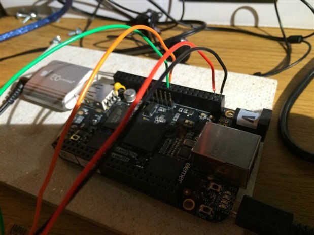

Connecting to the BeagleBone Black
As mentioned above MIDI is a serial communication method, meaning that the above circuit can be simply attached to the BBB via a pair of UART pins. I'll be using UART2 for MIDI, therefore I've attached the circuit to the BBB using the following pins:
  1. Orange wire to BBB P9_21 pin (UART2 TXD), for sending MIDI messages from the BBB to an external device
  2. Green wire to BBB P9_22 pin (UART2 RXD), for receiving MIDI messages from an external device to the BBB
  3. Black wire to BBB P9_01 pin (a DGND pin), for allowing the MIDI circuit to be powered by the BBB
  4. Red wire to BBB P9_03 pin (a VDD_3V3 pin), for powering the MIDI circuit using the BBB
As per connecting the keyboard mechanism, this circuit needs to be powered by a 3.3V pin instead of 5V, as the BBB serial ports run at 3.3V.
Connections to UART 2 on the BBB
