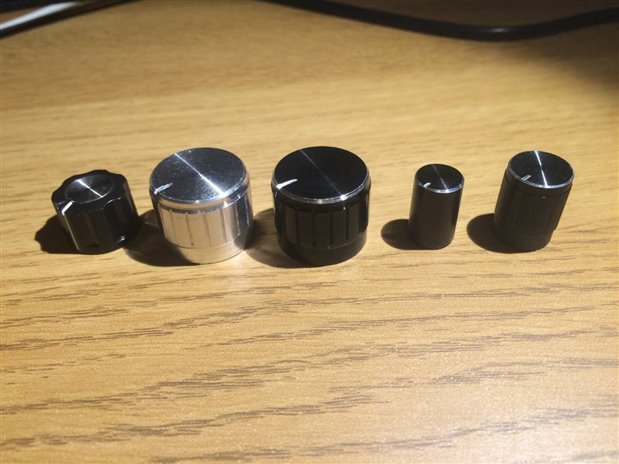

Dials
I've spent the past couple of months buying a range of different knob caps from eBay, and seeing how they look attached to the toy piano. The knob cap I settled on is an aluminium black and silver cap with a very simple design, simply because I thought it went well with the existing aesthetics of the piano. I tried several sizes of the same knob cap, however settled on a 13mm one.
Different knob caps I tried, with the one I settled on on the far right.

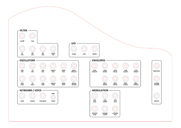

Final Design
Here is a technical drawing of the final design of the front panel, showing all the positions of the controls as well as the labelling of the controls:
The final panel design, show control positions and labelling
There are a couple of reasons why I placed the controls in this particular layout:
  • All controls are grouped into their relevant individual sections
  • There's space left for adding further controls into relevant positions in the future

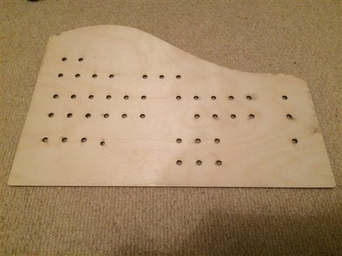

Laser Cutting - First Attempt

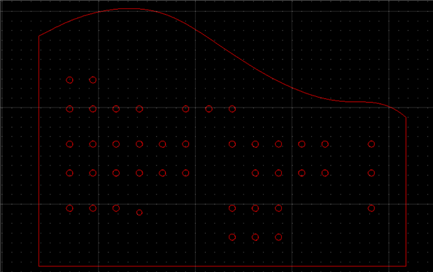

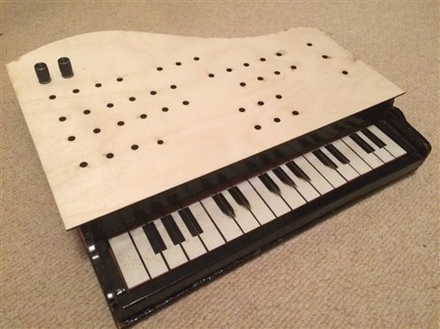

After realising I would need to construct a whole new panel for the piano I was recommended getting it produced using laser cutting, as this could cut out all the needed holes instead of me having to do it myself. With the help of my wonderful girlfriend I got a CAD drawing produced, found a local laser cutting company, Bristol Design Forge, and got a new panel constructed in 3mm birch plywood with all the needed holes for the controls. The thickness was perfect for attaching potentiometers, and was a lot stronger.
A CAD drawing for the first panel design
The 3mm birch plywood laser cut panel
The main downside of this method was that I would now have to completely paint the panel, and this is where disaster struck. First of all I used a gloss black paint that probably wasn't designed to to be used on objects that would be handled a lot (it was tacky and smelly, even after it had dried), and secondly the paint caused the panel to warp quite considerably meaning that it now didn't sit nicely on the existing piano enclosure. I learned two things here:

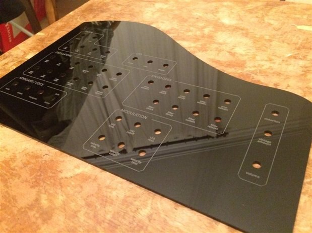

Final Laser Cut Panel

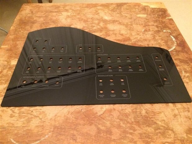

After the first failed attempt at laser cutting I was then recommended to consider using acrylic instead of wood. While I really wanted to keep all parts of the synth wooden, keeping inline with the existing enclosure, there were quite a few benefits to using acrylic instead of wood:
  • It could come in gloss black without me needing to apply any paint
  • I could use laser engraving to produce the control labelling on my panel, which would come out in frosted white - one of preferable labelling colours. This would mean I wouldn't need to paint or stick labels on the panel myself, which probably wouldn't have looked that good.
  • It's not susceptible to warping
Therefore once again with the help of my wonderful girlfriend and Bristol Design Forge I got a second laser cut panel produced, this time in 3mm gloss black acrylic.

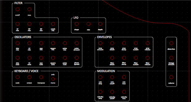

A close up of the CAD drawing for the second version of the panel, showing cut lines in red and engrave lines in white.
The .dxf design file for this can be found in the projects git repository.

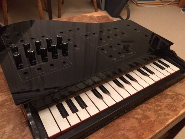

Photos of the gloss black acrylic panel
While I was initially concerned that using acrylic instead of wood would ruin the aesthetics of the vintage toy piano, it turned out to not look too different from the original panel. Hopefully this is the final panel design and construction, and now all I need to do is attach all the controls and get them talking to the BeagleBone Black!

    DAB over 10 years ago
    I love the nice glossy finish, though it might show fingerprints in use.
    You clearly know your way around synthesizers, so I look forward to seeing your system evolve.
  • liamtmlacey
    liamtmlacey over 10 years ago in reply to shabaz
    Hey shabaz, I think the colour change is caused by the way the plastic is altered/melted by the laser.
    However I could be wrong - I've never done laser engraving before and it's quite hard to tell from looking at it.

    shabaz over 10 years ago
    Hi Liam!
    Is the text colour due to the roughness of the plastic after engraving (i.e. the scattering of reflected light causing the black plastic to look a light colour in the photo) or is the engraving filled in with white paint or something?
    It looks fantastic, love the clean layout too.
