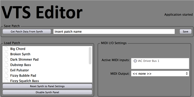

The patch manager application, which is called 'VTS Editor', is very simply and just relies on the correct MIDI messages being sent between the application and the synth in order for it to work correctly.
Saving a patch works as follows:
  1. A specific MIDI CC 127 value is sent from the application to the synth to request all patch data
  2. The synth sends back all the current patch data in the form of the parameters MIDI CC messages (the same as the ones that come from the synths panel)
  3. Once the synth has sent all patch data it sends a 'finished' MIDI CC value so that the patch manager application knows it has got a complete patch
  4. The patch data is encoded into lines of text and saved into its own text file
Loading a patch is even simpler:
  1. A patch text file is decoded into patch parameter values
  2. The patch parameter values are sent to the synth as a stream of MIDI CC messages
I've called the application 'VTS Editor' rather 'VTS Patch Manager' as in the future I'd like this application to become a full software editor for the synth (essentially an extended virtual version of the synths panel), however that's beyond the scope of this design challenge. However I have already implemented a couple of extra controls/features within the editor application that aren't related to patch loading/saving:
  • Reset Synth to Panel Settings - triggers the sound engine to be set to the current panel settings. This functionality also happens when the synth is turned on so that the panel and the backend are in sync.
  • Disable/Enable Synth Panel - temporarily disables the synths panel controls (except for the volume control) from doing anything. I need this as unfortunately I'm still getting some very occasional panel potentiometer jitter, so this allows the user to load a patch without any jitter changing the way it should sound. Eventually I hope to get rid of this control once I've fixed the pot jitter issues.
The Interface
Below is a screenshot of the current VTS Editor interface:
A couple of notes on the interface and its controls:
  • Loading a patch is done using a window that displays all saved patch files
  • It includes controls for setting which MIDI input and output the vintage toy synthesiser is connected to
It's also worth noting that I haven't yet finished the general look-and-feel of the interface - eventually I want it to use the same colour scheme and font as that of the synths front panel.
