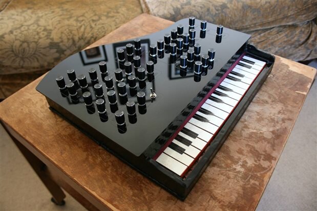

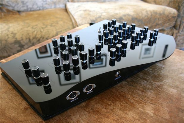

Photos
Below are some high-quality photos of the final state of the vintage toy synthesiser.
