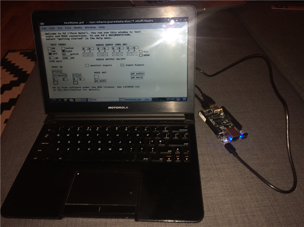

Hey guys, for those of us planning to use Pd~ for the Music Tech Challenge, I thought I'd start a thread where we can share tips and ask questions etc. so that it's all in one central location.
My progress so far:
  • Flashed Ubuntu to the eMMC of my BeagleBone
  • Configured it to work properly with my Motorola Atrix Lapdock (pictured above) so that I don't have to SSH in or connect to a monitor, mouse & keyboard all the time
  • Configured wireless networking via a tiny Edimax WiFi dongle (which was a bit of a headache)
  • Installed the LXDE desktop
  • Installed Puredata
Next step is to get Jack/ALSA working with one of my USB soundcards to test some stuff out. I'll add some links to resources that I found useful for some of these processes to this thread soon.
So, who else is going to come sit at the Pd~ table at lunch time? (Also known as the "cool kids" table)
