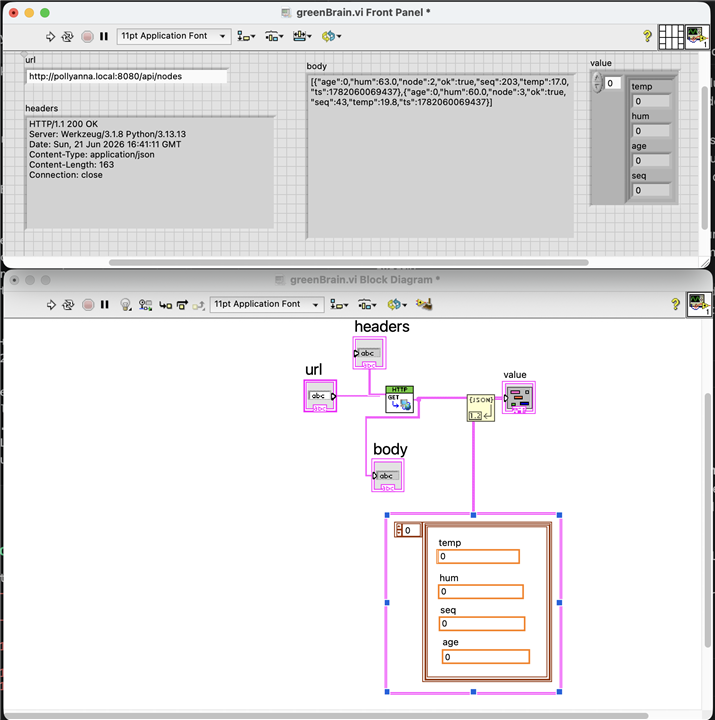

LabVIEW was new territory. The HTTP Client GET VI reached the Flask REST API without trouble. Parsing the JSON response with Unflatten From JSON requires building an array-of-clusters constant that exactly mirrors the JSON structure — outside-in, array shell first, cluster inside, typed constants with matching labels. I hit a type mismatch error (0xFFFA4723) and ran out of time to track down which field was wrong.

  • LabVIEW JSON parsing — type mismatch with array-of-clusters, one field wrong somewhere

  • Finish LabVIEW JSON parsing (Flatten To JSON debug to find the type mismatch)
