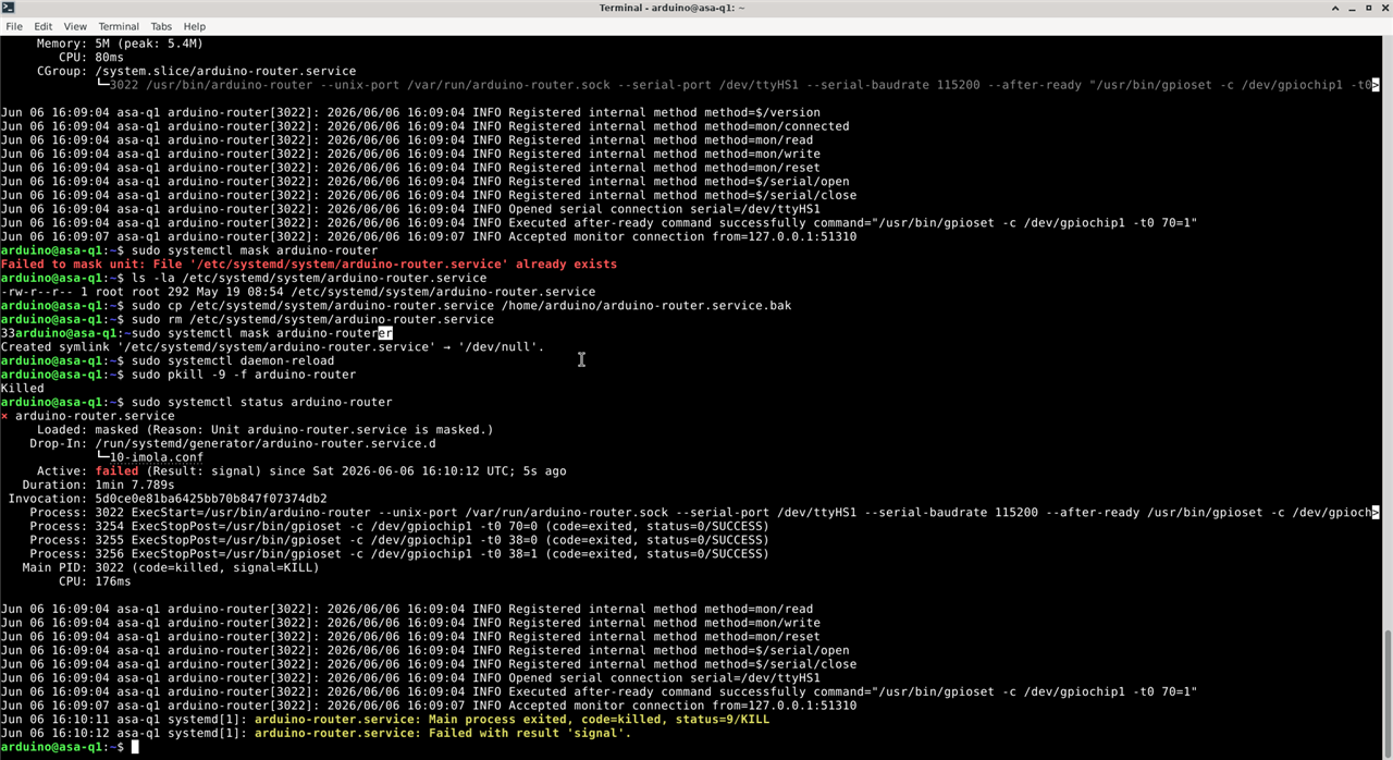

Taking Control of the STM32 from the hands of Qualcomm Chip
Step 1: Disable arduino-router Service
I connected to the ArduinoQ's terminal via SSH ssh arduino@<boardname>.local where boardname is the name you gave it while setup. The Password is again the same as you gave in the setup
sudo cp /etc/systemd/system/arduino-router.service \
        /home/arduino/arduino-router.service.bak
sudo rm /etc/systemd/system/arduino-router.service
sudo systemctl mask arduino-router
sudo systemctl daemon-reload
sudo pkill -9 -f arduino-router
I ensured that i restarted the Q to ensure that the service does not pop up back again.

    arvindsa 5 months ago in reply to saramic +1
    Once you killed the router, You should get a response "Killed", check with "sudo systemctl status arduino-router" Status should be masked and there should not be any indication that it is running. Restart…
  • arvindsa
    arduino@asa-q1:~$ sudo systemctl status arduino-router [sudo] password for arduino: ○ arduino-router.service Loaded: masked (Reason: Unit arduino-router.service is masked.) Drop-In: /run/systemd/generator…

  • saramic
    saramic 5 months ago
    glad you got to a point where you got around the RouterBridge, I tried many time, I got to your mask command but maybe needed a restart there and then?
    sudo systemctl daemon-reload           // not sure I did this
    sudo pkill -9 -f arduino-router        // this just kept coming back
    that said - I did mange to just get the bridge working and haven't really looked back - still I am yet to connect the MAX3304 shield
  • arvindsa
    Once you killed the router, You should get a response "Killed", check with "sudo systemctl status arduino-router" Status should be masked and there should not be any indication that it is running. Restart is not necessary, i restarted my Q to make sure there is no setting in the arduino that reverses me masking the router. It did not. You can share the result of the "sudo systemctl status arduino-router"
    Once the bridge is disabled, then the serial port is free to be accessed by a python code. Do install
    sudo apt update
    sudo apt install python3-pip
    pip3 install pyserial --break-system-packages
    After that you can use the python code in the Step 4. Or if you prefer rust use ... sorry i dont know rust.. the appropriate function to open /dev/ttyHS1 and stream the data from and to it. Essentially this becomes your custom bridge between MCU and MPU
  • arvindsa
        Drop-In: /run/systemd/generator/arduino-router.service.d
                 └─10-imola.conf
         Active: inactive (dead)
    this is output of my Q currently.
