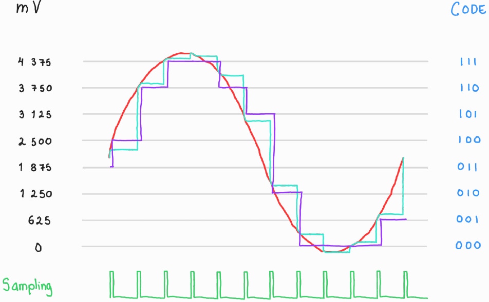

A computer system is not able to process an analog signal. Despite this fact, a digital system, such as a processor, can process an enormous amount of data to make decisions about physical variables. How is a physical phenomenon described by the data stored in a memory section? The answer is simple but quite difficult to implement. An analog-to-digital converter is required to take an analog signal and convert it to digital data. This process involves a time-based sampling to observe the phenomenon, quantify the observed value and assign a digital code that is representative for the digital system.
Analog-to-Digital convertion
Figure 1 Analog-to-Digital convertion representation

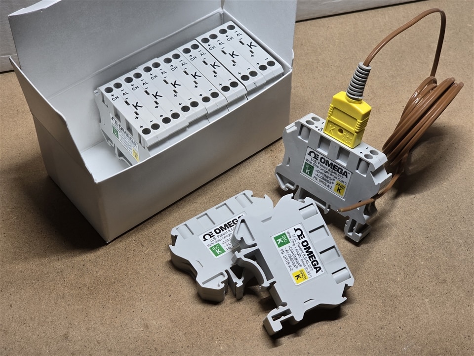

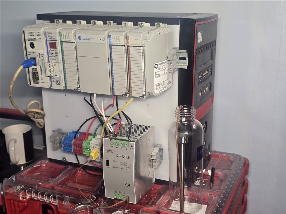

After exploring multiple options for creating an interface between the thermocouple and the data storage, I decided to use a commercial option to acquire temperature data. The first option I considered was using the DeviceNet protocol with an Allen Bradley PLC. Although the 1769-32E CPU is not recommended for new designs, it can perform interesting tasks. At least four thermocouples can be connected using the 1769 Thermocouple module, but the connection of Cold Junction Compensation (CJC) is required for the correct measurement of the environment. On the other hand, special thermoblocks and wire extensions are required for the connection with the module since a small wiring variation can induce offset and/or non-linearities in the measurement. Another option is to use temperature transmitters or analog front ends (AFE). While these elements have the same inconvenience of the thermocouple module for wiring, most of the AFE found has a temperature range above 0 °C. For test purposes are useful, but in the future the system requires measurement below this magnitude. The last option is the UT325F of UNI-T thermometer system. This equipment has up to 4 channels in multiple kinds of probes; it is possible to adjust the temperature offset since the CJC is internal and it has a Windows/Android application to capture data.
{gallery}Interfaces
PLC assembly
Thermal blocks
UT325F assembly
Figure 2 Data acquisition assembly options for thermocouple connection

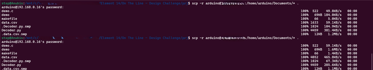

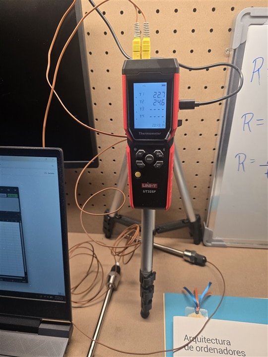

As you wonder, I asked myself a question, is it possible to get data in the Arduino UNO Q Linux system? The answer, YES!!!

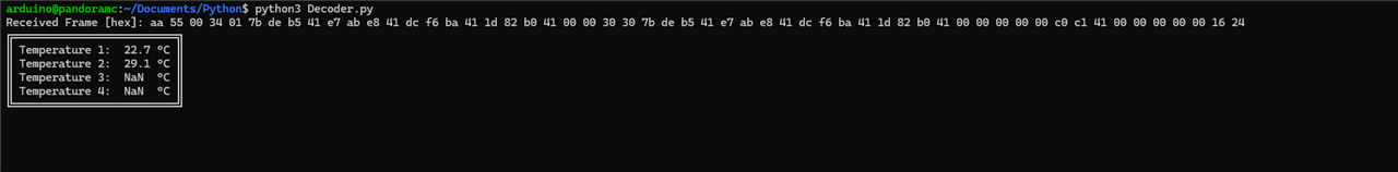

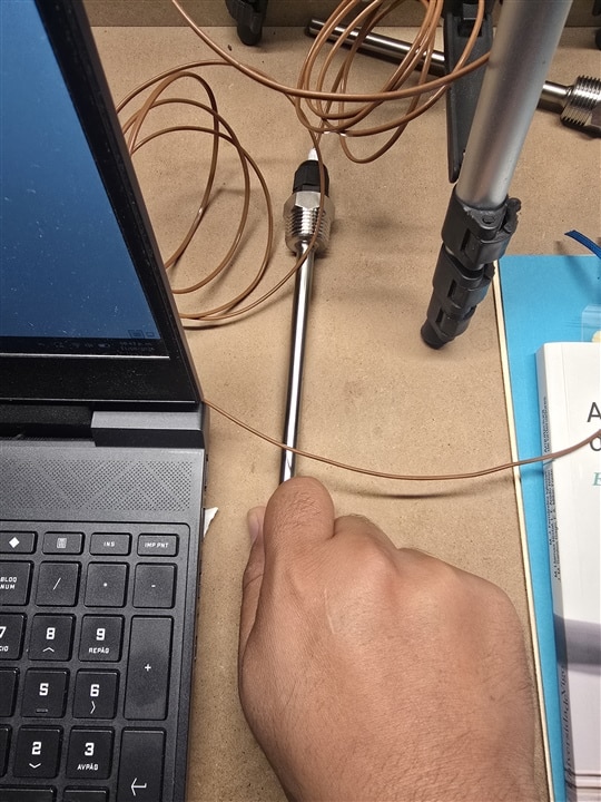

I did a lot of tests capturing the data and recognizing patterns in the received frame. The procedure consisted of the connecting and disconnecting the probes in each channel of the thermometer. I recognized some number patterns heating the probe with my hand, but I was not able to understand it at all. Aided by an AI tool I recognized two important patterns the data is transmitted in little endian while the CRC is transmitted in big endian. The data is repetitive, but I am not sure why at the moment to write this blog. And the third pattern recognized completely by me is to inform if a probe is connected to a specific channel. This task was in a PC since the equipment has a CH340 USB-to-UART variant which Arduino UNO Q Linux image has not a driver to handle communication. This was solved compiling and installing a driver available here: https://learn.sparkfun.com/tutorials/how-to-install-ch340-drivers/linux
And the results were incredible
scp command
Figure 3 Project transfer from the Arduino UNO Q to the PC by ssh copy
Data capture
Figure 4 Serial port frame capture with data decoding

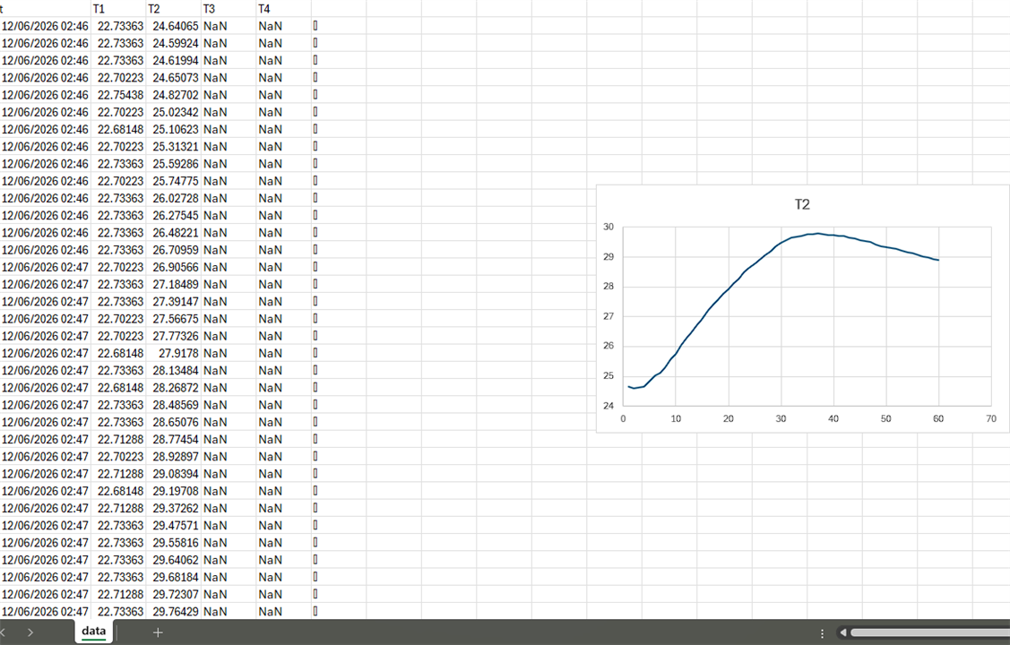

Now, it is time to integrate the RCP interface for the usage of the microcontroller to activate the compressor. Actually, the implemented script can receive data, process and write a CSV file to be stored in memory for future consult and analysis, but it is not able still to make decisions. The last test will consist of data sharing between the processor and microcontroller to test the system threshold and hysteresis for a full-operation test.
{gallery}achievements
stimuli
Data stored
Figure 5 Actual temperature data storing achievement
