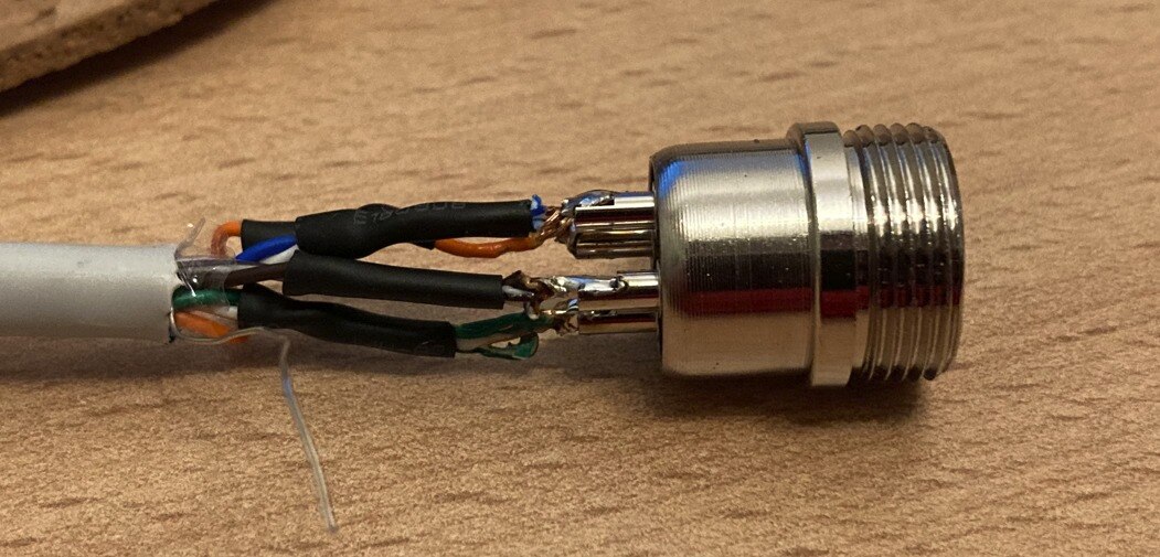

Hi. I welcome you to my second forum post as part of my participation in On The Line Design Challenge. In this post, I will describe how I prepared Omega HX94 humidity + temperature sensor to enable experimenting with it on breadboard.
Preparing Cable
First step is preparing cable for connecting sensor. It could be definitely done in hacky way, but I tried less hacky way and actually used connector which was bundled in package and mounted it to ethernet cable.
Process is explained in printed manual which come with the sensor:
First step is separating connector by unscrewing tiny screw on side:
Then you can solder, wires to four contacts inside connector.
As you can see, I did not forget about heatshrink, however since contact are large, I need to heat them a lot and heartstring sooner then I needed.
Next step is pulling other part of connector from other side of cable:
Then you can push parts together and fit back small screw.
Another end I made breadboard friendly:
Across whole process, it is good idea to check for open connections and short circuits, but I was lucky this time. This is a result. Now my sensor is breadboarded:
It is sensor with analog output, so next time, I will try it with power supply and multimeter. These two are enough to obtain reading from it.

    Always a problem insulating the conductors in small connectors! One way is to replace the heatshrink with rubber tubing (there is a 3-prong tool that expands the rubber sleeve) and put it on each conductor…
    shabaz 5 months ago
    One way is to replace the heatshrink with rubber tubing (there is a 3-prong tool that expands the rubber sleeve) and put it on each conductor's insulator, then solder as normal, then slide it over (can lubricate to do that if needed).
    The more unorthodox method I like is to instead use little pieces of polyamide tape, and tweezers to wrap it around each conductor individually, after soldering. Takes up very little space, so the connector shells go on easily afterwards.
