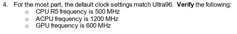

This part of the Lab took us through all the clock assignments to ensure they were correct (unsurprisingly they were). The nice part about this was we now know where the different clocks are assigned. I am however not entirely sure where the clocks values we are using have come from as they were stated without a reference (See image below). I however haven’t spent any time looking into them further, maybe it will become clearer as the course progresses.
We also disabled the PL (Programmable Logic) during these steps as it is not currently in use.

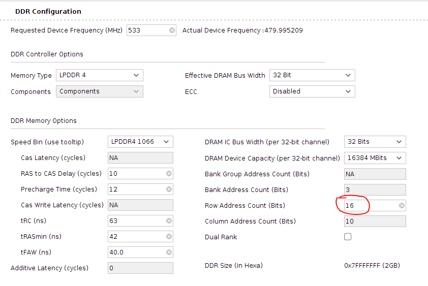

The final part of the hardware setup we had to do was configure the memory. Vivado provides some preset defaults for a few different memory sticks, however ours did not use any of these so we needed to define it ourselves. The guide provided all the values we should use so we didn’t need to go digging through the LPDDR4 datasheet. Luckily, since I haven’t gotten my hands on a copy of the datasheet! (It appears to be available on the Micron website but requires an account being made to download it so I didn’t bother at this point).
Export Hardware to SDK:
Finally we had to generate a bitstream and export the hardware. I encountered a concerning critical warning about my row address count, shown below.
It was confusing because I remembered setting the row address count to 16 in the previous step, I went back and checked what I had it set to and it’s definitely 16, see below.
This did not stop the bitstream being generated so I ignored it and just continued, has anyone else seen this or are able to explain it?

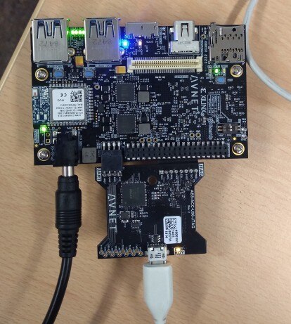

As always the steps were clear and easy to follow (Though I did have to figure out when to power the Ultra96-V2 all by myself). The only issue I had was I had configured my terminal to 9600 not the 115200 that the Ultra96-V2 UART was configured to so my initial attempt returned no data to my terminal. Fortunately I spotted the issue right away, updated my serial settings, reran the application (which takes a little time, I bet there is a better way to reset it!) and was greeted with a “Hello World” message.
I’ve also included a picture of the hardware, who doesn’t love a selection of brightly coloured LEDs?
