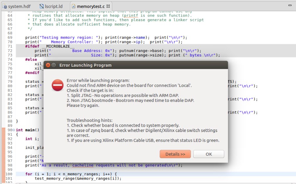

In Lab 5 we finally get to connect the hardware and test the applications from the previous lab. I had no issues during the hardware setup process, the serial drivers for the JTAG module were detected straight away and I was able to link the device to my VM. I was quite surprised everything worked from the first attempt as serial drivers tend to be a pain. This assumes that all the steps during the VM setup were completed carefully.
Figure 1: Connection Error
However, I had some issues with loading the Hello World application to the board with error message shown in Figure 1. The possible issues listed there were not applicable in my case – so I just relaunched the run. The error message did not appear anymore, and FPGA programming was initiated as expected.

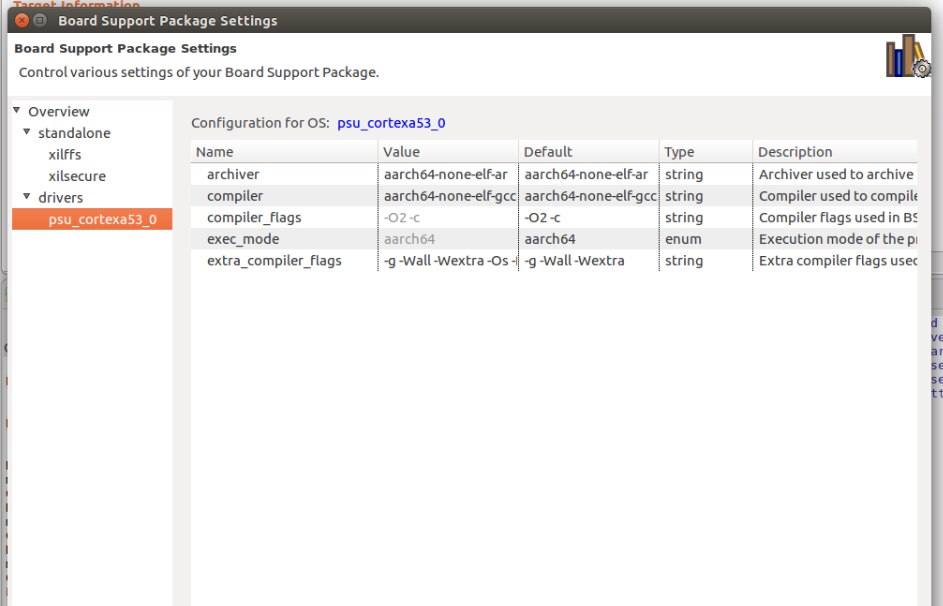

Figure 2: Setting Compiler Optimisation Level for BSP
Another important point covered in the lab is where to set the compiler options for the project. Note that it needs to be done separately for the application and the BSP. It is done via project properties for the application code and in “Manage BSP Settings” menu for the BSP.

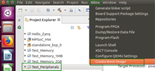

Once the previous labs are completed, it is finally time to put all the components together and create a boot image for Ultra96. This is done by selecting the application project and choosing the corresponding option as in the screen shot below.

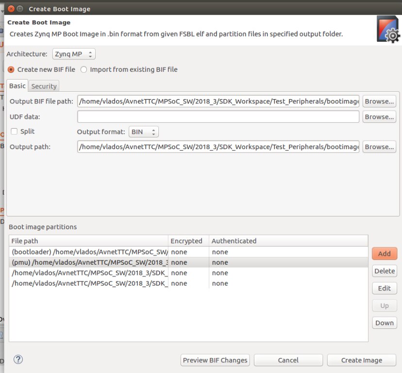

Now it’s time to add the files for the bootloader, PMU, FPGA bitstream and application file. The order in which they are loaded is very important and should be as follows:
  1. FSBL;
  2. PMU;
  3. FPGA bitstream;
  4. Application .elf file.
Figure 4: BIF file and Binary Generation
This way two output files are generated: BOOT.bin image file and a .bif file (Boot Image Format) which lists the partitions and the corresponding attributes.

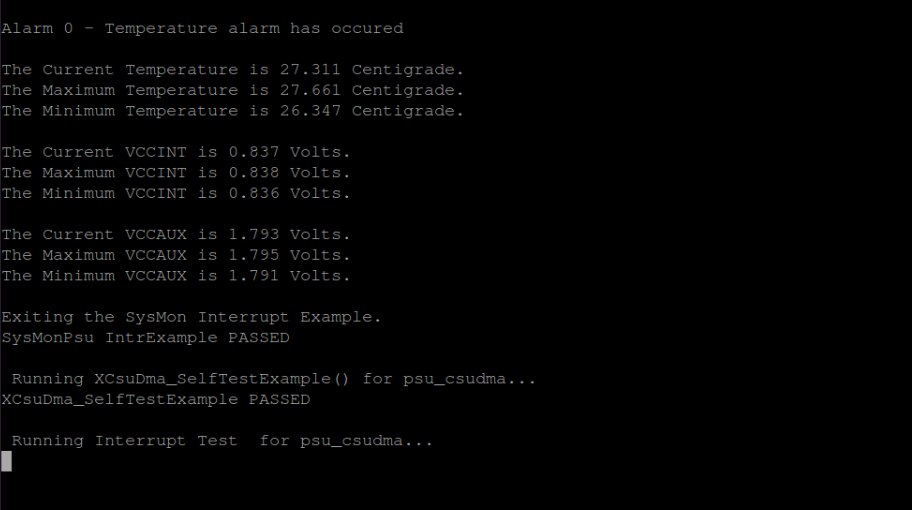

SW Lab 10
Objectives:
    • How to enable one of the Xilinx libraries within your standalone BSP
    • How to leverage one of the Xilinx libraries from a standalone application
    • How to configure and use the Xilinx System Monitor.

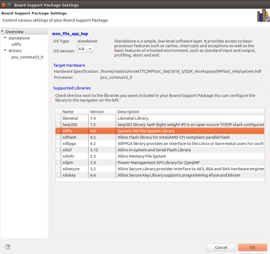

Finally, I learnt how to add Xilinx libraries to the BSP using the FAT File System library as an example. It allows to you to read and write from/to an SD card which is very handy for data logging for instance. It is great that this was included in the course as I am sure many will use the option to store some files externally and work with them during the application run-time in the final projects.
Adding a library is as simple as ticking a box in the BSP settings. You can perform all the necessary configurations for the library in the same window.
Figure 6: Adding Xilinx Libraries to BSP

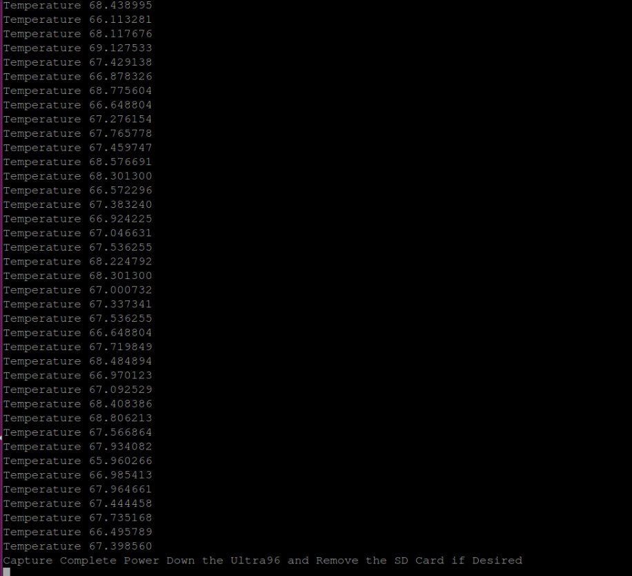

We used the readings of the internal temperature sensor and an ADC to test the capabilities of the xilffs library. I did not have any issues with running the application and the temperature readings were displayed in the terminal as well. However, I noticed that the fan on the board is working non-stop and Ultra96 gets quite hot – even though the application is not really “heavy”, the temperature reached 63 degrees C. Some components on the board like the USB ports were heated quite badly as well.
I am wondering if anyone else is experiencing the same?
Figure 7: Temperature Readings
This concludes the Software module for now but, as I said, I am planning to revisit the two remaining labs if get the hardware required.
