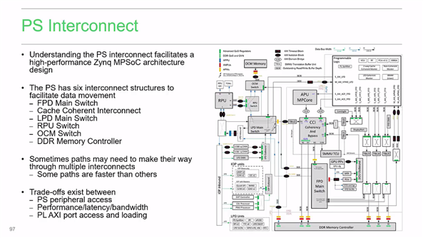

HW Chapter 5 video: Merging the PS and the PL
  • Interfacing the PL to the PS using different AXI interfaces
  • An Introduction to AXI
  • Cache coherency features
  • PS Interconnect

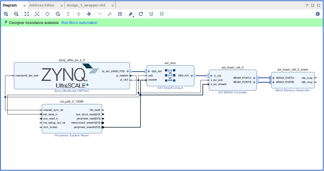

HW Lab 5 - Adding a PL Peripheral
  • Add the PL BRAM IP to the block design
  • Enabling the PL clock, PL reset & AXI Master interfaces on the PS

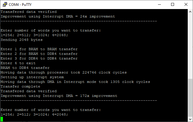

HW Chapter 6 video: Zynq DMA Controllers
  • How the PS DMA controllers can speed up PS-PL data transfers
  • DMA controllers for the PL: AXI DMA IP blocks
HW Lab 6 - Improving Data flow between PL and PS utilizing PS DMA
  • Running a DMA test application

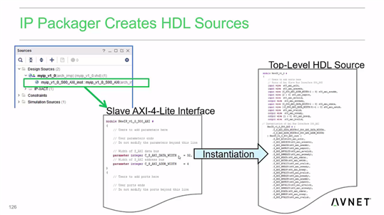

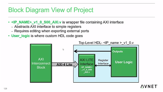

HW Chapter 7 video: Creating Custom IP
  • Using the Vivado IP integrator & packager
  • Creating new IP
HW Lab 7 - Adding Custom IP to Vivado IP Catalog
  • Create a new IP project
  • Integrating custom HDL files with the auto-generated AXI interface HDL files
  • Packaging IP
  • Adding the custom IP to the block design

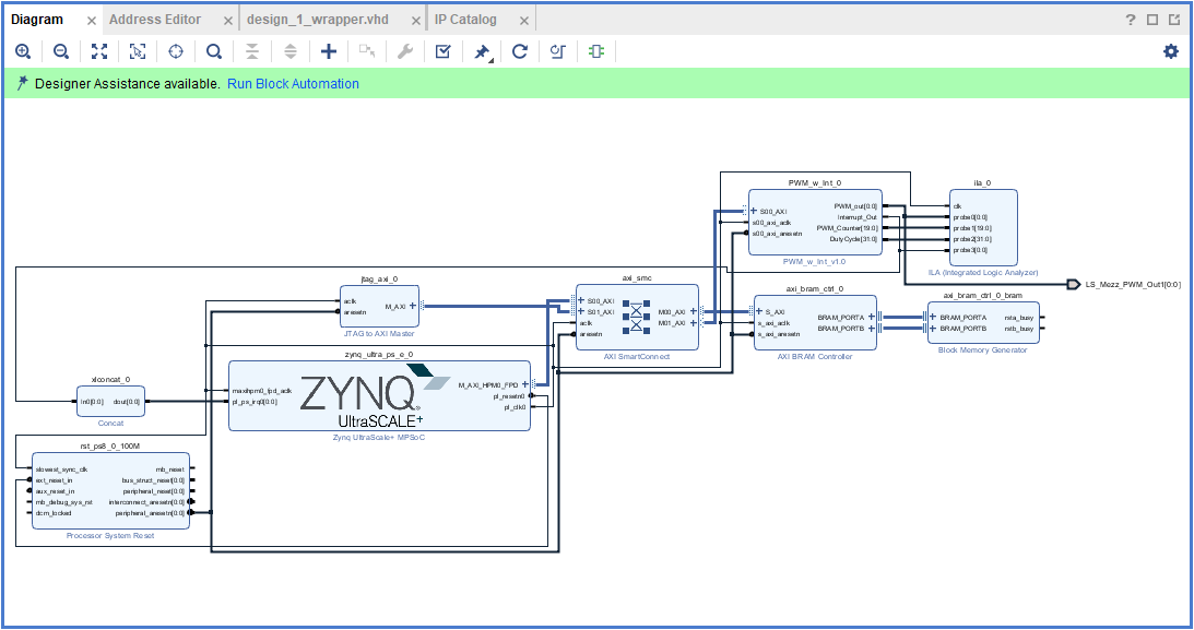

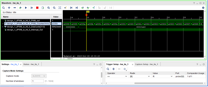

HW Chapter 8 video: Vivado's Hardware Manager
  • Vivado Logic Debug IP: ILA, VIO, JTAG to AXI

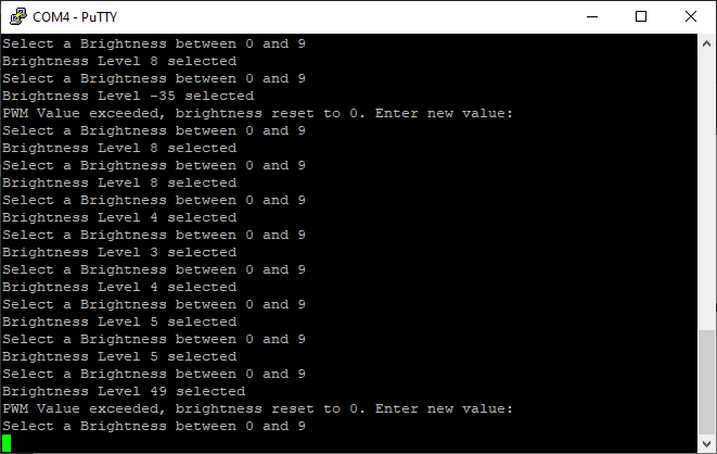

HW Lab 8 - Hardware Debugging Zynq Designs
  • Imported the software project that controls the PWM IP
  • Using Vivado's Hardware ILA (Triggers etc.)
  • Generating AXI transactions using the JTAG to AXI interface & Vivado Tcl commands
