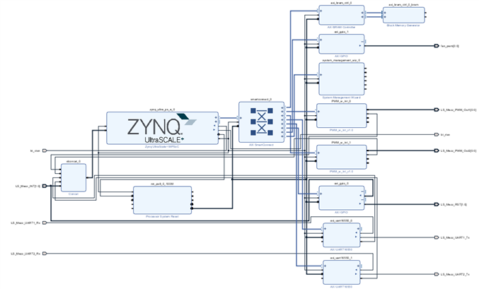

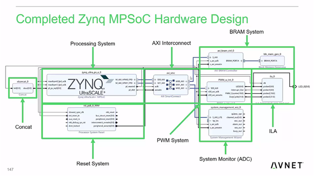

HW Lab 9 - The Power of Scripting using Tcl
  • Executed the provided Tcl script which removed some blocks (JTAG-AXI) and added some (GPIO, System Management Controller etc.)
  • Synthesized, implemented and exported the hardware design so that it can be used in Xilinx SDK.

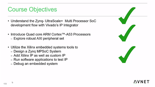

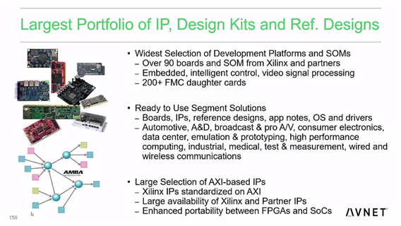

HW Chapter 10 video: Next Steps
  • Software Support Ecosystem
  • Xilinx's portfolio of IP, design kits, reference designs & FMC cards
  • How to get help and support
  • Use Xilinx DocNav for documentation.
This completes the hardware labs. The software videos & labs will use the design that we've just built and exported.
