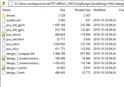

SW Lab 1 - Explore a ZU+ MPSoC Hardware Platform
  • Explored the contents of the .hdf file that was exported from Vivado. In essence, it's a .zip file, so it can be opened with an archive manager & contains a bunch of files.

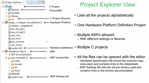

  • How applications are arranged & structured in SDK: a hardware project (from Vivado), board support packages & applications

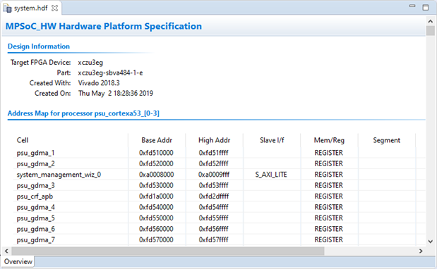

SW Lab 2 - Importing the Hardware Platform into SDK
  • Imported the .hdf into a new Xilinx SDK workspace.
  • Had a look at how SDK interprets the hdf file - it displayed the address map, recognized the IP blocks we added and even displayed the register map for Xilinx IP.

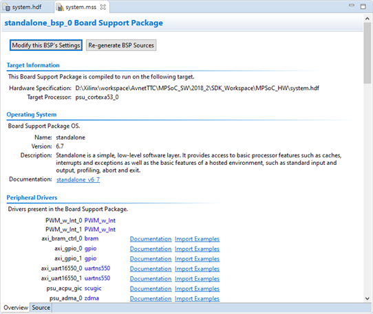

SW Chapter 3 video: Standalone Board Support Package
  • The BSP includes drivers for a specific hardware definition. SDK reads the .hdf (hardware definition file exported from Vivado), and includes the necessary drivers

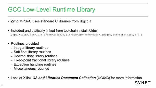

  • SDK uses C libraries from GCC

  • Xilinx SDK features automatic BSP generation. "A board support package (BSP) is a collection of libraries and drivers that will form the lowest layer of your application software stack. Your software applications must link against or run on top of a given software platform using the application programming interfaces that it provides."
  • Created a new BSP & looked at all the options that wizard has.
  • The BSP viewer in Vivado automatically detects when a certain driver has documentation & examples, and displays a hyperlink.

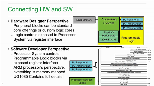

SW Chapter 4 video: Developing Applications
  • The BSP includes examples for drivers of Xilinx IP blocks
  • Xilinx also includes sample applications eg. for the UART, executing memory tests

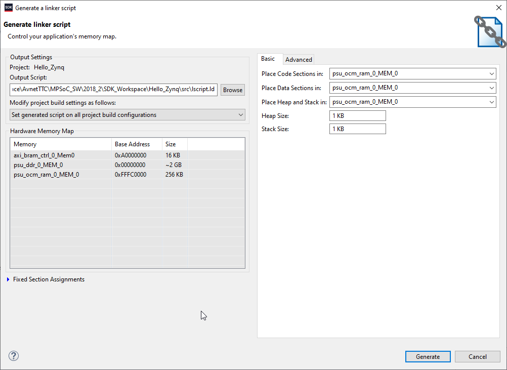

  • SDK has a linker script generator - which allows you to place different sections (code, data, heap, stack) in different memories (on-chip memory, BRAM in the PL or DDR)
  • Compiler & linker errors are displayed the same as standard Eclipse, which also provides syntax highlighting, code completion etc.
  • Project Explorer shows you all the hardware platforms, BSPs & applications in your workspace
image image
SW Lab 4 - Develop a Zynq Software Application
  • Added an empty application project & copied over code from one of the UART examples.
  • Looked at the linker script - Vivado parses the text file and displays the parameters in a nicer looking page.
  • Generated a new linker script and relocated all the program sections from the BRAM to the OCM.
  • Added applications to test the peripherals & memory
