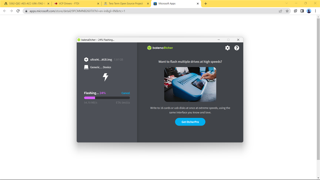

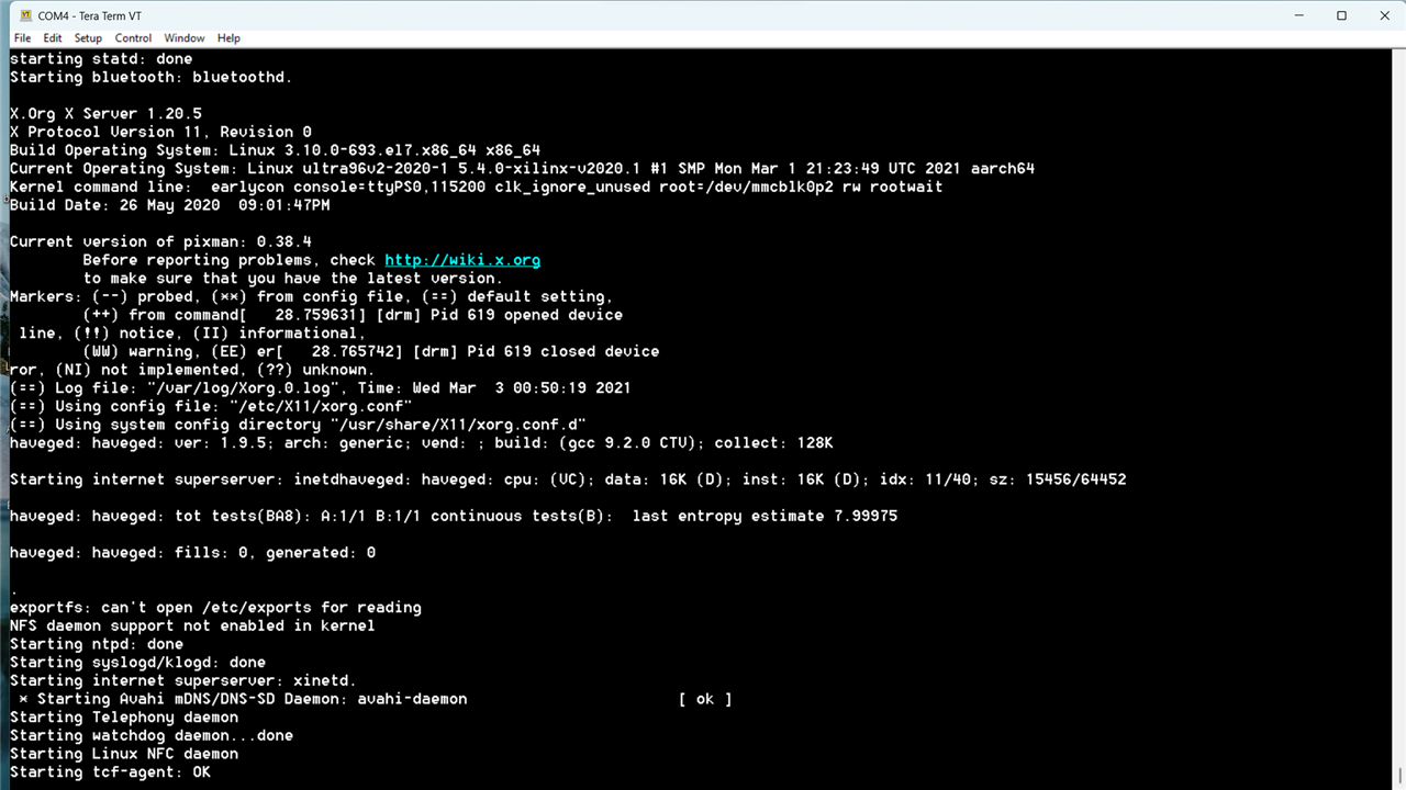

Ultra96-V2 SBC Booting
Please do provide your comments, Suggestions.
SD card Flashing
Tera term Snapshot
Log File : 0624.teratermlog.txt
