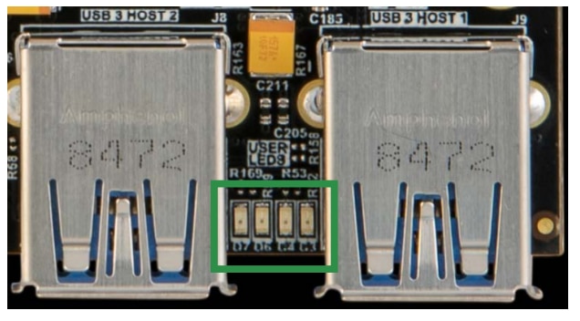

Ultra96-V2 provides four user-controllable LEDs. Engineers may also interact with the board through the 96Boards-compatible low-speed and high-speed expansion connectors by adding peripheral accessories such as those included in the MikroE Click Mezzanine for 96Boards (available as an accessory).

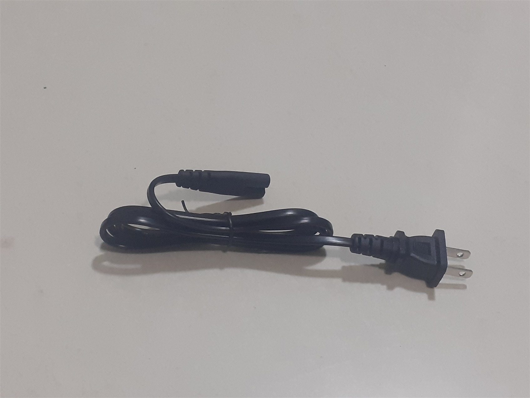

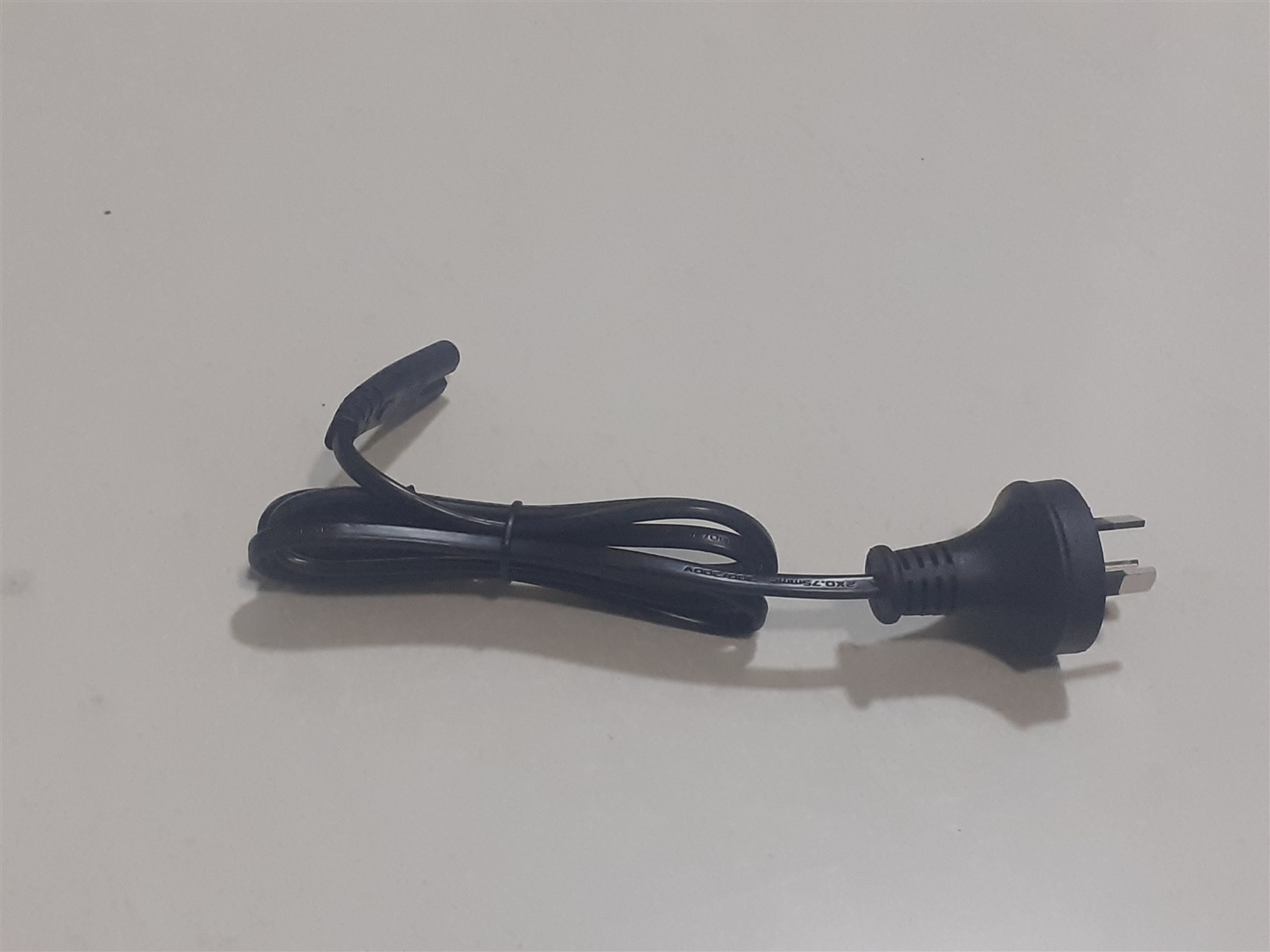

AES-ACC-U96-4APWR Power Supply
Things included in the power supply Box:-
12 volt 4 amp power brick (input:- 100-240 volt, current 1.5amp)
Two pin European style electrical connector
3 pin European style socket connector without fuse
3 pin European style connector with fuse
2 pin Indian connector

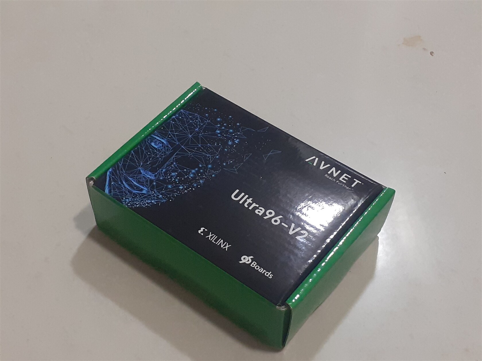

Ultra96-V2 box
Things included in the Ultra96-V2 box Box:-
AES-ULTRA96-V2-I-G development board heatsink without fan
Operating manual

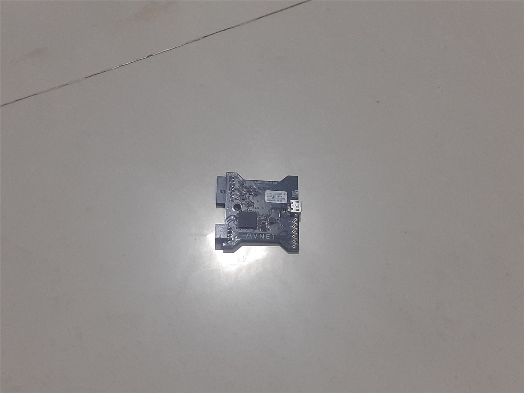

Ultra96 USB-to-JTAG/UART Pod
Things included in the USB-to-JTAG/UART Pod Box:-
USB to JTAG/UART pod
USB to JTAG/UART operating manual

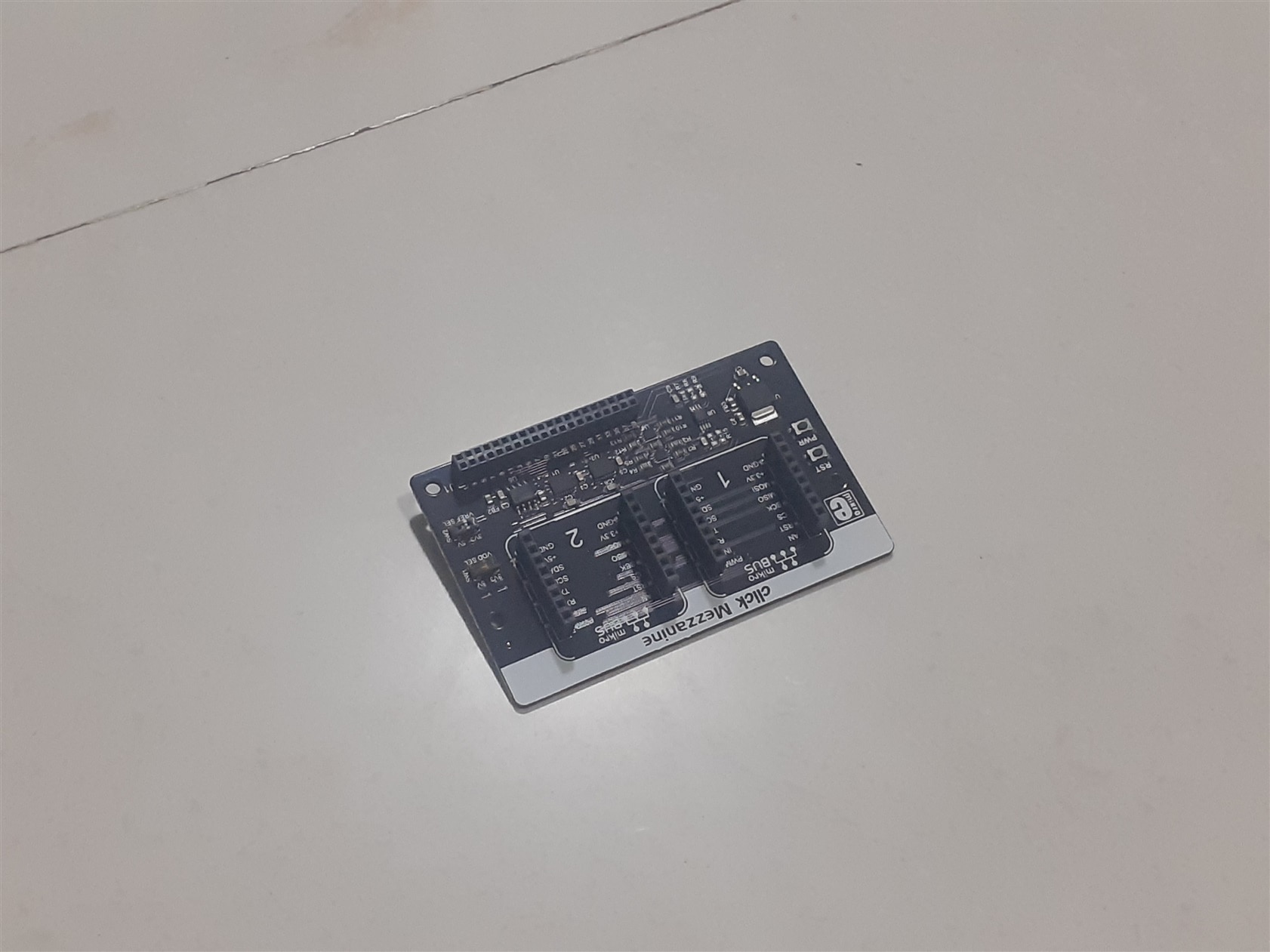

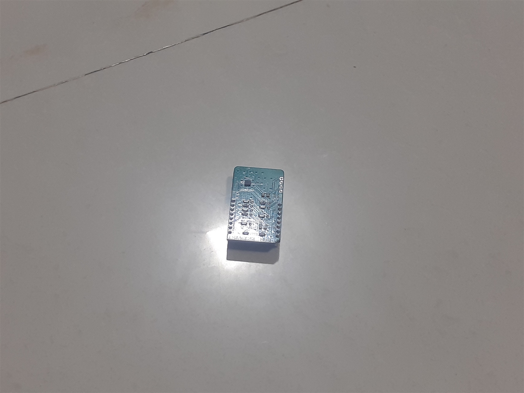

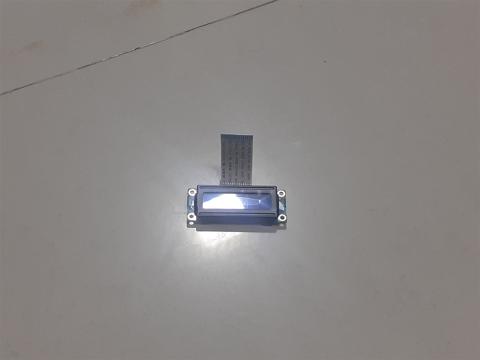

96Boards Click Mezzanine Starter Kit
Things included in the 96Boards Click Mezzanine Starter Kit box
List of available click board price list (This is very interesting price list that can be used for future project making)
Click mezzanine board
LCD
LCD board
USB to I2c
accelerometer

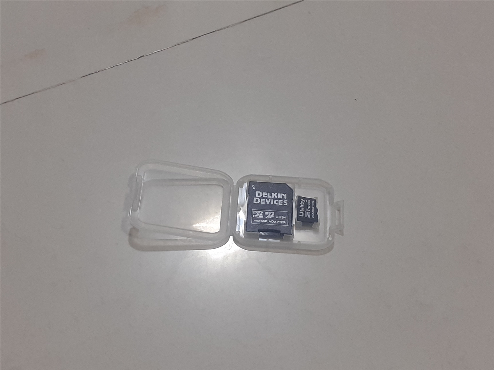

Writing LINUX ISO on SD card:-

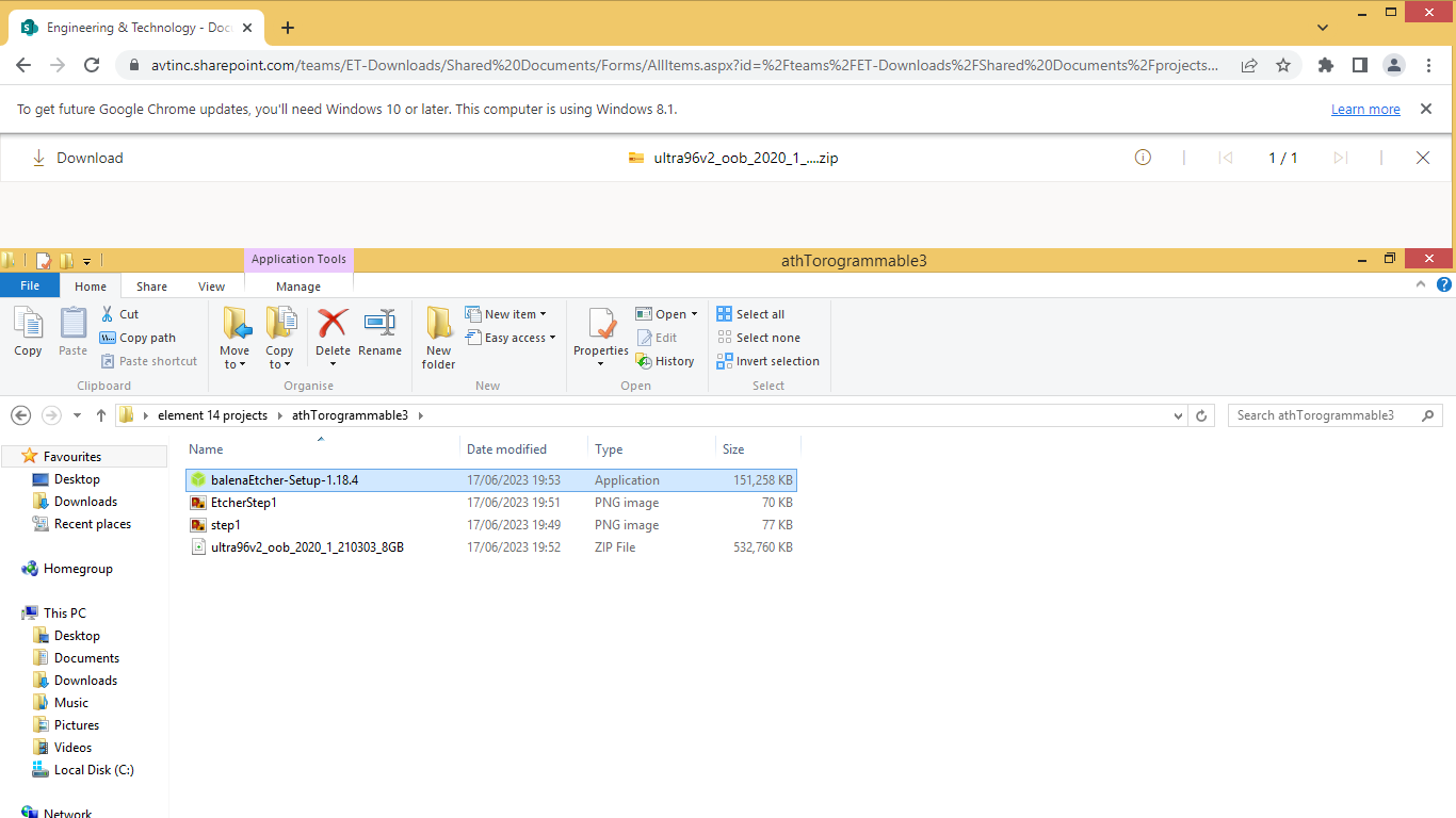

For writing LINUX ISO on 16 GB SD card you have to download the LINUX ISO from the following link “avnet.me/ultra96-v2-oob”. After you open the link on the web browser you will see the webpage as shown on figure 1.1
Figure 1.1

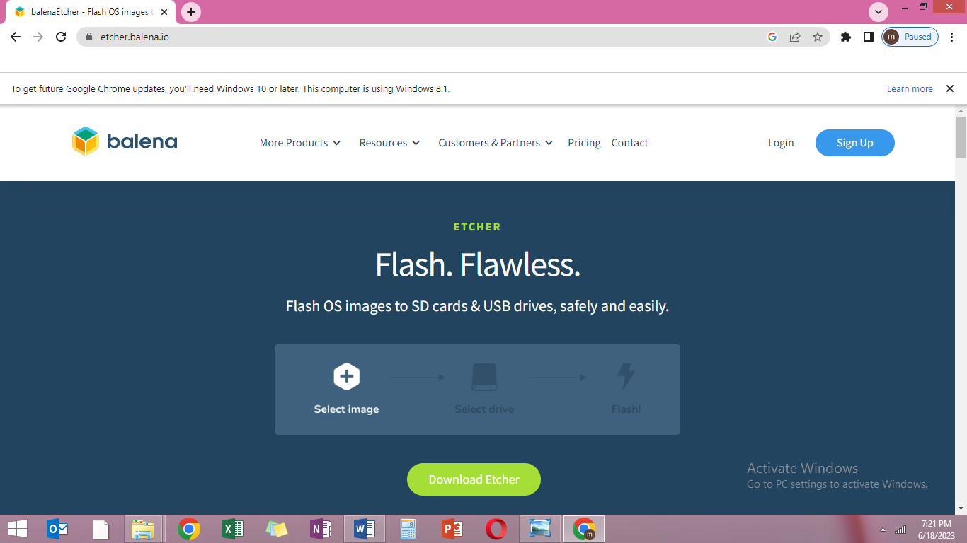

Click on ‘Download’ to download the ISO. After downloading the ISO you need to write that ISO on SD card provided using etcher program. I will be using balena etcher
Downloading BalenaEtcher Program
To download BalenaEtcher Program. Open the following link on the web browser “etcher.balena.io”. A webpage will be opened as shown on figure 2.1 bellow.
Figure 2.1
Click on “Download Etcher” to download the etcher program.
(Note:- Etcher program will write on boot sector of the SD card. It’s purpose is to make SD card bootable. It write image files such as .img, .iso and zipped folder creating SD card bootable)

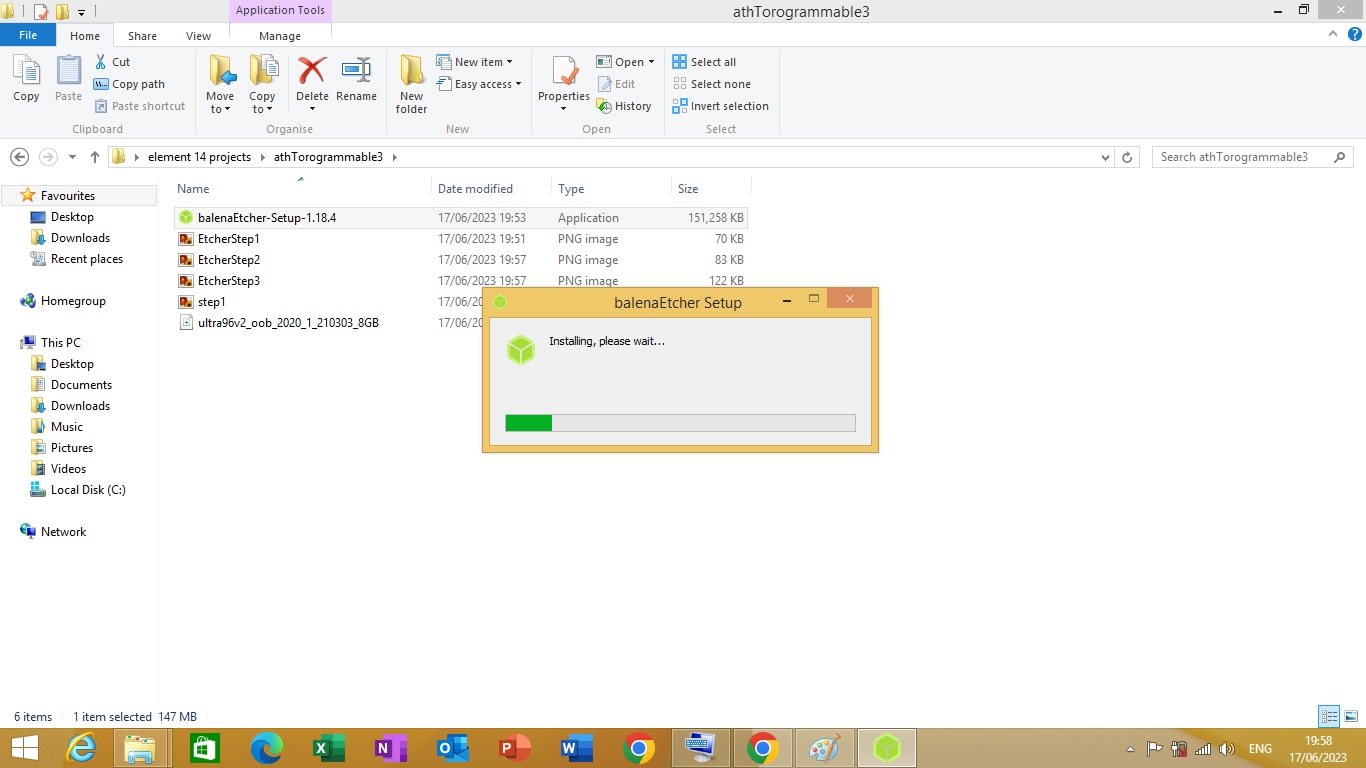

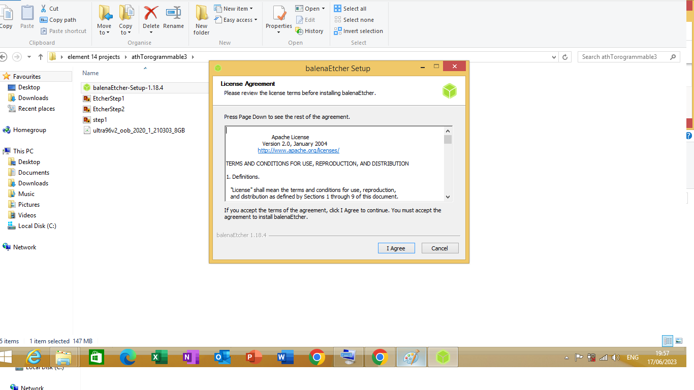

Installing BalenaEtcher Program
To install the ‘balenaetcher’ program, double click on the ‘balenaetcher setup’ as shown in figure 3.1
Figure 3.1
It will open a dialog box with license agreement as shown on Figuer 3.2. click on I agree to continue the setup.
Figure 3.2
Installation process will start as shown in Figure 3.3
Figure 3.3
Once the installation process is complete you can open the BalenaEtcher application by double clicking on BalenaEtcher desktop icon on your desktop.

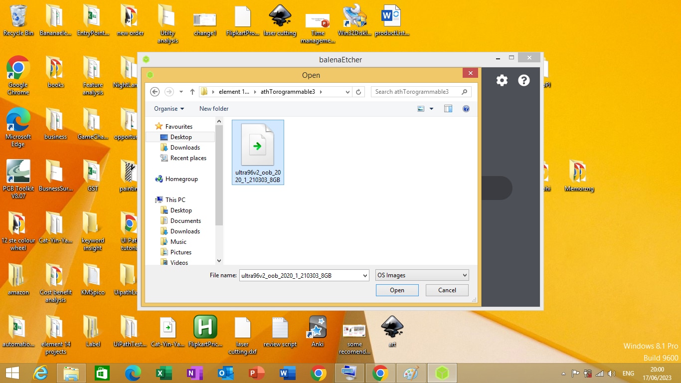

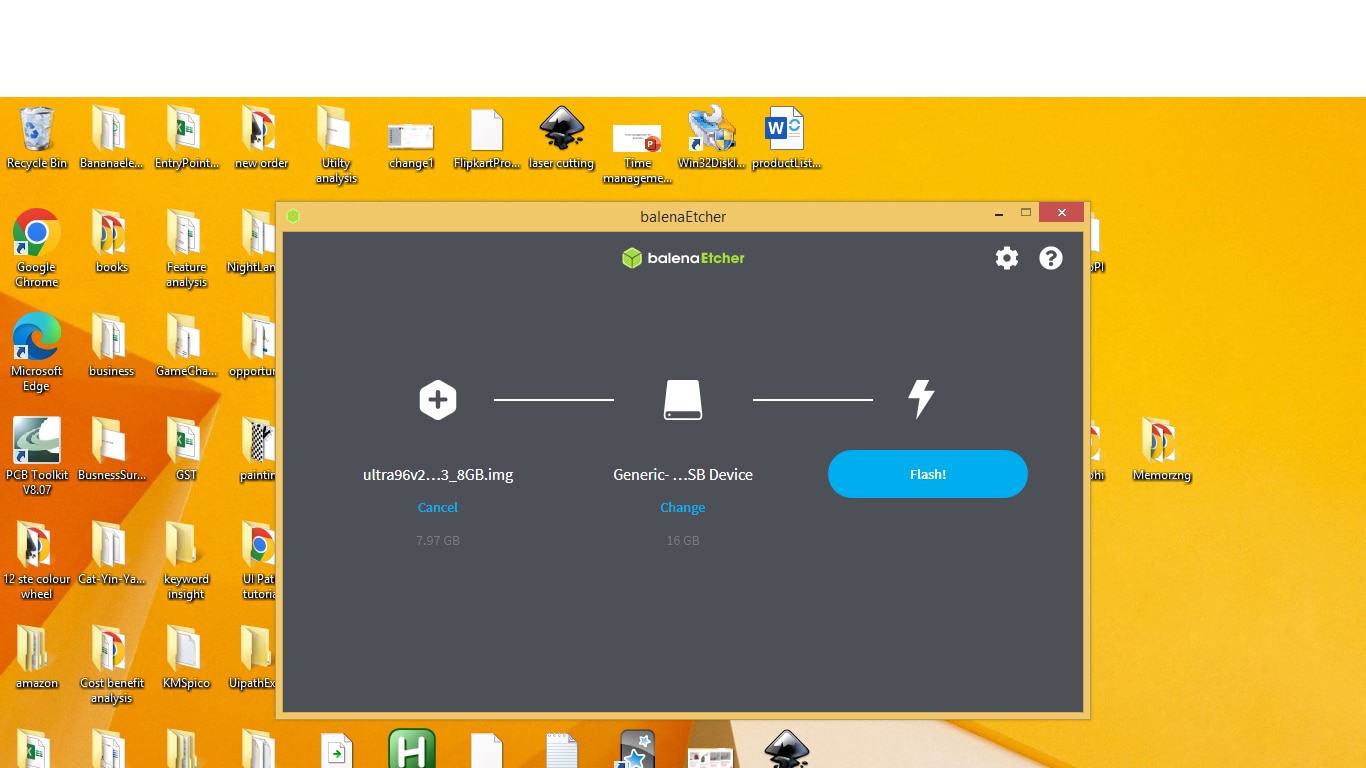

Click on ‘Flash from file’ button on the application it will open an open window dialog from where you have select the OS image that you want to write on SD card as shown in figure 4.2 .
Figure 4.2

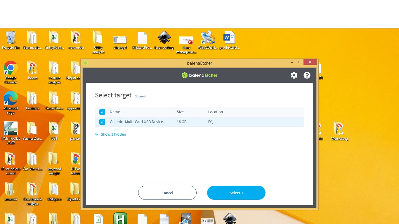

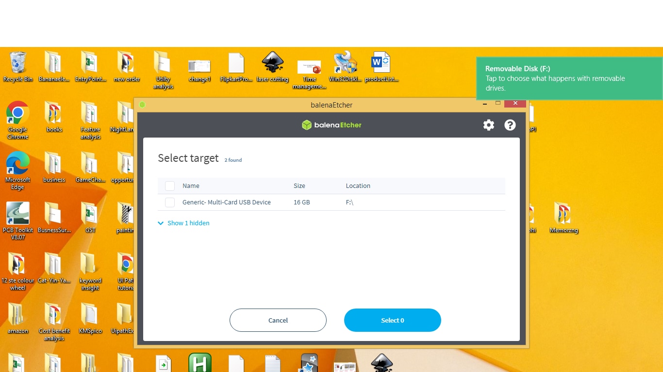

Click on ‘ultra96v2_oob_2020’ and than click open to open the file. After you open the file the balenaEtcher will automatically open Select Target dialog box as shown in Figure 4.3.
Figure 4.3
Check on ‘Generic Multi-Card USB Device’ as shown on Figure 4.4
Figure 4.4
After checking the ‘Generic Multi-Card USB Device’ click on ‘select 1’ button on the dialog box. After clicking on the button the application will open a dialog box where it will ask you to flash the card. Click on the ‘Flash’ button to flash the card as shown on Figure 4.5.
Figure 4.5
After clicking on ‘Flash’ button on the application the application will start flashing the card as shown in Figure 4.6 .
Figure 4.6
Flashing operation started as shown in Figure 4.7
Figure 4.7

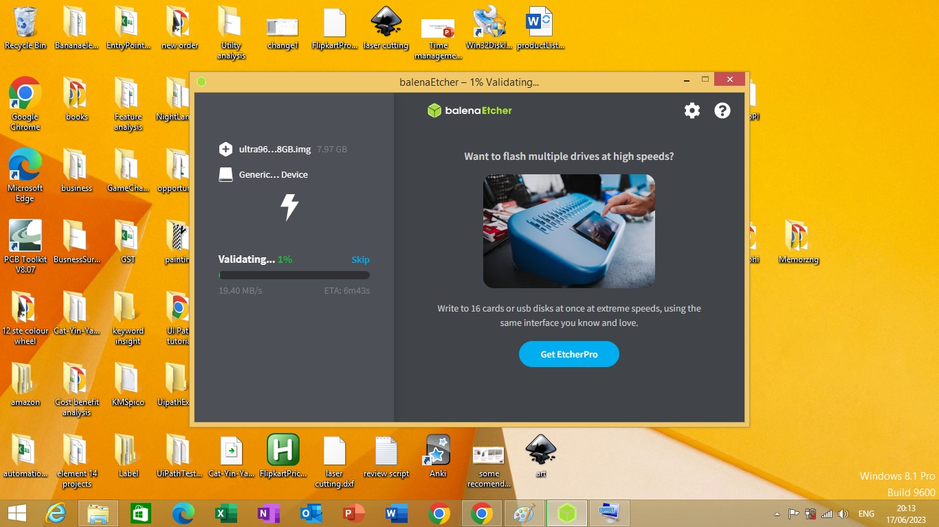

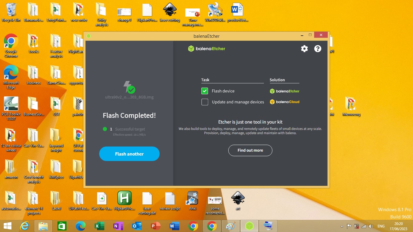

After flashing is completed the program will do a validation operation as shown in Figure 4.8
Figure 4.8
After validation the program will do the finishing step as shown in Figure 4.9
Figure 4.9
After the flash is finished it will show a dialog box that states the flash is finished as shown in Figure 4.10
Figure 4.10
After the flashing operation is finished you can remove the SD card from the SD card Slot as Operating System is flashed on the card. Your card is ready to be inserted into the SD card slot of Ultra96-v2 development board with the linux operating system in it.

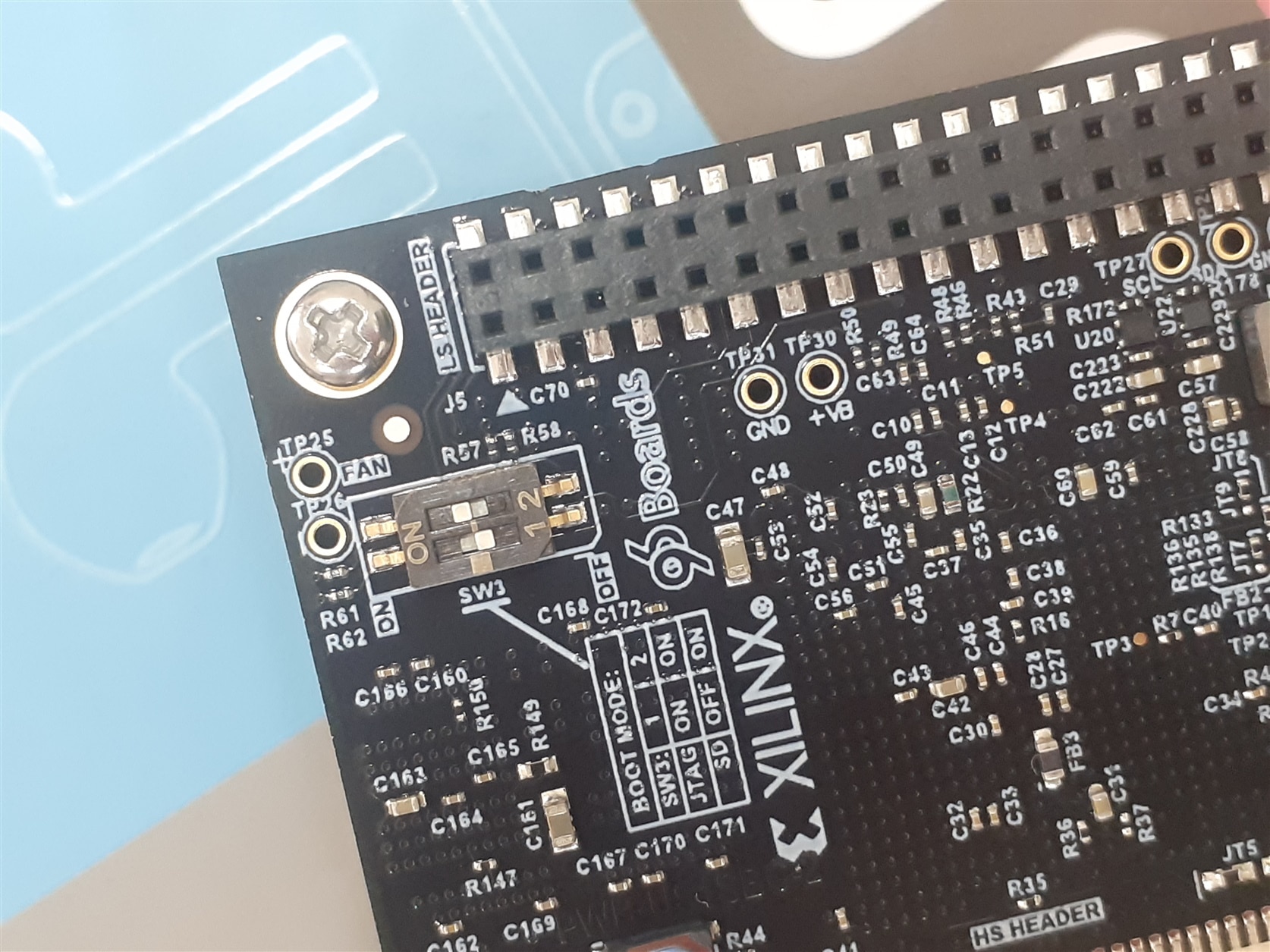

To boot the Ultra96-V2 development board. First insert the SD card that is been flashed with the Linux Operating System on the SD card socket of Ultra96-V2 development board. Than configure the boot switch to SD card boot as shown in Figure 5.1
Figure 5.1

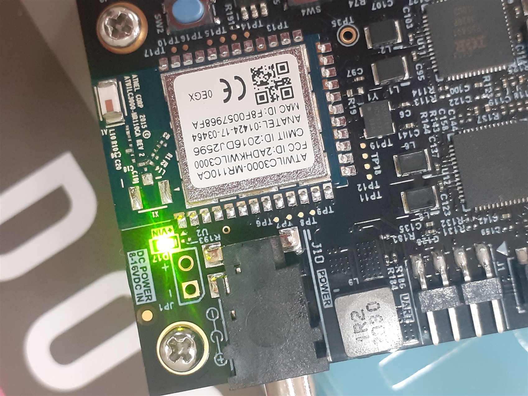

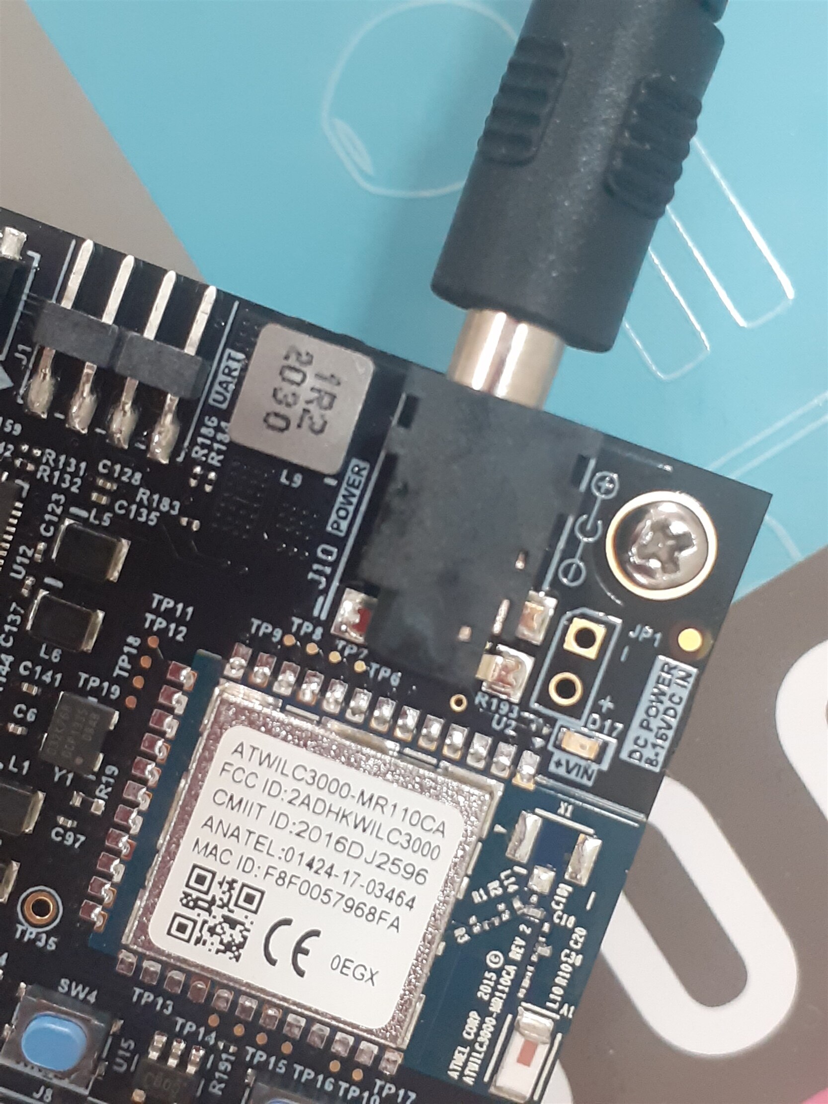

After configuring the boot switch connect the 12 volt supply to the Ultra 96-V2 board as shown in Figure 5.2
Figure 5.2

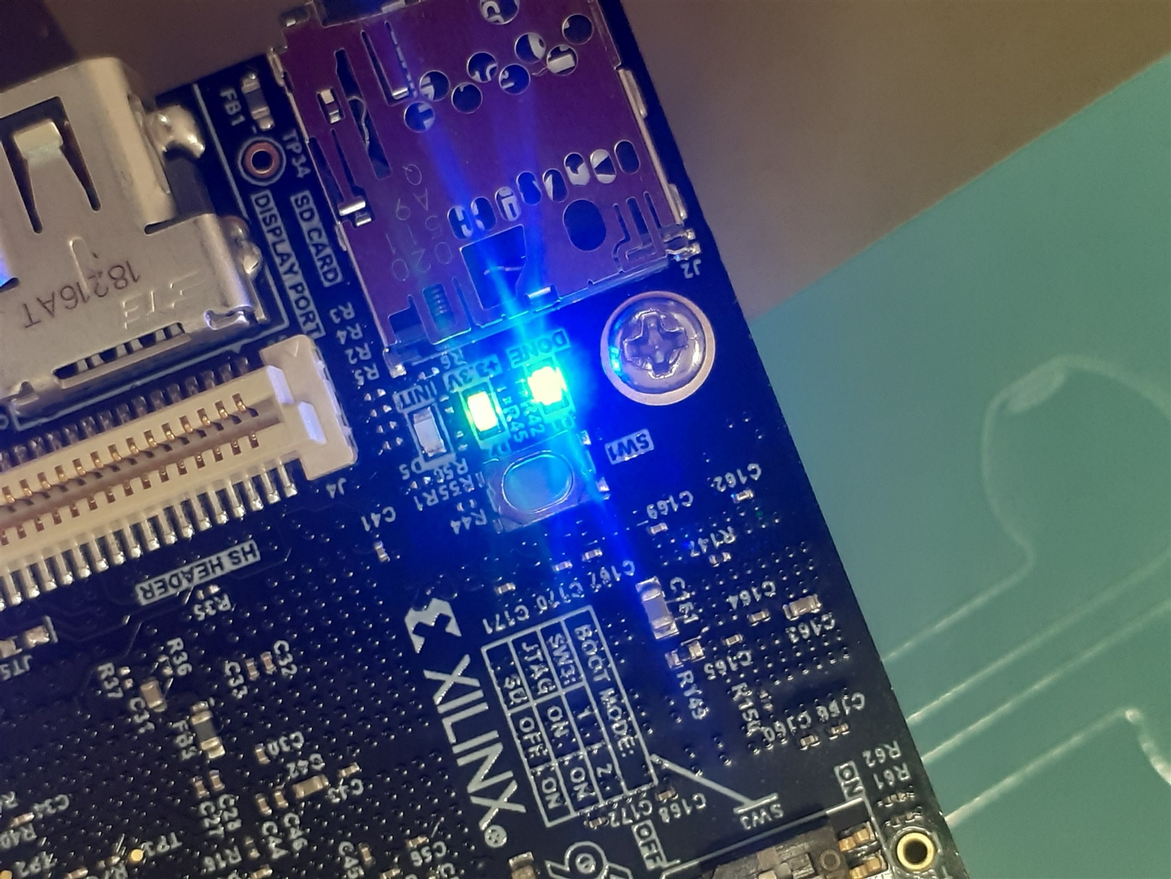

When you switch on the power the green light on the Ultra96-V2 board will illuminate as shown in Figure 5.3
Figure 5.3
To boot the Ultra96-V2 board press and release the power button switch (SW4) as shown in Figure 5.4.
Figure 5.4
The Green Power LED (D2). Red INIT_B LED (D5) and the Green User LEDs should illuminate. After a few seconds. INIT_B LED will turn off and the Blue DONE LED (D1) will illuminate. As shown in figure 5.5
Figure 5.5
The Ultra96-V2 has now booted Linux and several experiments are possible.

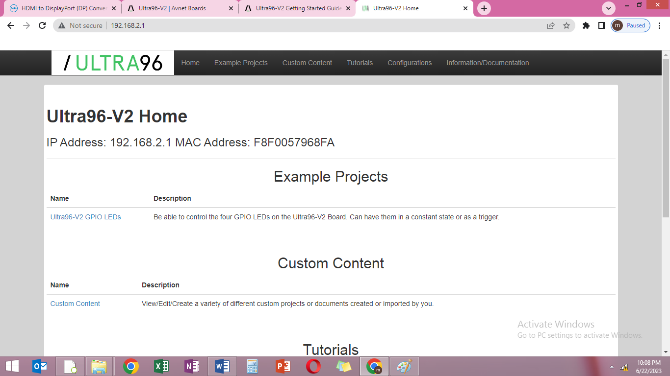

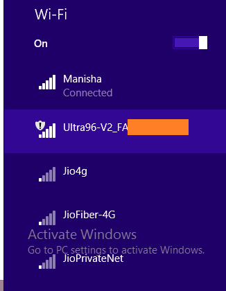

We will wirelessly connect to the Ultra96-V2 development board and play with some of LED’s of the board by switching them on or off. When the Linux boots the development board the Linux configures the board to works as a Webserver which can be accessed via Wi-Fi. The Wi-Fi name of the board is “Ultra96-V2_<MAC ADDRESS> ”. To access the board via Wi-Fi, login to the board via laptop or desktop using Wi-Fi by connecting to the “Ultra96-V2_<MAC ADDRESS> ” as shown in Figure 6.1
Figure 6.1
Connect to the “Ultra96-V2_<MAC ADDRESS> ” via Wi-Fi using laptop or desktop. After connecting to the Ultra96-V2 development board webserver. open a browser on the connected machine, and browse to the IP address of the board, which is http://192.168.2.1. The browser page will show like Figure 6.2.
Figure 6.2
The LED we are going to play with are D3, D4, D6, and D7 as shown in Figure 6.3
Figure 6.3

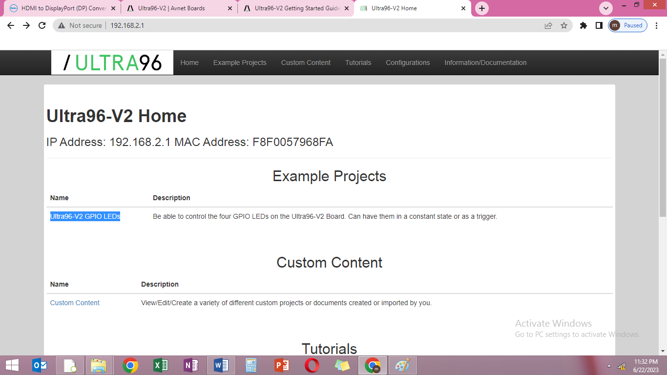

The project that allows us to play with D3, D4, D6, and D7 LED is known as “Ultra96-V2 GPIO LEDs” as shown in Figure 6.4
Figure 6.4
Click on the “Ultra96-V2 GPIO LEDs” project to start the project as shown in Figure 6.5
Figure 6.5
You can change the status of the LED by using drop down menu for each LED. You can turn LED ON/OFF or you can use it to show status of various resources in the development board. Figure 6.6 depicts how to turn on the LED.
