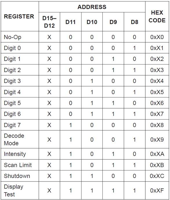

The MAX7219 Peripheral
The MAX7219 IC is a "Serially Interfaced 8-Digit LED Display Driver", which interface is based on SPI, with an specific protocol for configuration and data management. According to the datasheet, the IC starts with all registers in reset state and the data registers in blank. This means that the display will show nothing when it is powered up. The Address Map connotes that we could have other processor, but the state machine brings the behavior of the system according data handled in the SPI communication.
You must start the communication, send the register to be modified, and the data to be recorded. This brings data representation over 7 segment displays. Remember that the MAX7219 has a power and logic levels of 5V, but don't worry, you can change the voltage levels on the Mezzanite board using the VDD SEL switch. The VREF SEL changes the analog reference for the ADC.
The Software
The new software must be able to encode and send the information to the device since the SPI peripheral only stablishes the communication port, but not the correct interpretation of the information. This think carries the following header file.

here, all the available commands on the MAX7219 are defined by macros. We must include the xspips.h since there are the definitions of the SPI controller on that archive. The definitions of each function are shown below.
