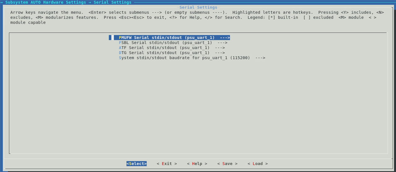

Configuraiton of hardware settings
With in the hardware setting, we can modify memory, serial port, flash (if available), SD card settings.
In our case the UART1 is selected by default as that is the only UART available in the design.

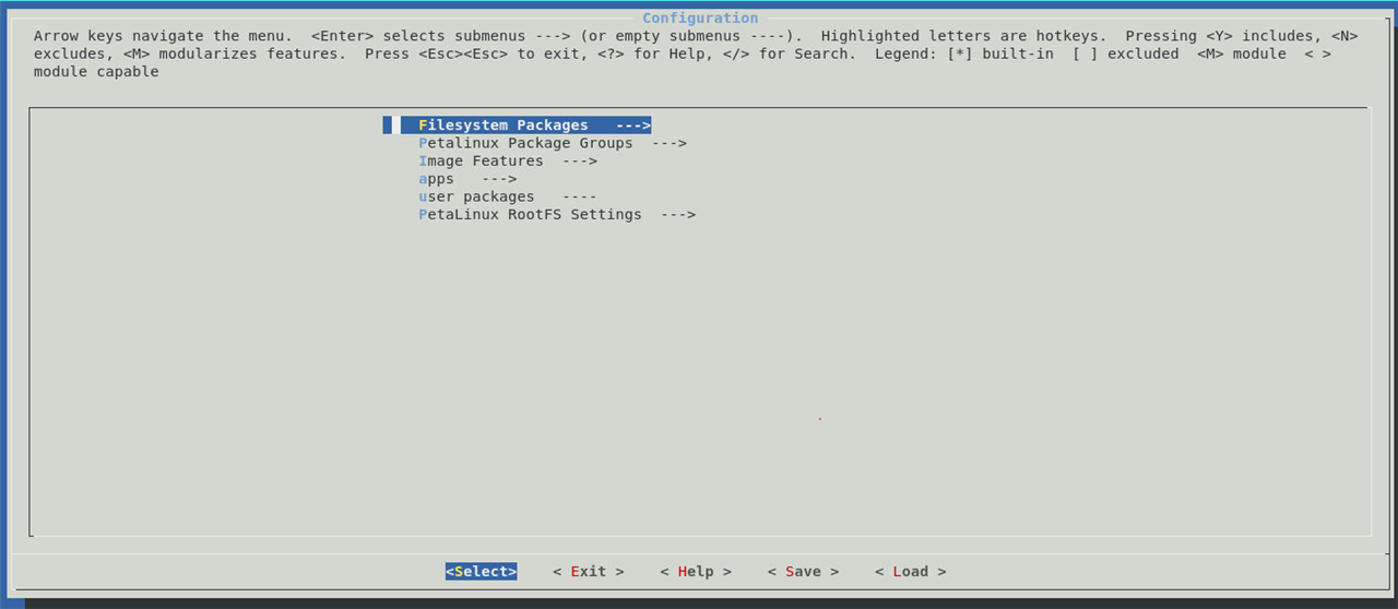

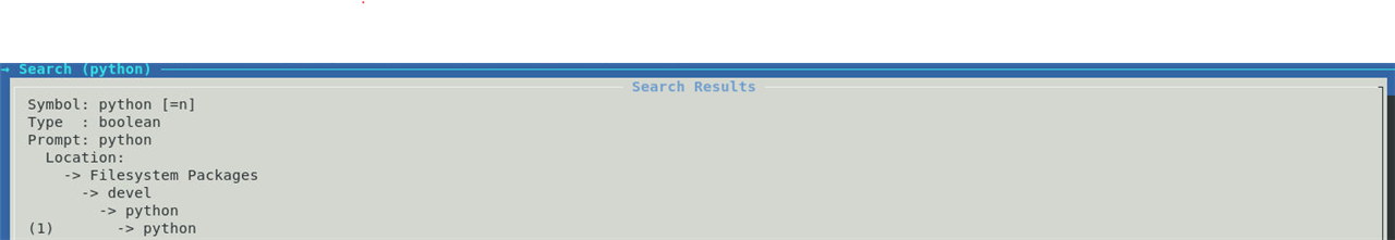

petalinux-config for Root Filesystem:
When you run petalinux-config -c rootfs, it opens the menu configuration interface specifically for the root filesystem. Here, you can add or remove user-space packages, libraries, and applications that will be included in the final Linux image. You can also set up system initialization scripts, configure network settings, enable/disable services, and more.
Example:

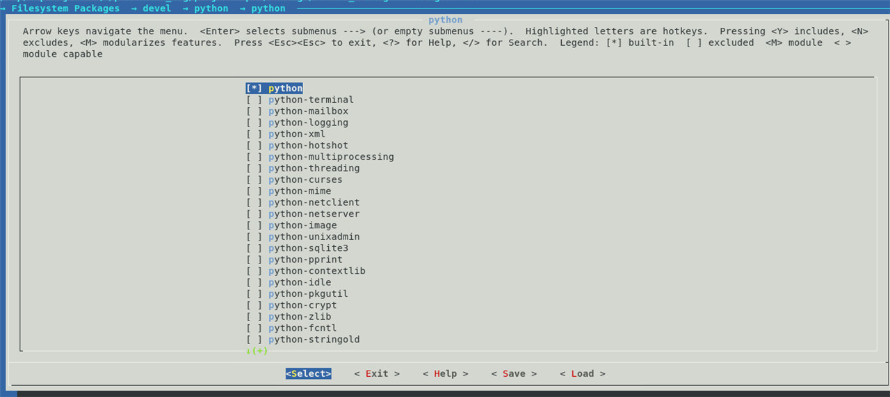

In the menu interface, navigate to "Filesystem Packages" -> "misc" and select "nano" to include it in the root filesystem.
rootfs configuration (adding python) example
On the menu config, we have to select the Filesystem packages which includes various libraries and useful packages
We are specifically interested in python package, so we can search for it using "/" command in the menuconfig and typing python
This shows the list of matching packages and their location.
We can then trace the location and enable the package by pressing the "space button in keyboard", which result in "*" selection

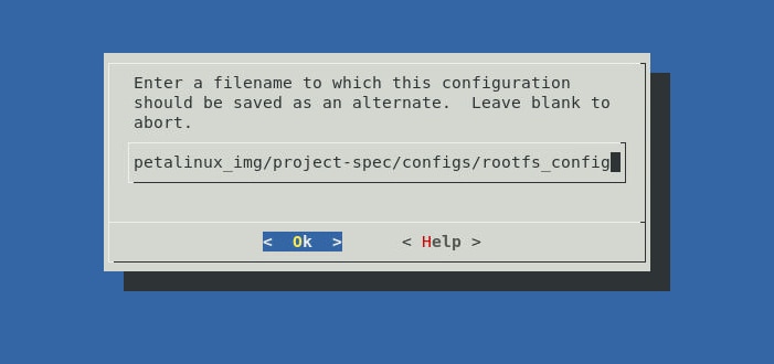

You can save the settings and then start a petalinux-build to get an image with your required modifications

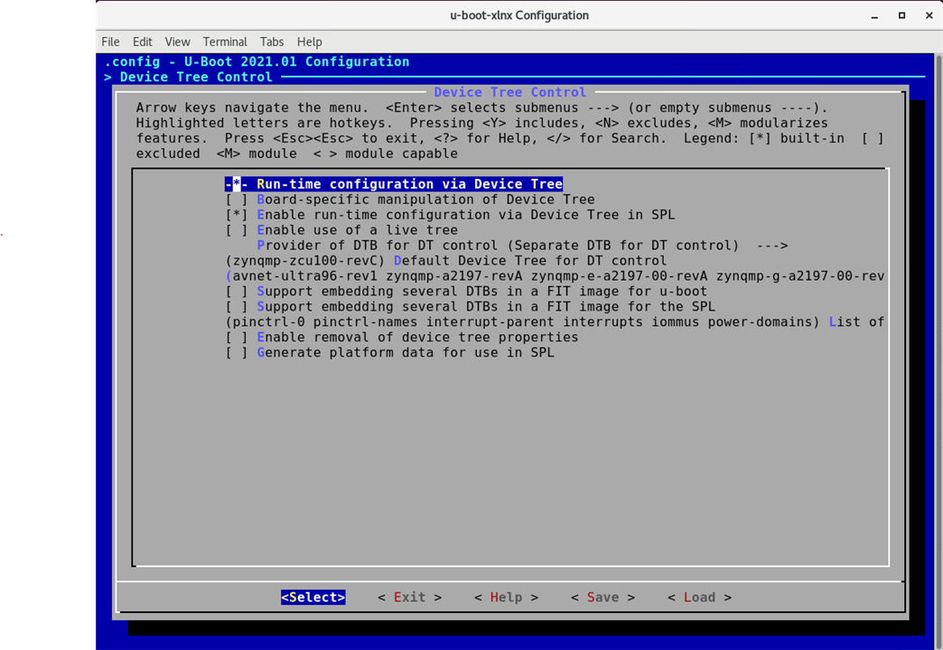

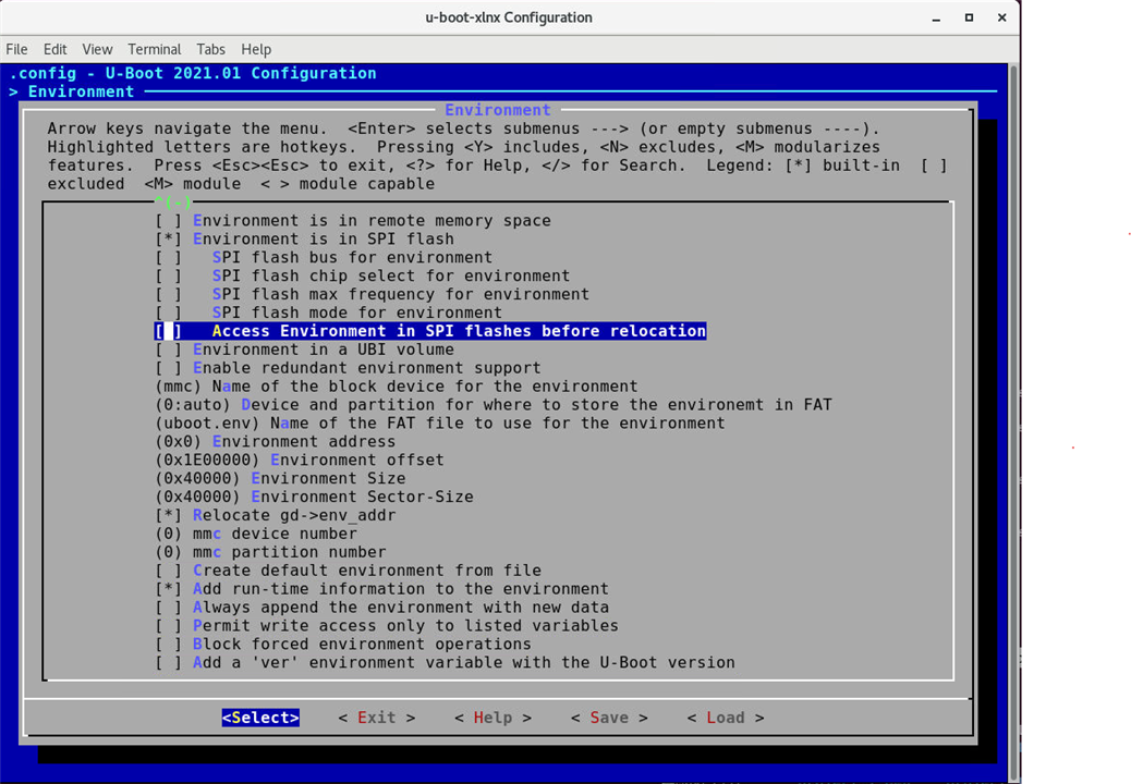

petalinux-config for U-Boot:
For U-Boot configuration, you can use petalinux-config -c u-boot. This allows you to customize the U-Boot bootloader settings, such as boot arguments, boot order, environment variables, and other board-specific configurations.
Example:
To modify the U-Boot environment to set the bootargs:
It takes a bit of time before the menu interface appears.
In the menu interface, navigate to "U-Boot Configuration" -> "Environment variables" and set the desired bootargs.
u-boot configuration example
Shows the u-boot menu config and the plethora of options available to customize
I have just shown the example for modifying the run time device tree configuration.
You also have the options for changing the u-boot environment by changing its size, offset etc.

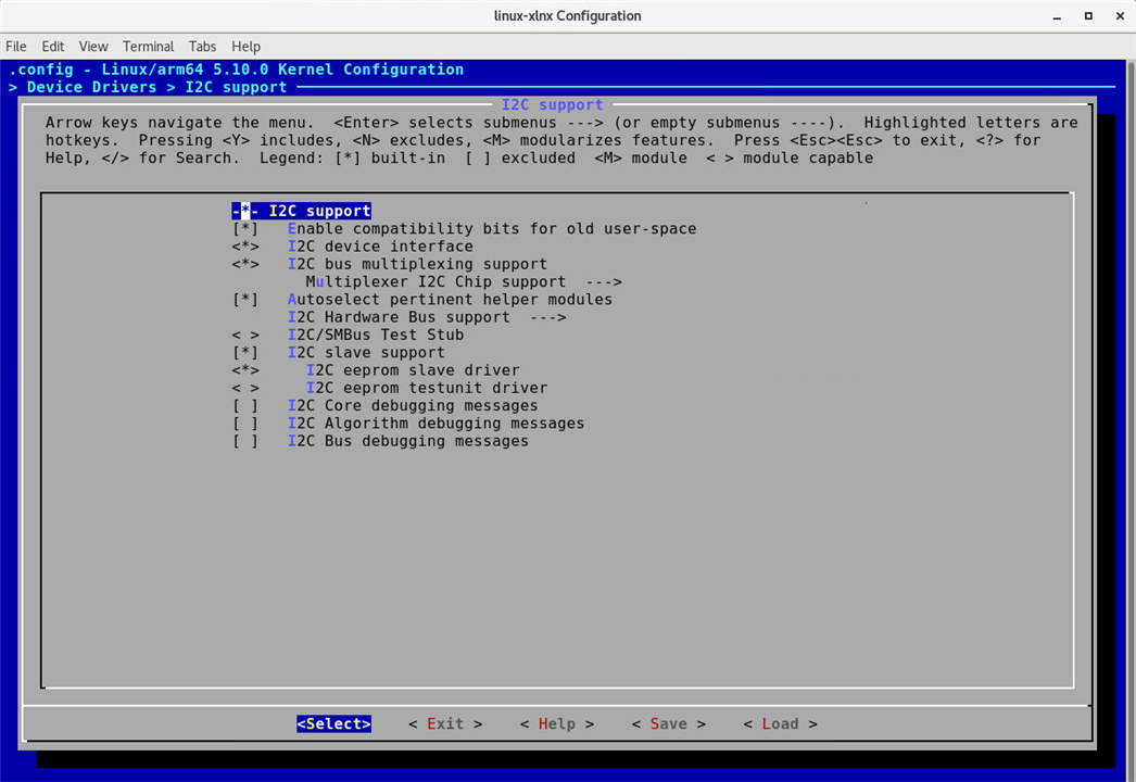

petalinux-config for Kernel:
For kernel configuration, the command is petalinux-config -c kernel. This opens the Linux kernel configuration menu, where you can enable or disable kernel features, drivers, and other options relevant to your hardware and application requirements.
Example:
To enable support for a specific hardware driver, e.g., I2C driver:
In the menu interface, navigate to "Device Drivers" -> "I2C support" and select the appropriate options.
config kernel options
Similar to u-boot, kernel also has a lot of features that you can enable (showing a sample menuconfig).
A simple example is to enable the i2c support, so that it enables drivers that allows you to talk with i2c compatible device
Another useful kernel config is to enable device drivers for specific networking device. In this case some wireless and bluetooth drivers are enabled by default.
Once you make the necessary configurations using the petalinux-config command, you can save the changes and exit the interface. After that, you typically run petalinux-build to build the project with the updated settings. Keep in mind that the specific options and menu structure may vary depending on your petalinux version and project configuration. Always refer to the official documentation for the version you are using for the most accurate instructions.
