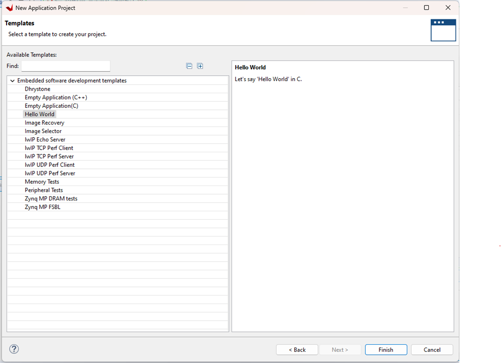

A simple hello world Vitis application for minimalistic build:

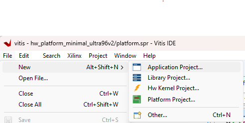

Let us start with a simple hello world application. To create a application select File -> New -> Application Project
Selecting the .xsa file that is corresponding to the minimalistic hw design file that was created in Blog 2.
Providing the name for the project that is clear and precise.

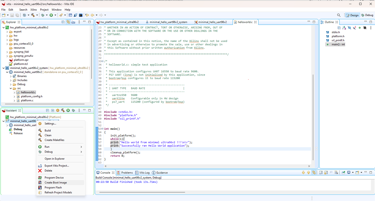

Vitis provides various application templates that we can choose from. In this case we will be choosing the Hello World template.  We can start from an empty application as shown in the tutorial too or any other template based on your interest.
After selecting a template, we also have the ability to modify the template based on our needs. This is very useful for customisation. I have changed the text for the print for this case.

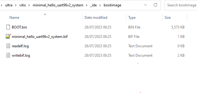

The next step is to build the project and create the BOOT.BIN file so that it can be loaded into the SD card for the SD card boot mode. We can also switch the mode pins to select the JTAG boot mode and program it via JTAG. Since I wanted to test the SD card boot mode, I will stick with the default setting.
Make sure that the Boot image was successfully generated as shown in the console output.

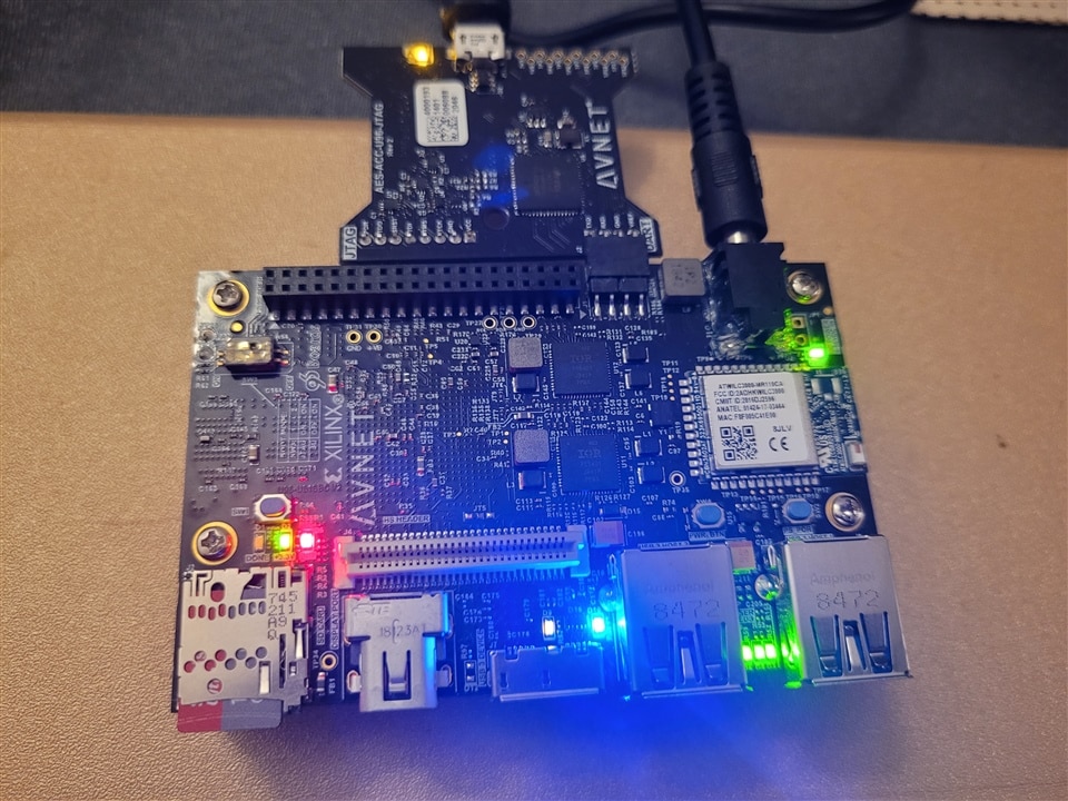

The next step is to copy the BOOT.Bin image to an SD card and try it on the unit.
The last step is to test the BOOT.bin on the board and make sure it prints as expected.

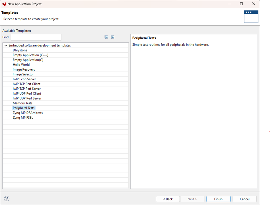

Application to do Peripheral tests
I just following the standard steps for building an application. In this case, I chose the Peripheral tests template.
The tests ran  a dozen self tests as expected. It also monitored the temperature of the system using sysmon. So overall happy with the state of affairs for this test.

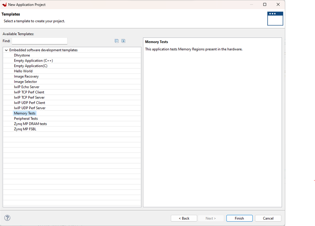

Memory Tests:
I tried to do the memory tests by selecting the Memory Tests template and proceeded with building the application and generating the SD card outputs.
The UART console shows that code didn't proceed beyond the FSBL stage. So the memory tests couldn't be run. I remember during the training section there was a topic specifically intended to show where the application is supposed to run. In the current state, the application is supposed to be running in the OCM, it was not clear if the application needs to be run from the DDR. I expect it should not be running from the DDR as we are intending to test the DDR. I will  have to investigate this further.  Would be interesting to know if any other participant tried the DDR tests on the Ultra96-v2 board and successfully ran the memory tests.
▒Xilinx Zynq MP First Stage Boot Loader
Release 2021.2   Jul 26 2023  -  00:10:22
The FPGA board was also not in a happy state as the INIT led were all red :-(
