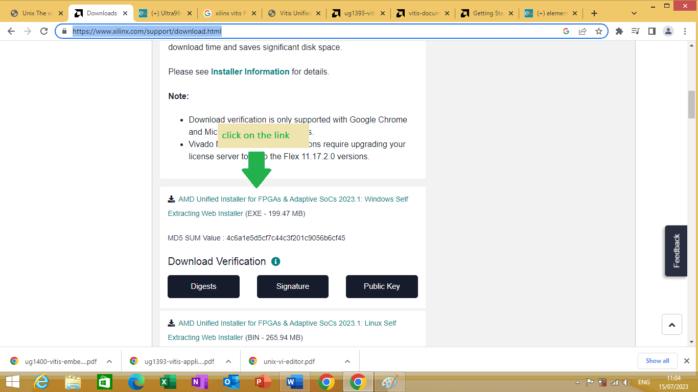

Installation of Vitis unified development platform for embedded project
Based on training platform we have gone through on element 14 they say that we need atleast 2 software installed on our system to get started i.e
  • AMD-Xilinx Vitis Core Development Kit
  • Vivado ML Edition
To download Vivado ML edition.
Click on the link given https://www.xilinx.com/support/download.html
A page will open as shown in figure 1.1 bellow
Figure 1.1

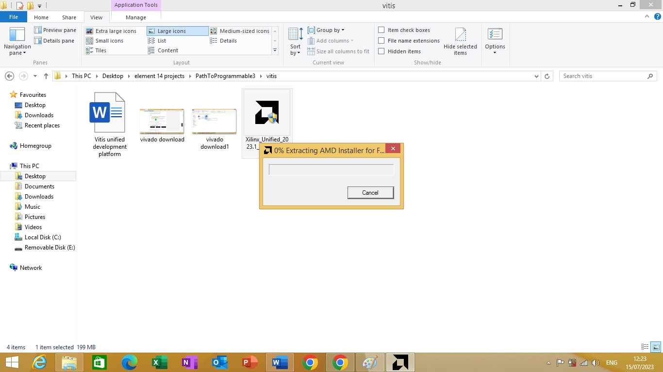

Click on the link to download vivado ML for windows system.

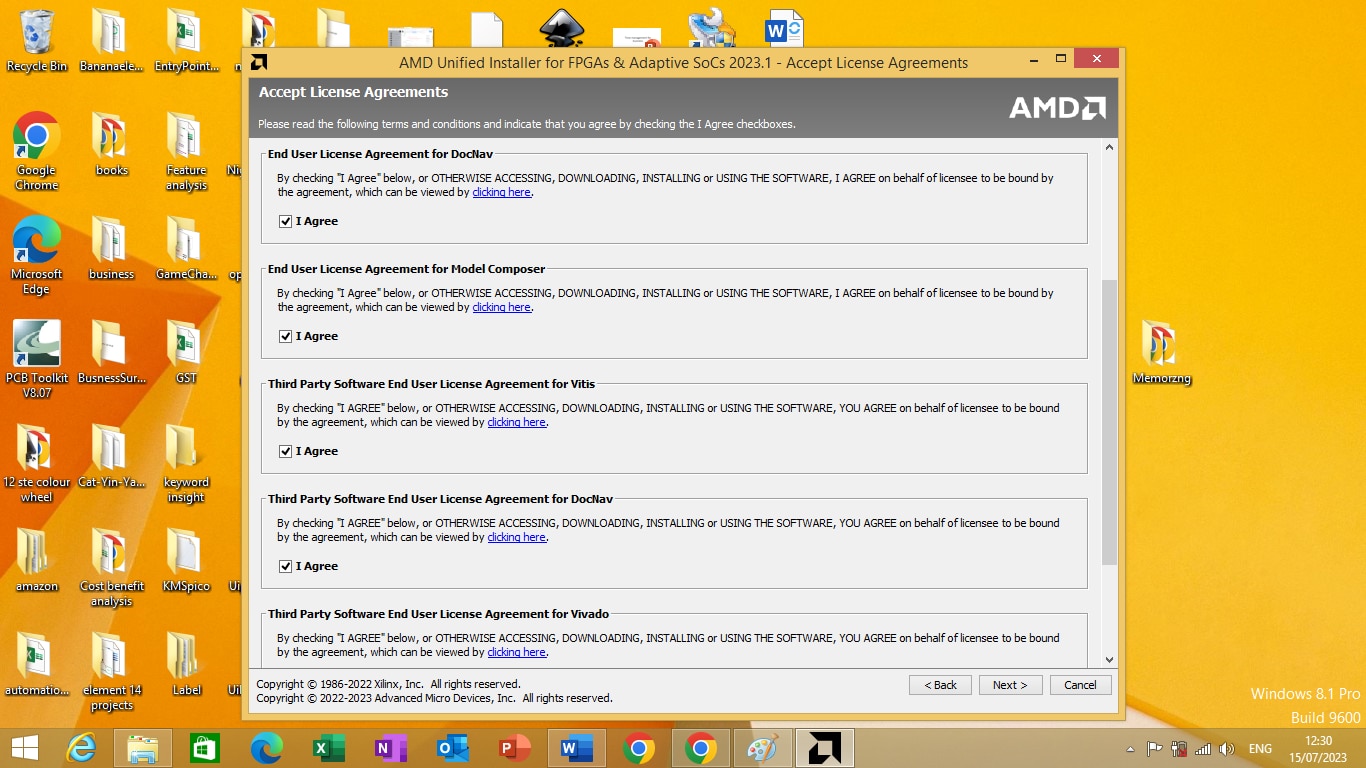

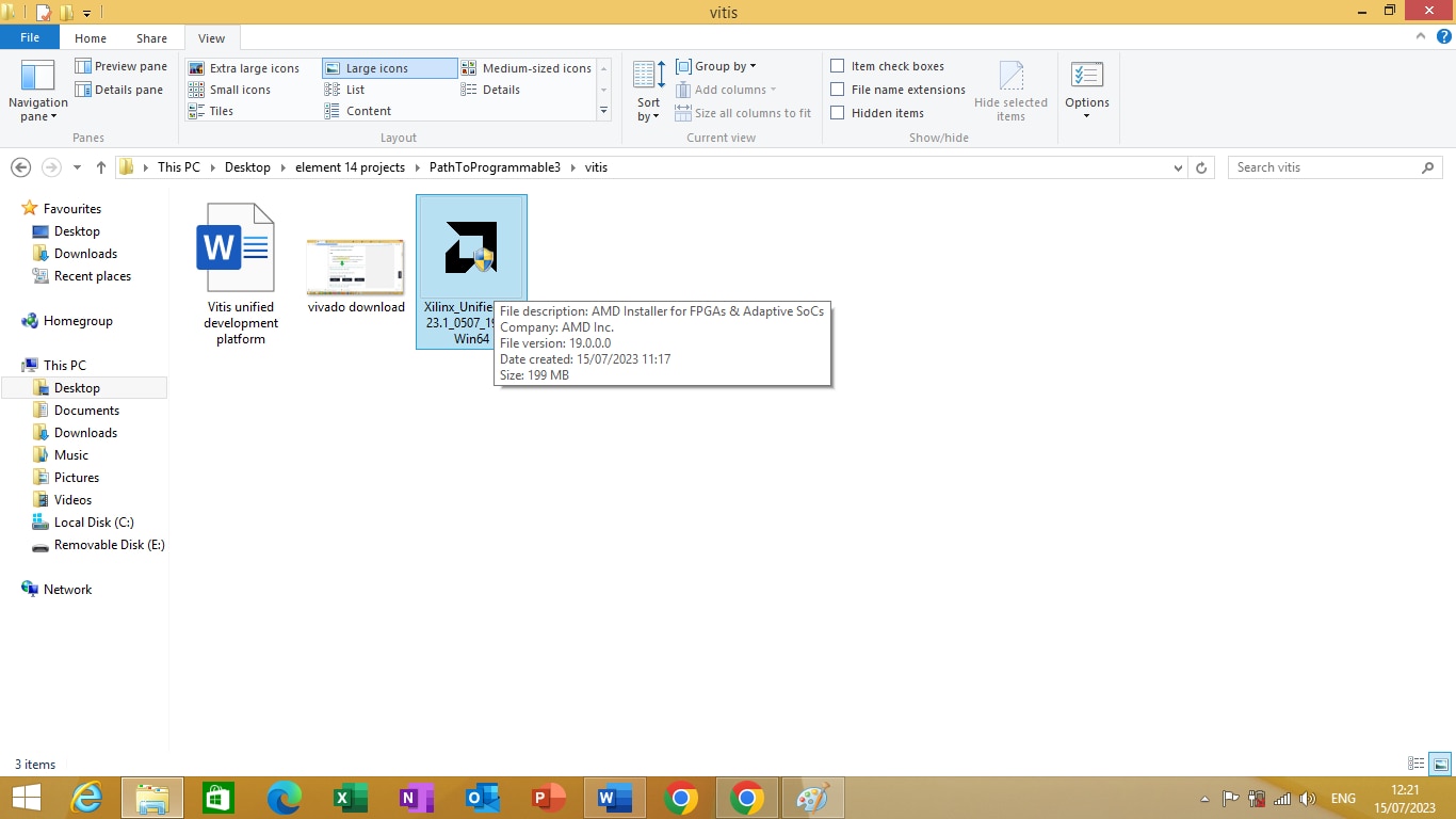

After downloading it, you have to install Xilinx_Unified_2023 on your system. To install it ,double click on the setup program as shown in figure 1.2 bellow.
Figure 1.2

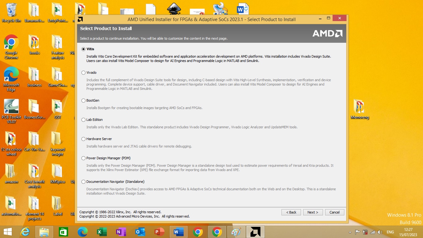

After double clicking on it. Setup will start as shown in figure 1.3 bellow
Figure 1.3
Choose Vitis Core development kit installation as shown in figure 1.4 bellow
Figure 1.4
After choosing vitis core platform click next. In license and agreement choose all the license as shown in figure 1.5 bellow
Figure 1.5
After clicking “I Agree” click next to download the vitis core platform and install it.

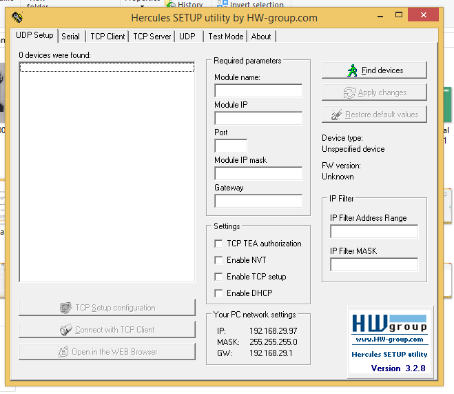

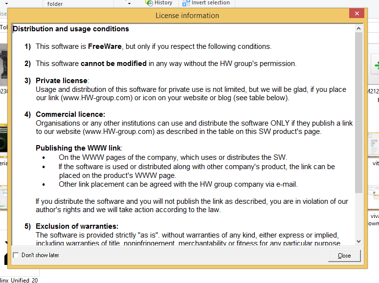

We are going to download and install ‘Hercules serial port’ software for our serial port application. To download the  software follow the link given bellow
https://www.hw-group.com/software/hercules-setup-utility
In the above link click on the download button as shown in figure 2.1 bellow
Figure 2.1
After downloading the software you have to install the software. To install the software double click on the ‘hercules_3-2-1’ application as shown in figure 2.2 bellow
Figure 2.2
After double clicking on the setup application software, hercules setup will start as shown in figure 2.3 bellow
Figure 2.3
Complete the installation by following the instruction given by the setup appropriately.

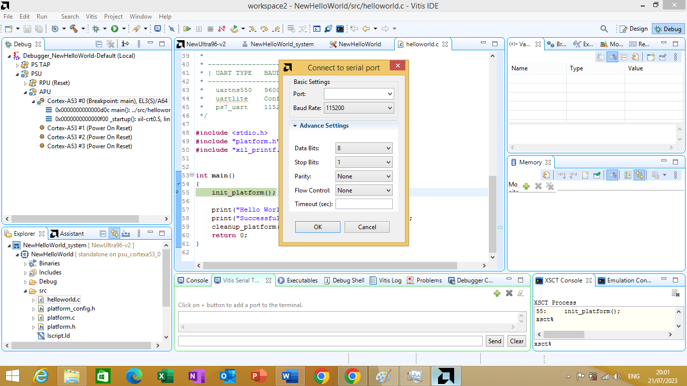

Click on serial tab to start the serial port applications as shown in figure 2.6 bellow
Figure 2.6
connect the USB-to-UART/JTAG Pod to the computer via USB cable as shown in figure 2.7 bellow
Figure 2.7
Know you need to figure out the virtual comp port to which your USB to JTAG/UART is connected to.
To know about the COM port no, open device manager from control panel connect the USB to JTAG/UART pod to the USB physical USB port you will see a COM port with number appearing on device manager as shown in figure 2.8 bellow
Figure 2.8

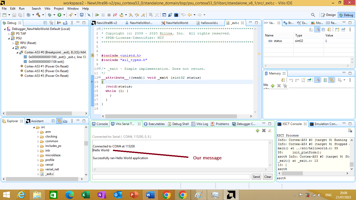

Know we can test weather the USB to JTAG/UART pod is working properly or not. In serial tab in name mention COM4 as shown in figure 2.9 bellow and click open button on the screen. You will get serial port com4 open Received/send data window
Figure 2.9

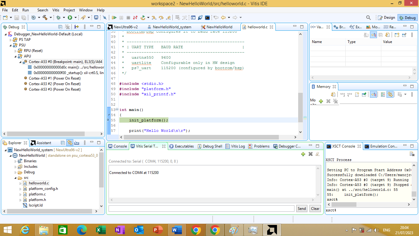

Vitis IDE project execution
There are 5 steps involved for creating a project in Vitis IDE
  • Create workspace
  • Create Platform
  • Modifying BSP
  • Create Application Project
  • Deploying Hardware

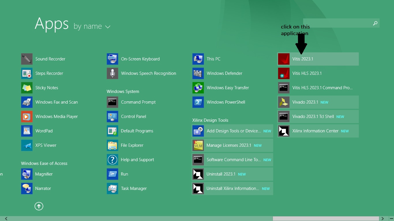

Launching the Vitis IDE

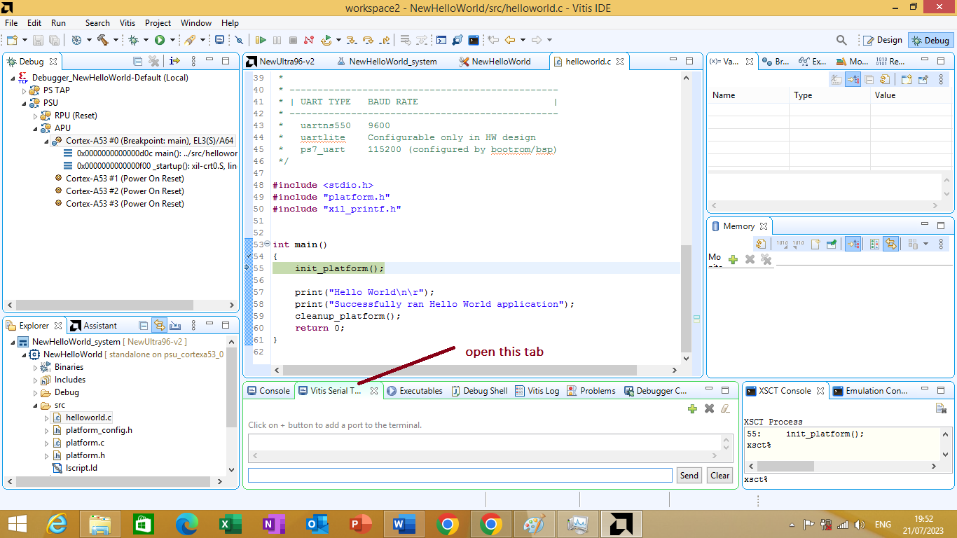

In this section we are going to create a sample application name hello world using Vitis IDE. To start creating application you have to first Launch the vitis software platform as shown in figure 3.1 bellow.
Figure 3.1

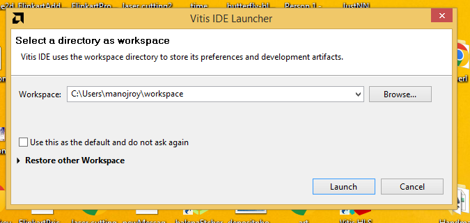

After clicking on ‘vitis 2023.1’ a dialog box will open as shown in figure 3.2 bellow on it you need to create a workspace and than click on launch button.
To create workspace edit the workspace name on 'C:\Users\manojroy\workspace' to the name you wish. We will edit it's name to  'C:\Users\manojroy\workspace2'
Figure 3.2

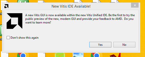

The following IDE will be displayed as shown on figure 3.3 bellow
Figure 3.3
Click on No button to start the Vitis IDE. The vitis IDE can be seen in figure 3.4 bellow
Figure 3.4

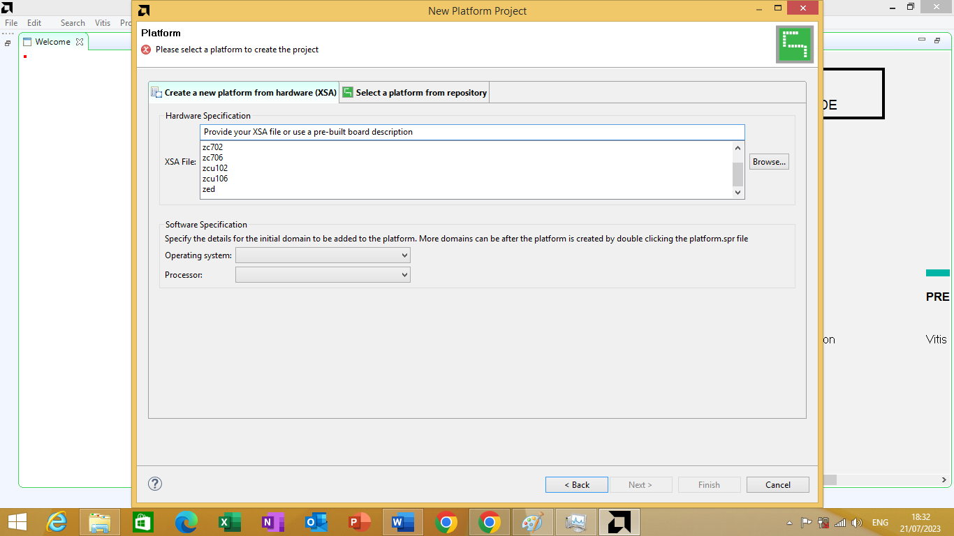

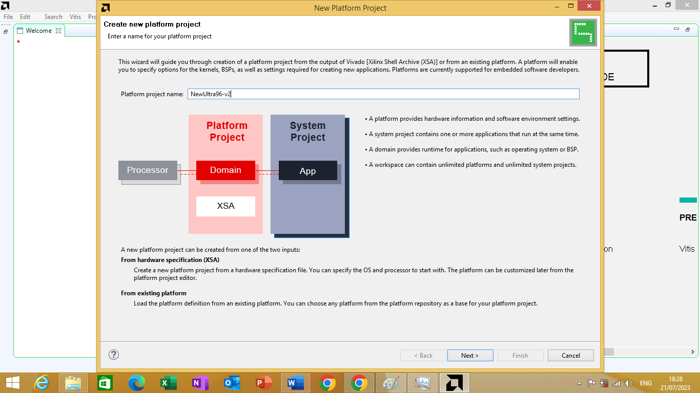

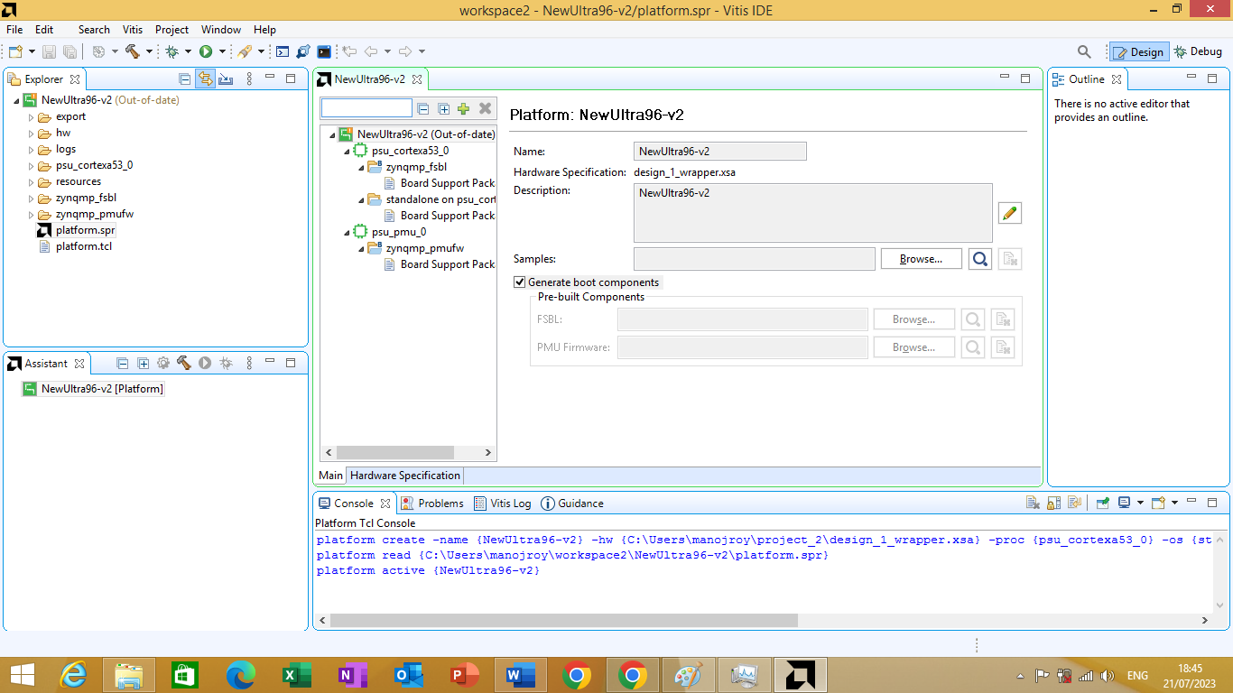

Platform Project
Know we will create platform project. As this is the second step in creating application using Vitis Platform. To create platform project Click File -> New -> Platform Project
As shown in figure 3.5 bellow
Figure 3.5

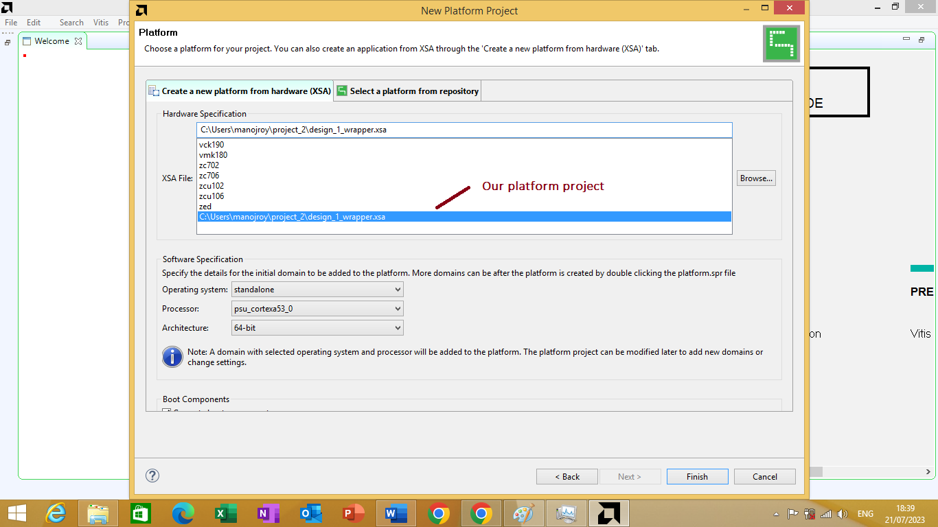

After clicking on it 'create a new platform project' window will open as shown in figure 3.6 bellow on it mention the desired platform name as you wish. We will mention platform name is 'NewUltra96-v2' than we will click next.
figure 3.6

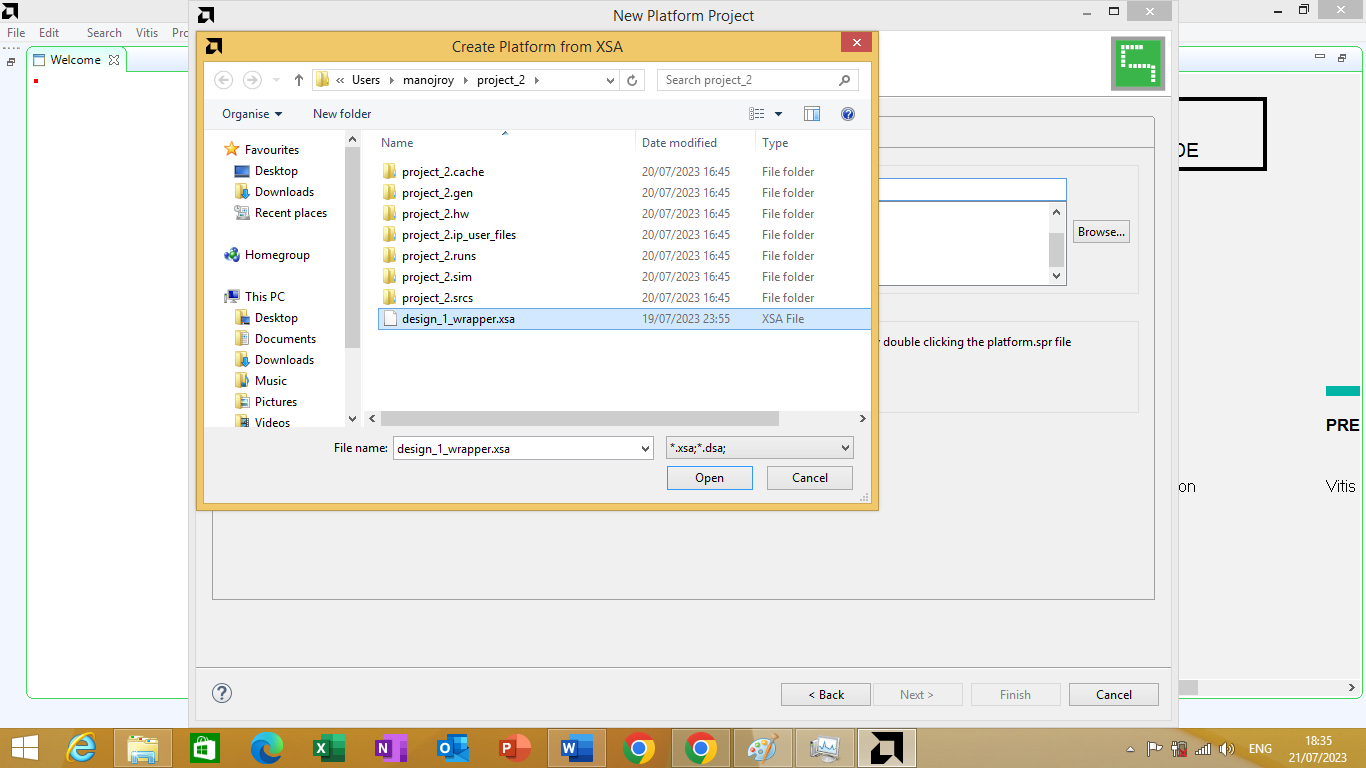

A platform window will open. In it we are going to use our own custom platform we have created. We will click on "Created a new platform from hardware (XSA)" option. As shown in figure 3.7 bellow.
Figure 3.7
Click Browse to locate and select the .xsa file we have exported from Vivado as shown in figure 3.8 bellow
Figure 3.8
Our hardware platform project is known as 'design_1_wrapper.xsa'. After clicking on it, we will click open. it will appear in the list along with the previously populate generic platforms. As shown in figure 3.9 bellow.
Figure 3.9
we will click on finish button to open the custom platform on vitis IDE as shown in Figure 3.10 bellow
Figure 3.10

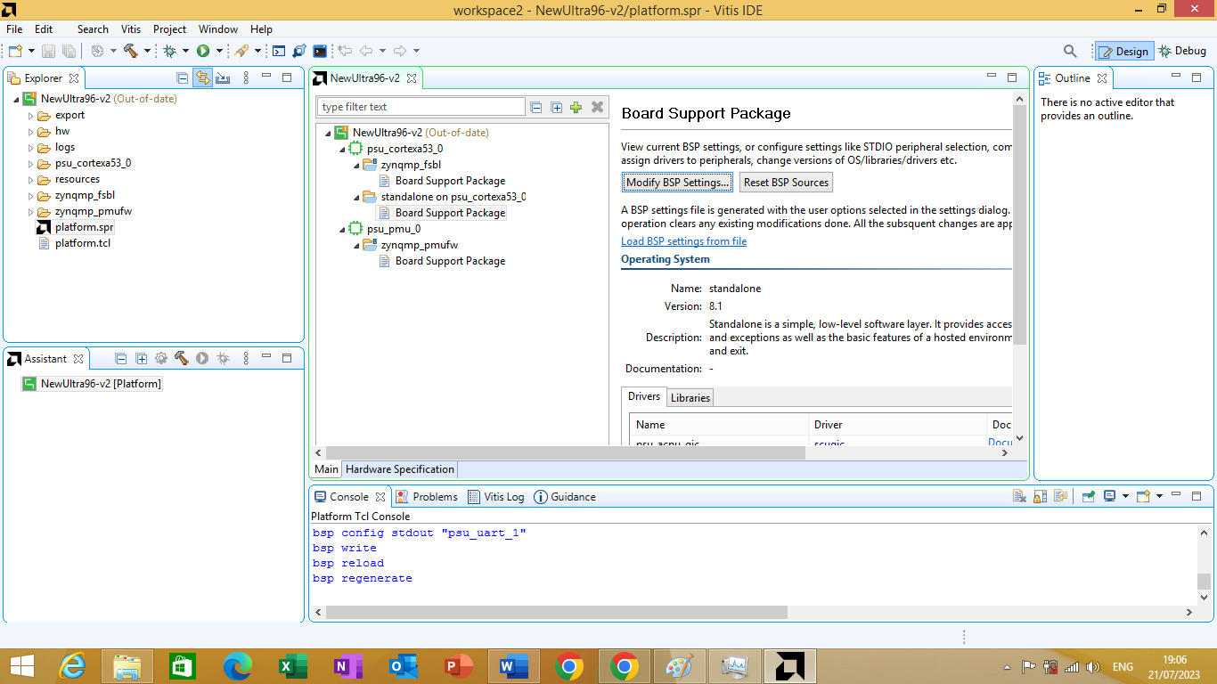

Modifying BSP
By default the BSP (board support package) uses UART0 for the standard input and outputs (known as "stdin" and "stdout"). These are the devices used by our application that we have created for Cortex A53 processor to send or receive data from the console.  From the Ultra96v2 schematics and Zynq MPSoC settings in Vivado we can verify that it's the UART1 that is actually connected to the JTAG UART on the Ultra96v2 board. So we need to update this in our BSP.
To do this click on board support packages as shown in figure 3.11 bellow
Figure 3.11
After clicking on it board support package window will open as shown in figure 3.12 bellow
Figure 3.12

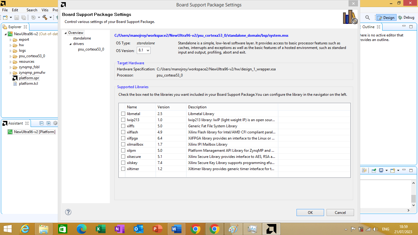

On it click on 'Modify BSP Settings' button. After clicking on it 'Board Support Package Settings' window will open as shown in figure 3.13 bellow
Figure 3.13

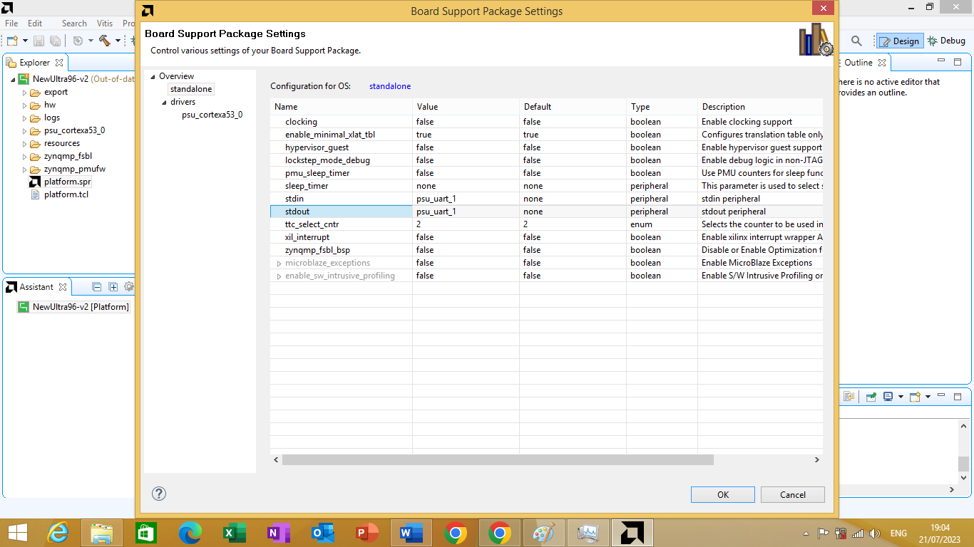

On the left side , click "standalone" category as shown in figure 3.14 bellow
Figure 3.14
Now you can see the stdin and stdout parameters, which are both set to psu_uart_0 currently. change both of them to psu_uart_1. As shown in figure 3.15 bellow
Figure 3.15

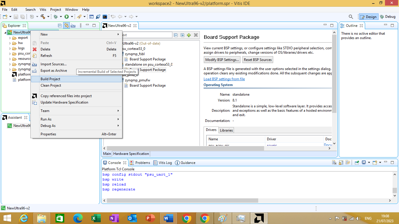

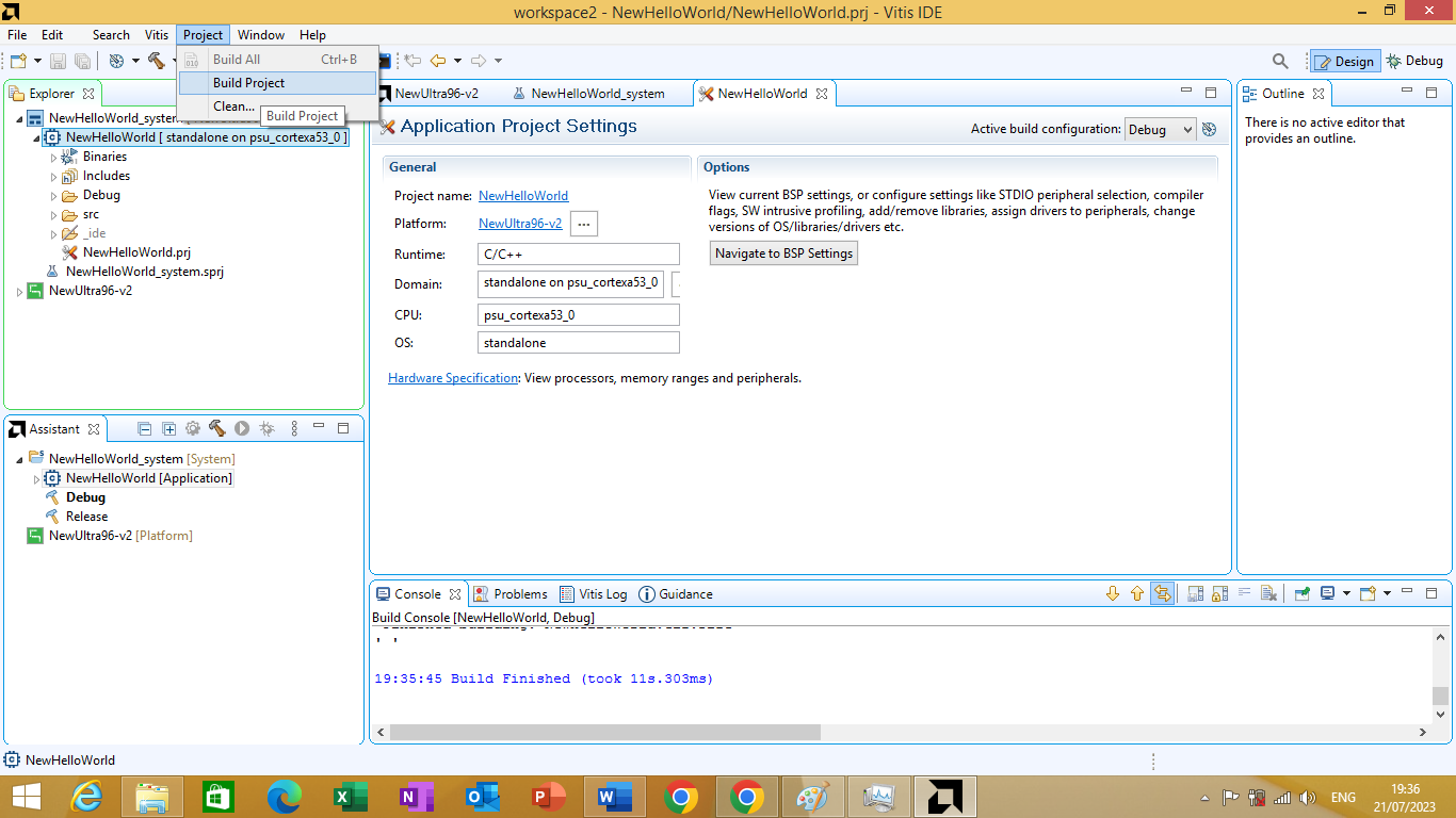

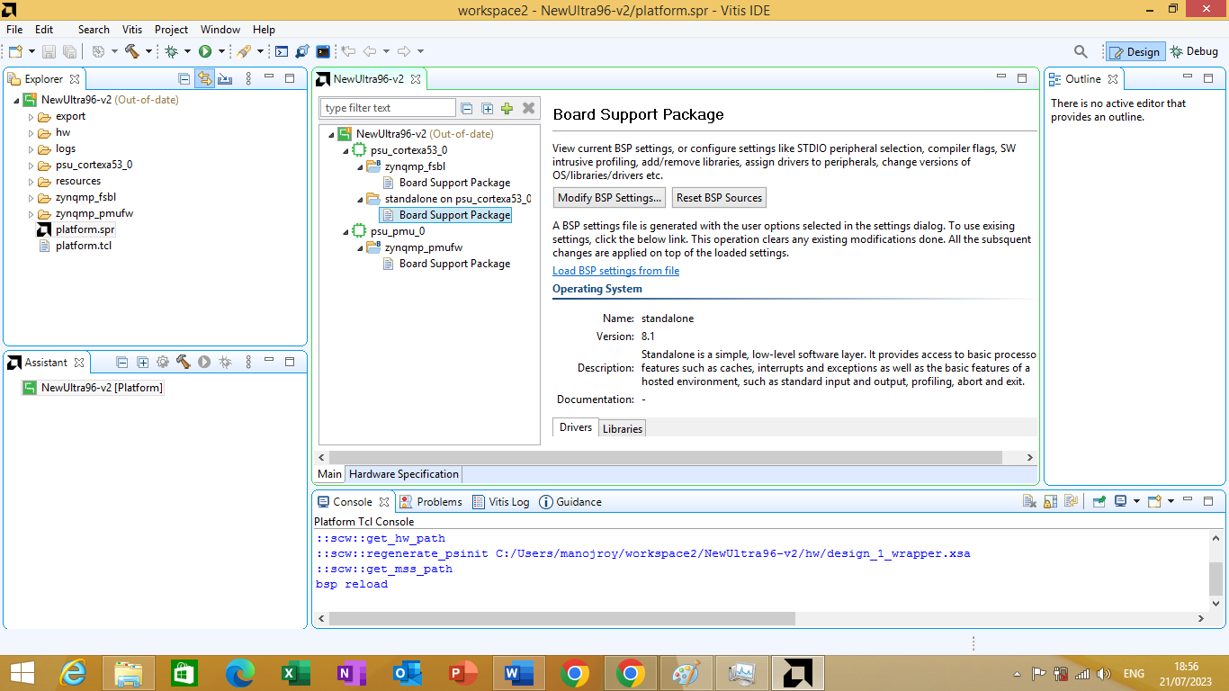

And then click Ok. we can observe that out Platform project is showing to be "out-of-date". As shown in Figure 3.16 bellow
Figure 3.16
To fix it, we right click the platform project name, and click "Build Project". As shown in figure 3.17 bellow
Figure 3.17
After the project is build you will no longer see 'out-of-date' anymore.

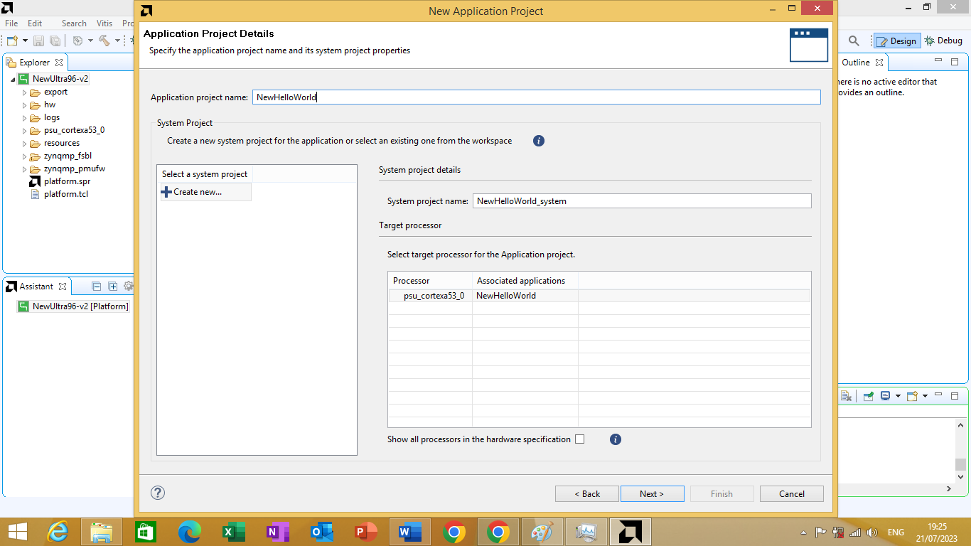

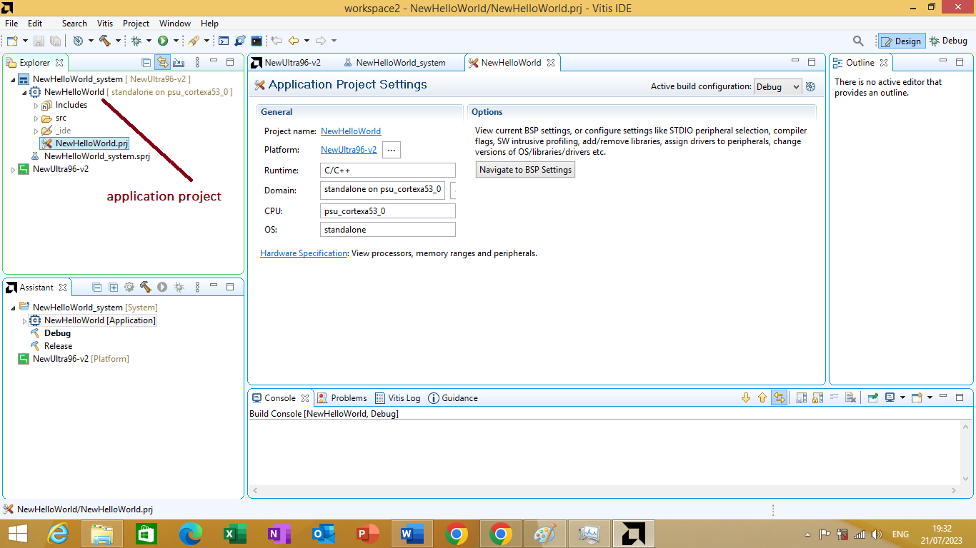

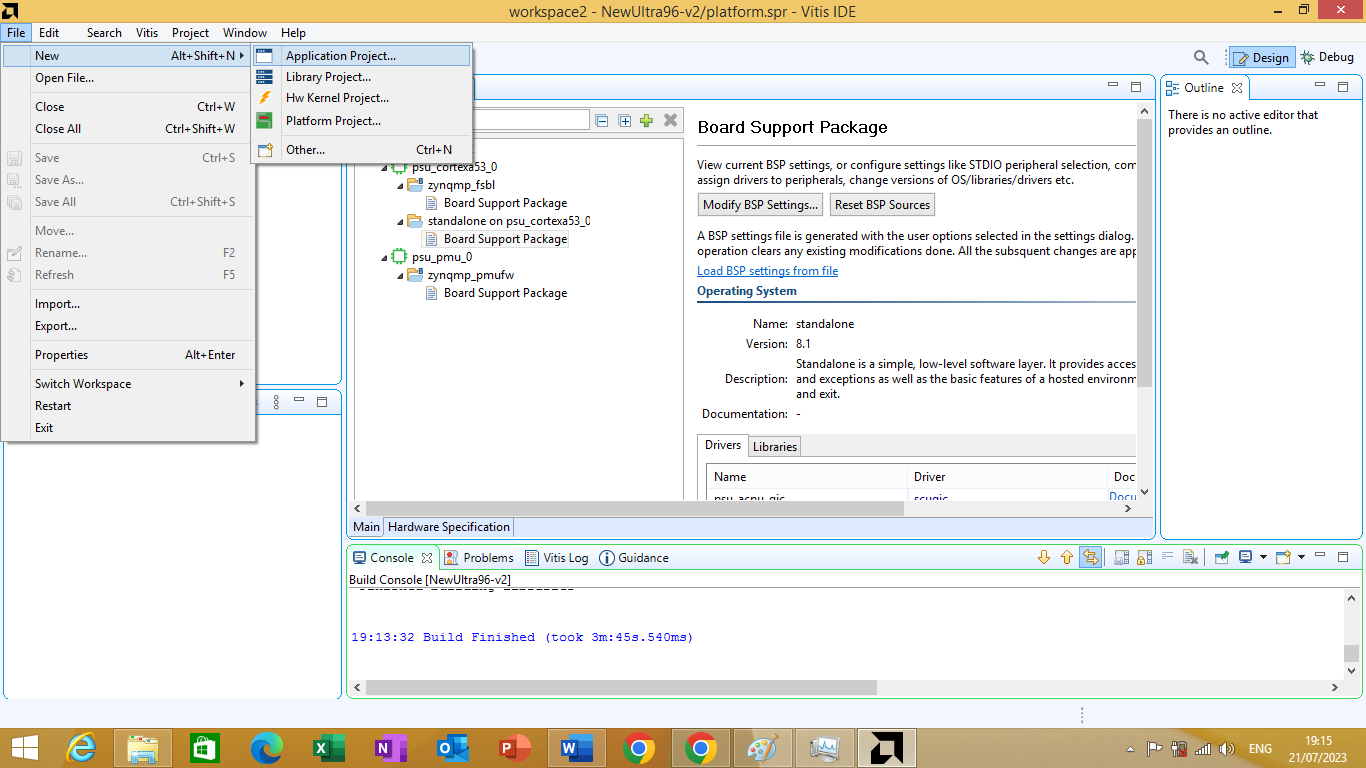

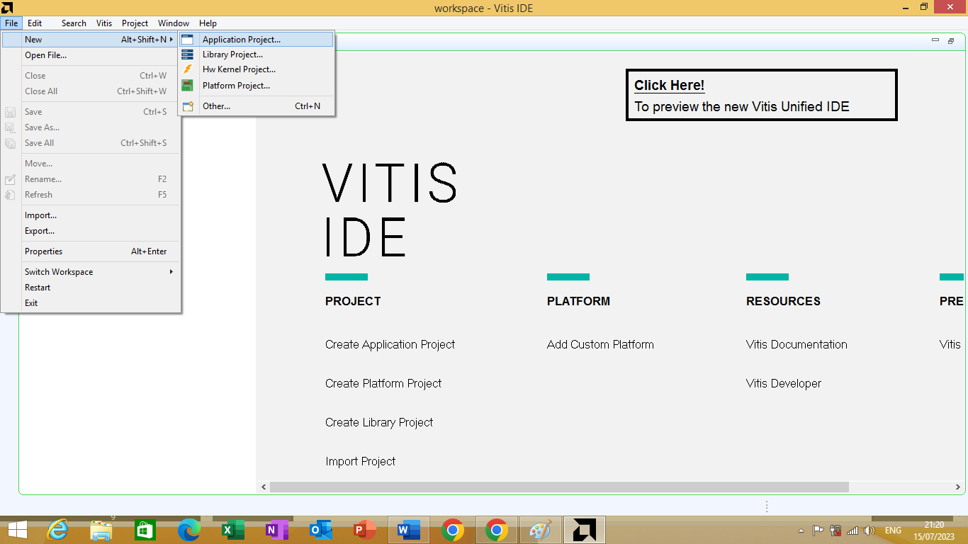

Application Project
Since the platform from project is created know we can build application project. In the Main Vitis window, click File -> New -> New Application Project. As shown in figure 3.18 bellow
Figure 3.18

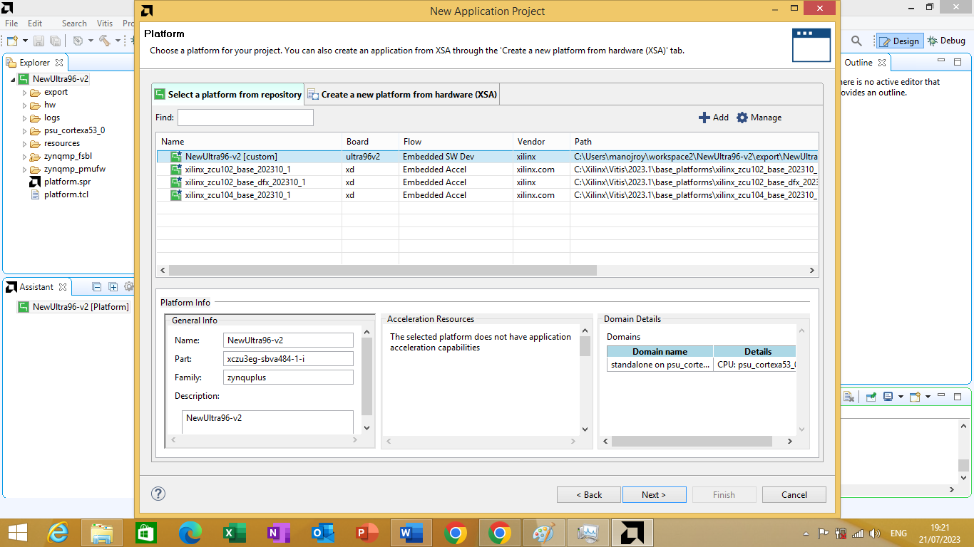

This opens a window to create a new application project as shown in figure 3.19 bellow.
Figure 3.19
click next a platform window will open to select the desired platform. We will select the custom platform that we have created for ultra96v2 board as shown in figure 3.20 bellow
Figure 3.20
After clicking next an Application Project Details window will open. On the application project name text box we will mention the project name we desired as shown in figure 3.21 bellow
Figure 3.21
After clicking next a domain window will open the is no changes that needs to be made in domain window. We will click next A template window will open we will choose 'Hello World' template as shown in figure 3.22 bellow.

we will click finish after choosing the hello world template. You can see the new Application project appear in the "Explorer" window on the left side. As shown in figure 3.23 bellow
Figure 3.23
To build the Application, first make sure we have the Application Project selected at top level then click Project -> Build Project as shown in figure 3.24 bellow
Figure 3.24

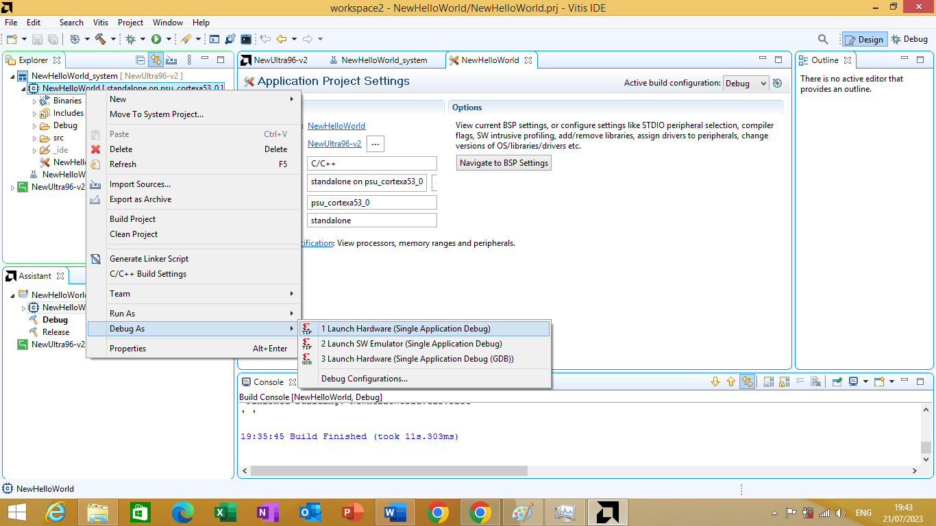

Now, we can launch the application in Debug mode by right clicking our application's name in Explorer window -> Debug As -> Launch Hardware. As shown in figure 3.25 bellow.
Figure 3.25
After launching the application on hardware. we will test the application. To test the application you need to click on 'Vitis Serial Terminal' window as shown in figure 3.26 bellow
Figure 3.26
On it click on + sign to open serial terminal setting as shown in figure 3.27 bellow.
Figure 3.27
After clicking on it Serial terminal port setting window will open as shown in Figure 3.28 bellow. On it set port as Com4, Data bit 8, Stop bit 1, parity none, flow control none than press on
Figure 3.28
After clicking ok The Vitis Serial Console should display a message "Connected to COM4 at 115200" as shown in figure 3.29 bellow
Figure 3.29

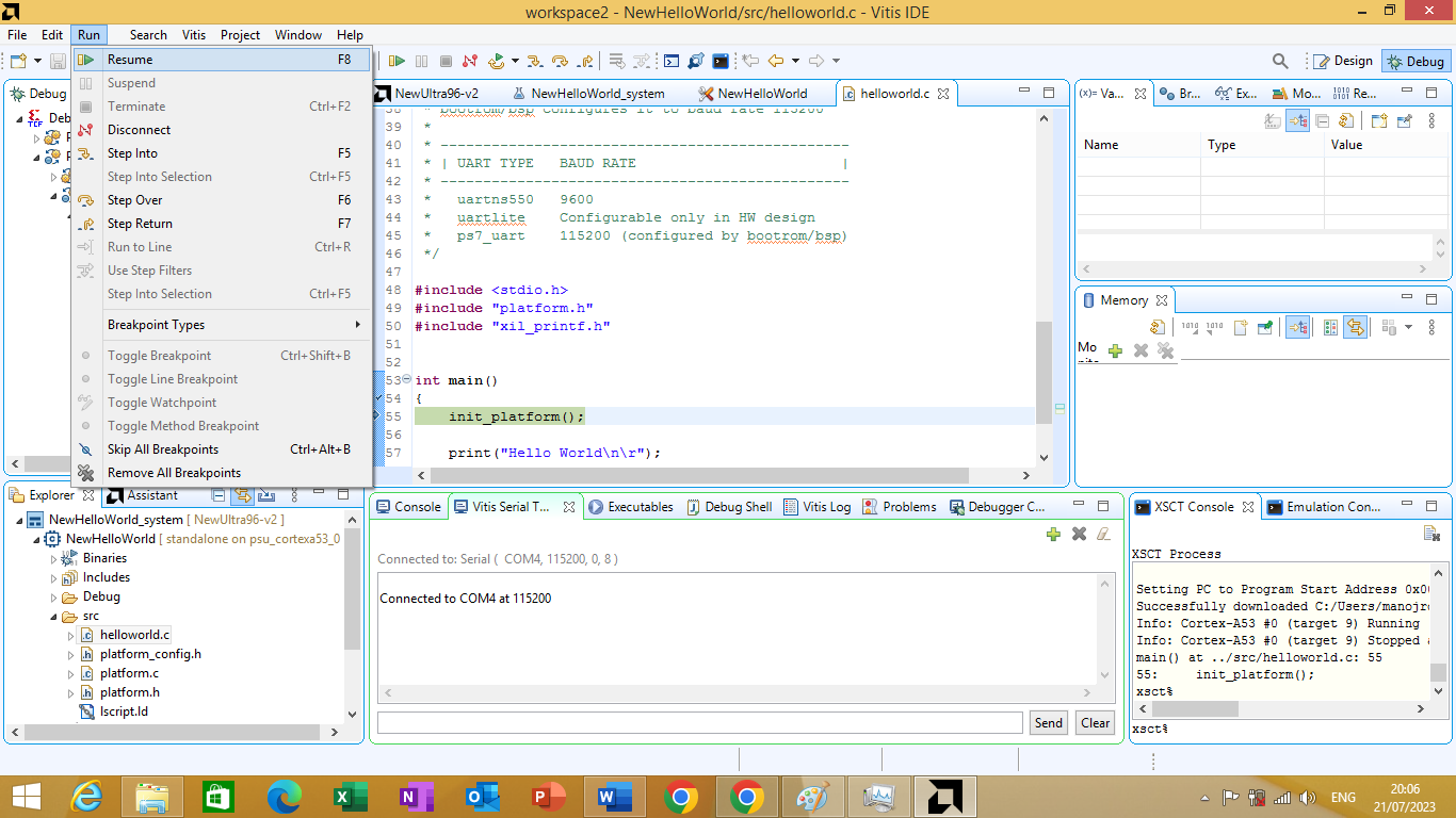

Now, you can proceed with executing the application by clicking on Run -> Resume in the Vitis window. As shown in figure 3.30 bellow
Figure 3.30
After resuming the application we will se our message in Vitis Serial terminal window as shown in figure 3.31 bellow
Figure 3.31
