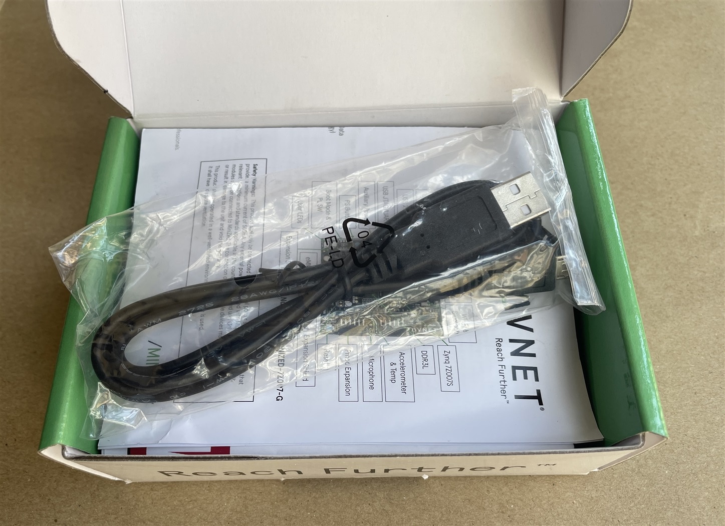

The second iteration completed. Still, MiniZed is not visible. Rather I can see a micro USB cable with some paper manual.

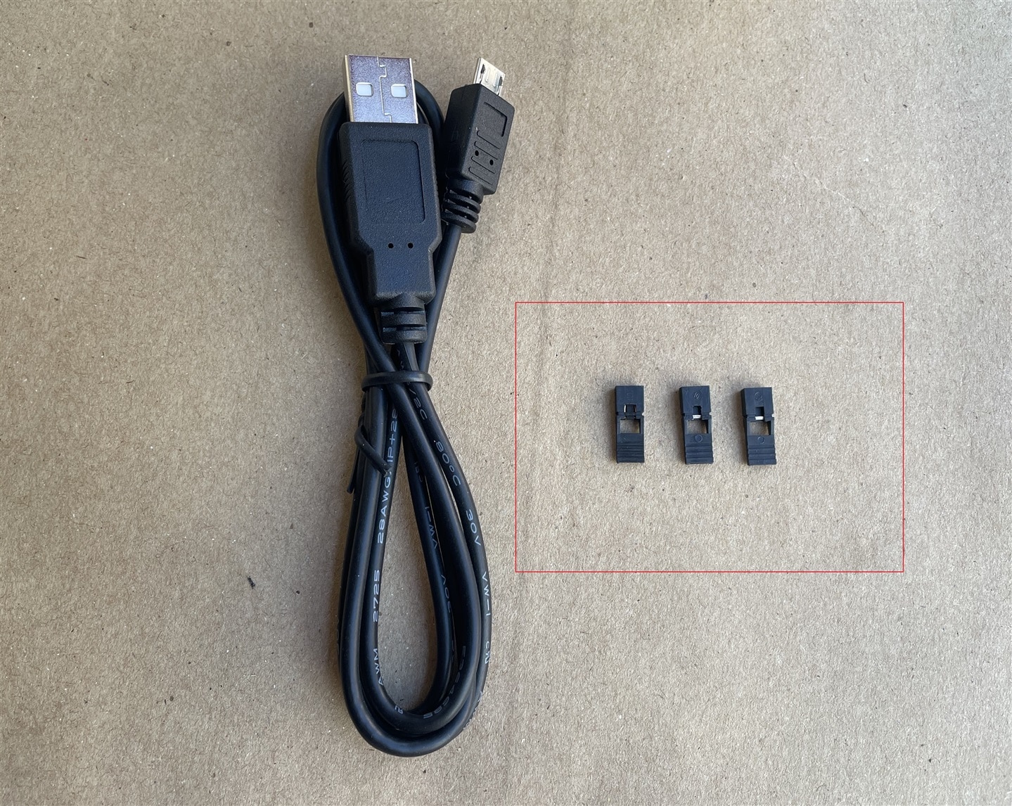

After entering inside of the packet of the micro USB cable I discovered three jumpers. I am not sure yet where I will use those. The micro USB cable is 1 meter long. More than enough for using with laptop. But you may need to use extension cable if you use desktop and the CPU is under the table like me.
The third iteration is done. All the treasures are shown in the photo.
