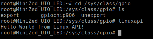

1. A simple user API to let Petalinux print out a Hello World string after MiniZed booting up
     The basic procedure to create a Petalinux is similar to Blog 3.
Step 01: Create a Petalinux project
$ petalinux-create --force --type project --template zynq --name MiniZed_UIO_LED
Step 02: Configure Vivado/Petalinux hardware
$ petalinux-config --get-hw-description=../

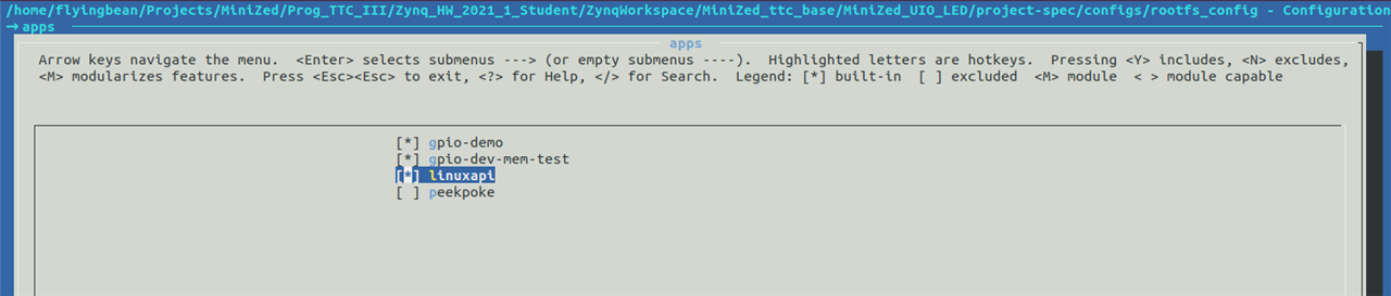

Step 03: Create User API
$ petalinux-create -t apps --name linuxapi
Configure rootfs
$ petalinux-config -c rootfs
Petalinux GUI will let us to select linuxapi app into user space as below.
Fig 3. Petatlinux Rootfs: apps configuration
Step 04: Build Petalinux Images
$ petalinux-build
After generating booting image artifacts, I am able to boot MiniZed from JTAG port as my blog 3 instructed. Here is the snapshot to get a Hello World API running on Petalinux.
Fig 4. Hello World Linux API Working

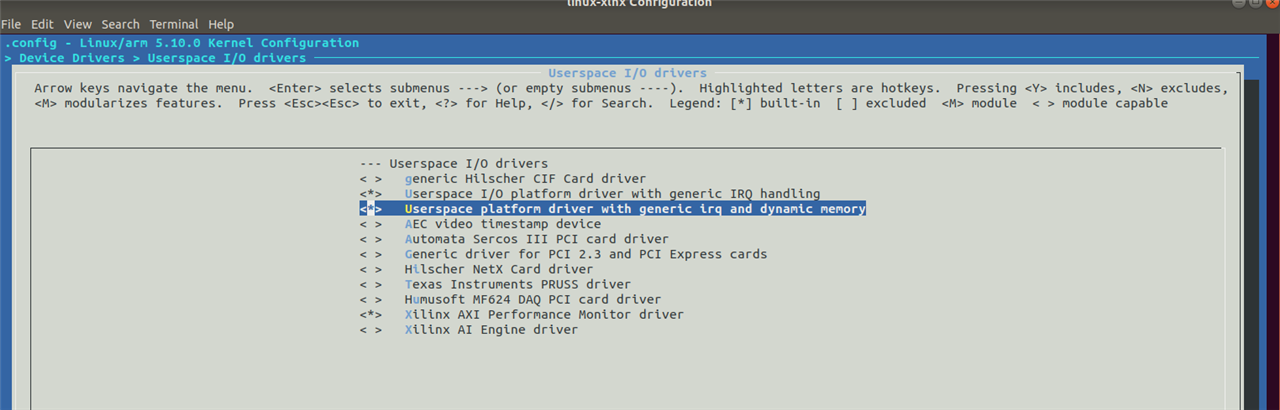

Step 3: Configure kernel
$ petalinux-config -c kernel
I did select GPIO UIO setting as below, which should mount GPIO UIO at MiniZed initial booting phase.
Fig 5. GPIO UIO Rootfs Configuration

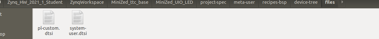

Step 5: Update device tree
I need to update system-usr.dtsi for gpio UIO node. The file can be found from the hiercharch as below.
Fig 6. Hierarchy Location of system-user.dtsi
Here is the snippet of the updated device tree.
/include/ "system-conf.dtsi"
 chosen {
		bootargs = "earlycon consol=ttyPS0,115200 earlyprintk clk_ignore_unused uio_pdrv_genirg.of_id=generic-uio";
		stdout-path = "serial0:115200n8";
 &amba {
    	ptm@f889d000 {
    		cpu = <&cpu0>;
&PWM_w_Int_0 {
        compatible = "generic-uio";
        status = "okay";
Step 6: Configure rootfs
After Petalinux GUI pop up, selet app: gpio-dev-mem-test,  as Fig 3 shew.

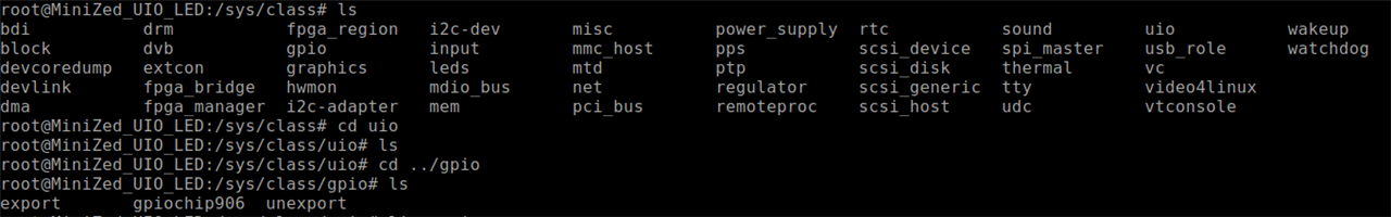

Step 7: Build Petalinux Image and test APIs
$ petalinux-build
After using JTAG to load the Petalinux images into MiniZed, I cannot find UIO populated under /sys/class/uio.
Fig 7. No PL GPIO Node Populated on MiniZed
I can only find gpiochip906 under /sys/class/gpio, which is PS GPIO for PS LED.
My very first GPIO UIO API on MiniZed was failed for now.
Conclusions
I learned how to use Petalinux to create a simple Linux version, Hello World API, which can be called at user space. However, I was not able to create a UIO API to call PL GPIO at user space. I think the root cause was the kernel configuration, which was not properly implemented. Vivado HW design should be fine since baremetal API was successfully running on MiniZed. I do need some advises from our community to fix the issues.
