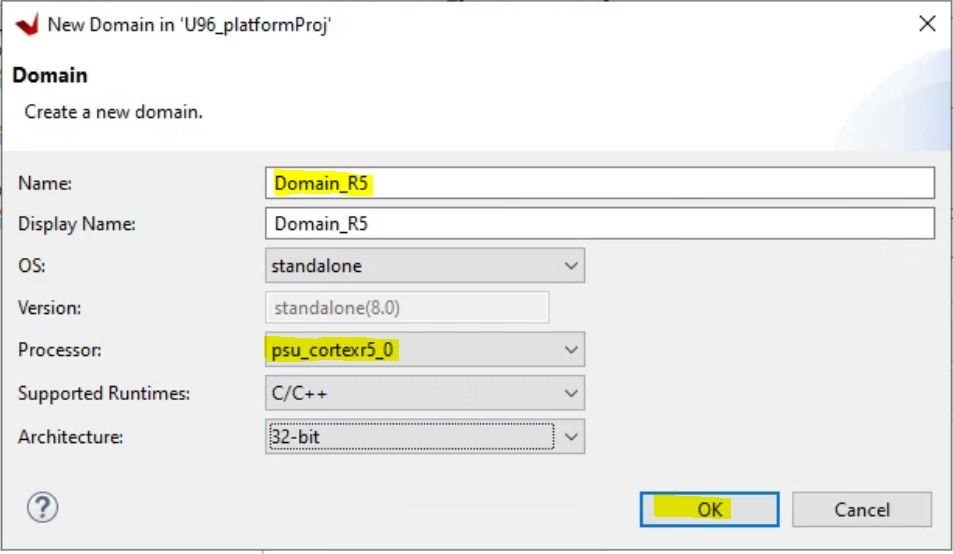

Inside VITIS, in the platform project explorer window, click the green "+" (Add Domain) button to add a new domain.
Then we fill in an appropriate name and select "psu_cortexr5_0" (First out of the two cortex r5 cores) as our target processor core. Then press Ok to create this domain.
VITIS will take a few seconds to create and add this domain, and now we can see it under the platform.

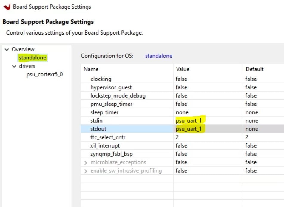

For this new platform also, let's set UART1 as the stdin and stdout. Select the "Board Support Package" under the psu_cortexr5_0 processor and click "Modify BSP settings"
Now we can fix the stdin and stdout settings as in image below. Then press OK to close.

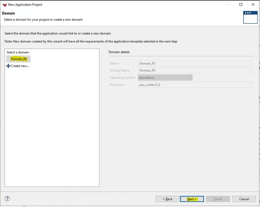

We select the same platform project that we create earlier. This time, we can see the R5 domain under "Domain details". Press Next to continue.

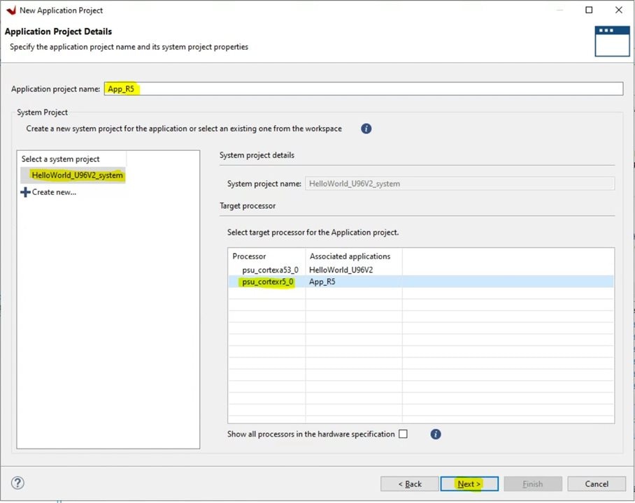

Give an appropriate name to our app that is going to run on the R5.
Select the previously created system project, and click the psu_cortexr5_0 as the target processor. The new app's name will appear in front. We also see the name of our previously created app for A53 in front of the psu_cortexa53_0 processor. Click Next to proceed.
VITIS automatically selects the correct domain for this. Press Next.
Select the Hello World template and click Finish.

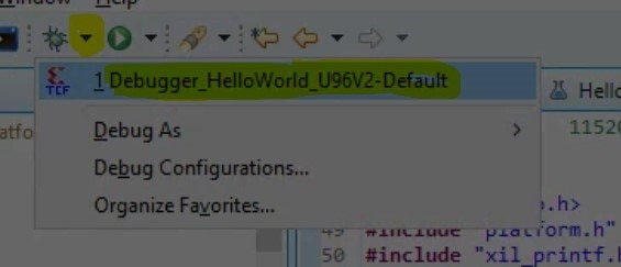

To launch the two applications, we can modify the build configuration we created previously when we launched the A53 application.
Click the drop down arrow next to the Debug icon and click "Debug configurations"
This opens up the Debug Configurations window.

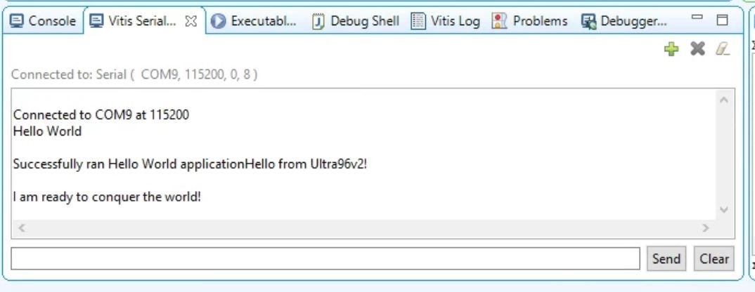

At this point, you should have the board powered up and connected via USB-JTAG just like we did in the previous blog post before launching the application. Also make sure the Vitis Serial terminal is connected to the UART com port.
VITIS will load the FPGA configuration and both applications, and execute them both.
In the serial console, we should see two hello world messages. You may recognize one of them as the custom message we wrote in the A53 application in the previous blog post. The other one is the default Hello world message from the application running on the R5.
