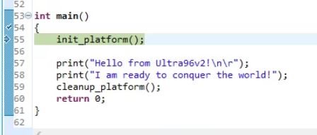

Expand the "src" folder under our new Application project and double click the "HelloWorld.c" file. This opens the source code file in the main window.
I am going to edit edit the "print" statements to something different.
Now we can save the file by clicking the "Save All" button.

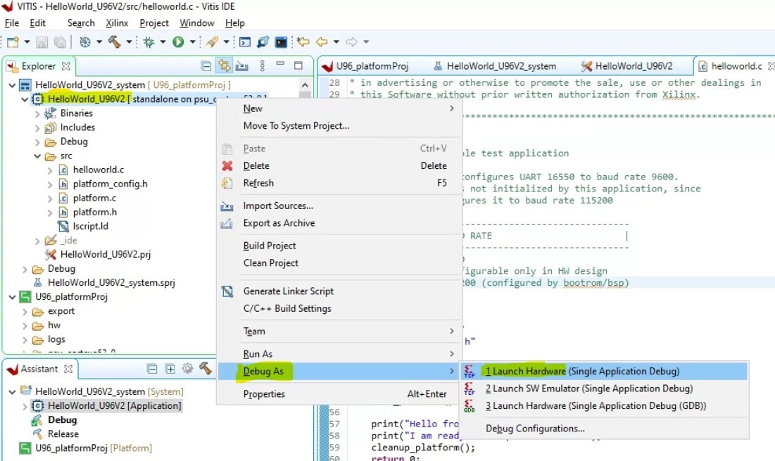

Now, we can launch the application in Debug mode by right clicking our application's name in Explorer window -> Debug As -> Launch Hardware.
This will switch Vitis to the "Debug" perspective. In the bottom right of the Vitis window, you will see the status of the application being launched.
You can also monitor the exact status of this launch process in the "XSCT Console" tab.
Once the application is finished launching, it will "break" at a default breakpoint on the first line (you don't have to add this breakpoint yourself).

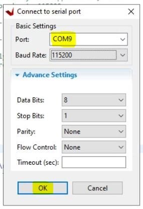

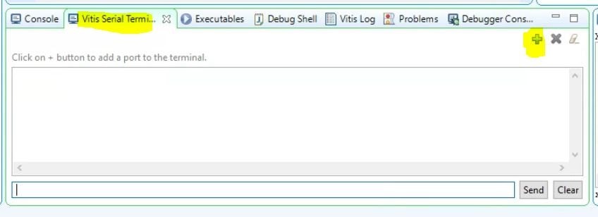

The debug process is basically awaiting your GO for proceeding with code execution. Remember we are expecting the application to print something to the UART console? Well, we need to connect a Serial Terminal to the UART console to be able to receive the message. While this can be done using any serial console application, one of the easiest ways is to use the "Vitis Serial Terminal" which appears automatically the Debug perspective is launched in VITIS. To connect with the JTAG port's UART console (which is connected to the Ultra96v2's ps_uart1), click the "+" button in the Vitis Serial Terminal window.
This opens up a Dialog box. Choose the correct serial port for your machine (you can use the Windows Device Manager if you're using Windows). Other settings can be left to default and press OK.

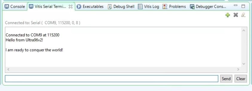

The Vitis Serial Console should display a message "Connected to COMX at 115200" where X is the COM port number in your case.
Now, you can proceed with executing our application by hitting the F8 button, or clicking Run -> Resume in the Vitis window.
We see our message appear in the window.
Mission success!
Congratulations, you have now compiled your first application for the Ultra96v2. Next up...Conquer the world!
