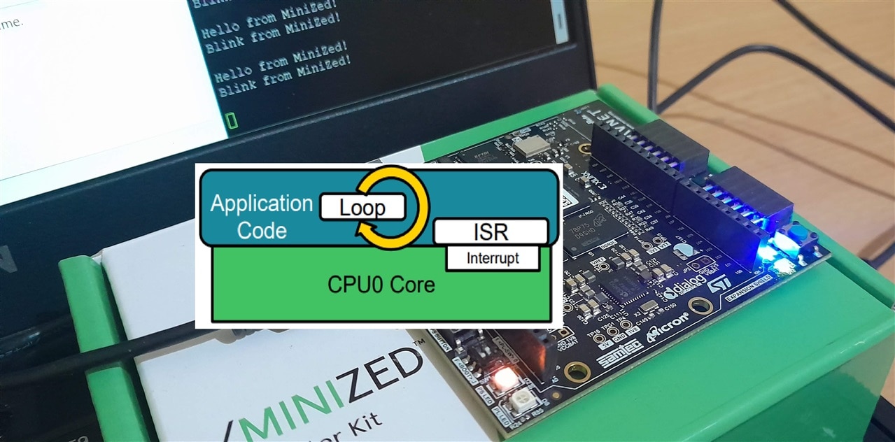

Flowing through the MiniZed tutorial track (+) MiniZed Software Technical Training 2021.1- element14 Community, I hit across the interrupts section. This quite caught my interest and thought of exploring further and building some instances. Real-time computing often requires interrupts to respond quickly to events and the ZYNQ SoC offers both hardware and software interrupts which we'll explore with examples further.
 Minized interrupt cover image
Enough saying interrupt! What's it actually?
Interrupts are a type of exception for the processor which tries to gain its attention out of the routine task it is continuously running. The processor has the privilege to always prioritizing the interrupt based on its type and as defined by the user. Another way around is for the processor to continuously check by itself at a regular interval if there are any occurrences of an exception in the system. This is polling and is probably used if the system can't control its rush!
The Zynq SoC uses a Generic Interrupt Controller (GIC) to process interrupts. The GIC handles interrupts from the following sources:
  • Software-generated interrupts – There are 16 such interrupts for each processor. They can interrupt one or both of the Zynq SoC’s ARM® Cortex-A9 processor cores.
  • Shared peripheral interrupts – Numbering 60 in total, these interrupts can come from the I/O peripherals, or to and from the programmable logic (PL) side of the device.
  • Private peripheral interrupts – The five interrupts in this category are private to each CPU—for example CPU timer, CPU watchdog timer and dedicated PL-to-CPU interrupt #.
