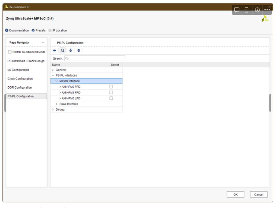

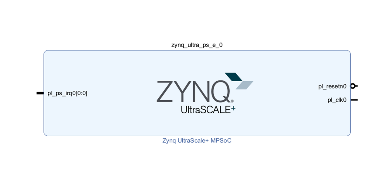

The block design is a very very simple with just a Zynq UltraScale+ block as shown below. We then can double click to customize it and uncheck of the HPM interfaces under PS-PL Interface as we won’t be needing those.
We can then generate the hardware and include bitstream in it as that is all we need from Vivado.
