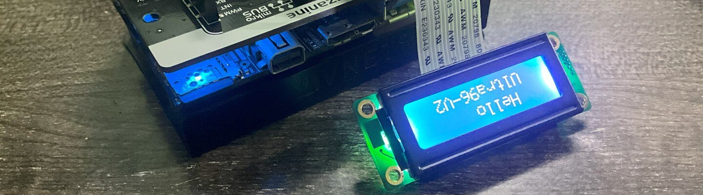

Welcome to blog 5 for the Ultra96-V2 development board. In this blog, we'll dive into interfacing an LCD Click board with the Ultra96-V2, allowing you to display information, messages, or graphics on an LCD screen. Let's get started!
LCD mini click displays 2x16 monochrome characters on an LMB162XFW LCD display. It features the MCP23S17 port expander and the MCP4161 digital potentiometer, both from Microchip. LCD mini click is designed to communicate with both 3.3V or 5V capable MCUs. The logic voltage level selection is done by the PWR SEL onboard SMD jumper. The 5V rail from the mikroBUS is used directly for powering up the included LCD screen. The click board communicates with the target microcontroller over the SPI interface and the following pins on the mikroBUS line: PWM, INT, RST, AN.

Launch Vivado and open your existing project from the previous blogs. In the block diagram, add an AXI GPIO IP block to control the LCD Click board. Connect the AXI GPIO to the appropriate pins on the LCD Click board. Run "Generate Bitstream" and "Export Hardware" in Vivado.
Launch Xilinx Vitis and open your existing FPGA design project for the Ultra96-V2 board. If you haven't created a project yet, complete the necessary steps to create a new project and add your design files.

Ensure your Ultra96-V2 board is powered off. Connect the LCD Click board to the Click Mezzanine connector on the Ultra96-V2. Power on your Ultra96-V2 board.
We've successfully interfaced the LCD Click board with the Ultra96-V2 development board. Stay tuned for our final blog in this series, where we'll continue to explore exciting features and interfaces for the Ultra96-V2 board. Happy experimenting!
