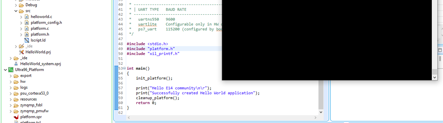

How let's create a new application project by selecting File → New → Application Project. Make sure that the ultra96_platform is selected. I've named the Application Project as “HelloWorld". Select Hello World from the Available Templates field. Click Finish.
{gallery}Creating Application Project on Vitis
Right-click on the HelloWorld Application and select Build. Right-click on the application and select Run As → Launch Hardware to program the FPGA.
{gallery}Programming FPGA
Connect the USB-to-UART cable to the JTAG UART connector on the Ultra96-V2 board. The other end of the cable should be connected to your computer.
Open a terminal or serial monitor program on your computer. Configure the settings to match the UART communication parameters set in your FPGA design. Once the FPGA design is running on the Ultra96-V2 board, your messages will be sent to the serial monitor. You should see the messages displayed on the terminal or serial monitor.
We have successfully implemented serial communication and printed messages from your FPGA design on the Ultra96-V2 board to a terminal or serial monitor. Feel free to experiment further by sending different messages and expanding the functionality of your FPGA design using the UART module.
