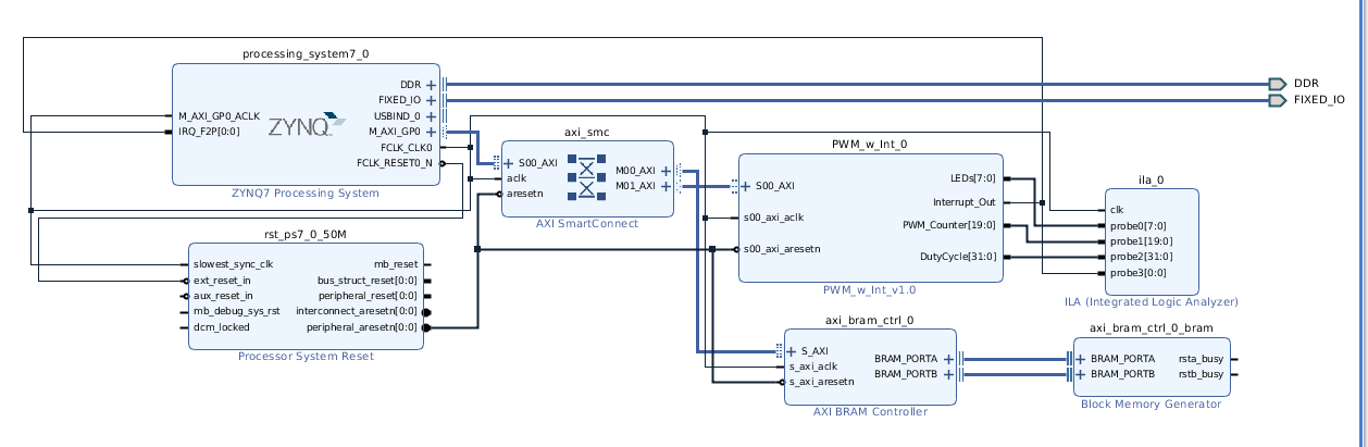

For Some Motivation about IP just see the below diagram of the Design I implemented in Vivado for working on PWM in Minized:image
As you can see , the Above Design consists of various blocks Such as "ZYNQ_7 Processing System" Block,"AXI Interconnect "Block,"PWM_w_int" block etc..
All these blocks are simply the IP blocks that i used in this Complex design which helped me to build a complex system/Design relatively easy for me within no time.

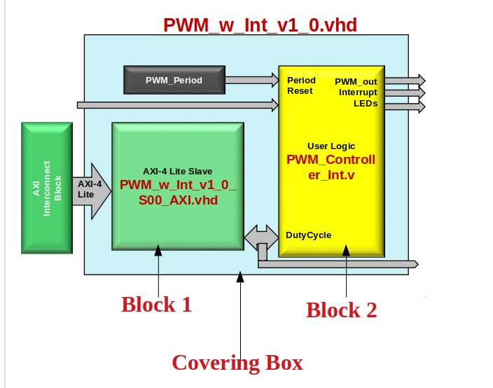

Below figure shows how the Actual PWM controller is Designed:
The Whole Design is broken into 3 Parts so that we can develop a complex design by just building the simple pars and join them Together by means of a Wrapper (the Covering Box) as shown above.
Here Block1 refers to desgin in "PWM_w_Int_v1_0.vhd" file in the attachments Archive , It is used to Interact with the AXI Interconnect Block to translate the AXI language from the AXI Interconnect block (shown Outside) to the Langauge Understood by the PWM Controller(Block 2 in yellow color).
The AXI Inter connect actually used to Connect multiple Master and Slave AXI Devices , and our Block1 works as a Slave Device , the Master we meant to be Interacting is the ZYNQ7 Processing System block as shown in the first figure in the Post.
The Block 2 is the Heart of the design , it is the PWM controller Design written in "PWM_Controller_Int.v" file , it takes the required Input regarding what should be the Duty Cycle , Time Period and Gives the PWM(Pulse Width Modulated Output) , Interrupt the PS .
The Covering Box is nothing but the Wrapper file , which creates the Instances of Block1 and Block2 from the HDL files and Map the Input and Output Ports among Them and to the Outer World as shown in the Block diagram.

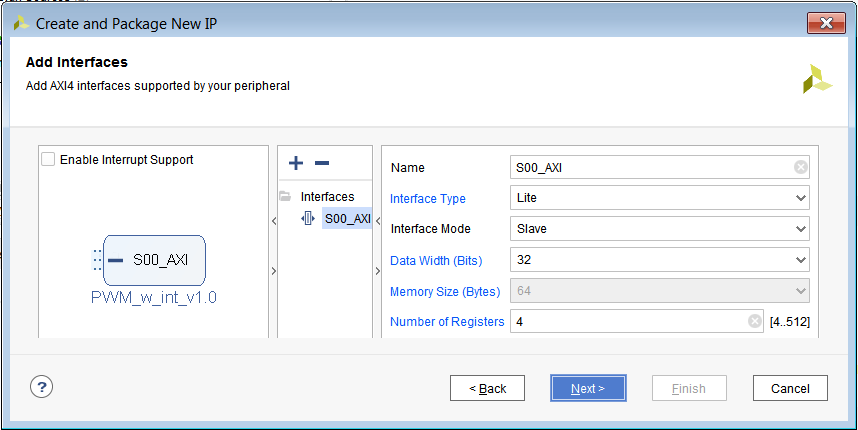

Note that Vivado is so powerful that it  Creates the required AXI slave - Block1 and the Wrapper by opting for it when creating a new IP , through
1.)Open Vivado  -> 2.) Tools ->3.) Create and Package new IP -> 4.)Next -> 5.)Select Create New AXI4 Peripheral -> 6.)Type IP name (For Eg:"PWM_Controller_Int.v"  for my case)  and Some Description about it , & Select required Path Directory -> 7.)This is the Important thing to Note: It is Mainly Based on your Application/Design , In my case i used below values
But if the Design require large Data Registers select the Appropriate AXI options.
->8.)Next ->9.)Add IP to Repository / Go for Edit as it needed to be. ->10.)Finish

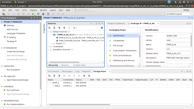

In Order to Open IP to Edit , you can Do so by : ->1.) Select Window tab on the Top ->2.)Select IP Catalog ->3.)Type the Name of your IP ->4.)Right Click On it ->Select Edit in IP packages
Give the Editing Profile a name and Location where you would like to save those Settings/Temporary data while Editing your IP
This is the Screenshot of my IP Manager:
As you can see i already added the Design files under my IP wrapper file , but i am joking , Vivado automatically parses the Design files based on the Component Instantiations used in the Wrapper file,it adds those Designs files under it.
So if you are writing a new IP, Don't Forget to Instantiate your Each Design Block in your IP as a component in the Wrapper file and port map it (giving port names/Connecting to Already Existed/Created Ports in the Blocks).

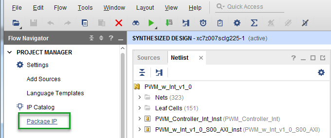

After Integrating all the Design files under the Wrapper Run the Synthesis to Generate the Synthesized Design.
After Successfully Synthesizing your Design , you can Package the IP: By Going for "Package IP" as shown below after synthesizing the Design

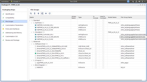

3.)For the Proper Functionality(Both Simulation 7 Synthesis) of your Design in the Standard way , you include the Design files in Simulation and Synthesis file groups , if not present already Press '+' icon to Create the File Group
For Instance My file Groups are as Follows:
The Drivers and Other are generated Automatically based on your Design files.
