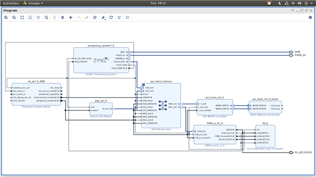

In the Next Post , I will show the Debugging Routes we will trace : For these functionalities we have added Integrated Logic Analyzer Core and JTAG to AXI master cores in our Block Design , I will Clear how these work in the Next post.
After Creating the Block Design with Our Custom IP added in Design this is no new Task for Us :

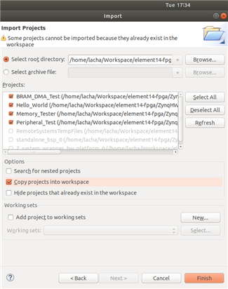

2.) Then Import the Previously created Applications(if required, In our Case - We added these files as shown in below Fig. for UART ,Running BRAM functionalities)
For Importing : Select File -> Import -> General -> Existing Projects into Workspace  -> Finish.

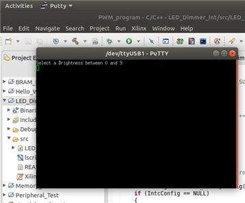

1.) First Listen to the Serial Port by Means of PUTTY or Teraterm by connecting to the Serial Port at 115200 baud rate
2.) In SDK, Right Click On "LED_Dimmer_Int" under Project Explorer and select Run As -> Launch on Hardware(System Debugger) .
3.) You should be seeing PUTTY or Teraterm Screen as Shown:
4.) On the Minized Board , Observe the "PL LED" by giving Input values from 0 to 9 in the Teraterm or Putty window
    Brightness of PL LED will increase by Increasing the Input value
