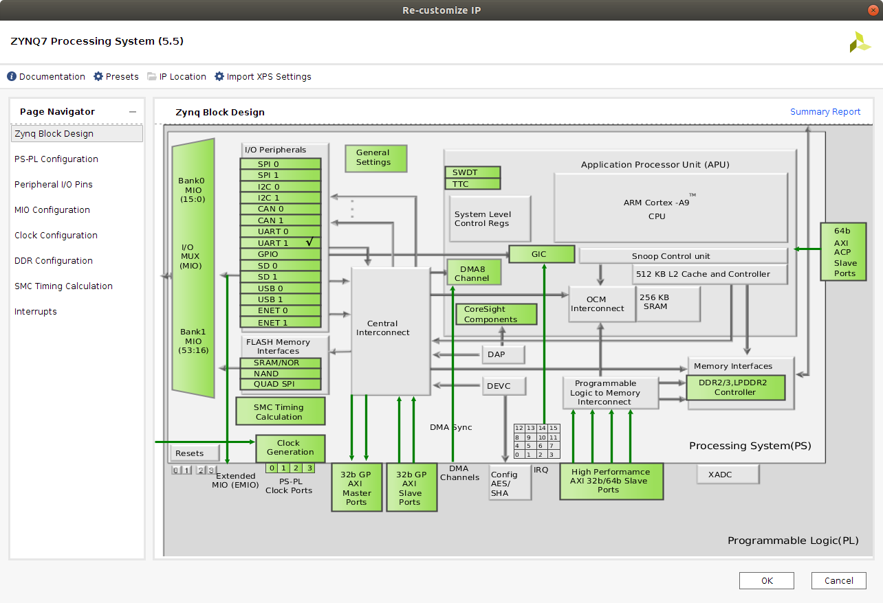

The first lab exercises mostly revolved around getting familiar with the vivado tools, as well a a customized version of Eclipse. We were brought into a Block Design configuration screen which allows us to connect peripherals in the ARM Cortex-A9 processor.If you look at the diagram below, you can see a check mark next to UART 1 in the green I/O Peripherals section:
This will, as expected, connect the UART 1 peripheral to the processor, allowing us to access it programmatically.
Once that connection is made, we can configure the memory and clocks for the device, validate the design, generate the HDL and export to the SDK, which is the Eclipse editor that is part of the tools installation.
